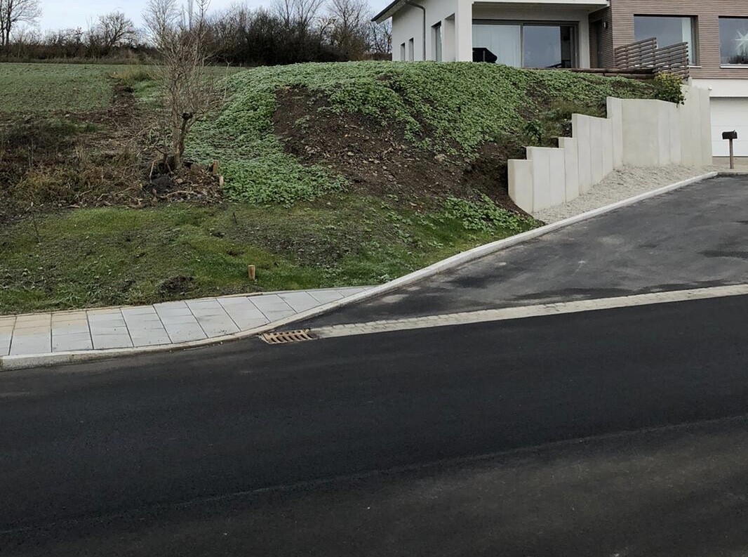

BauherrFranken3 Dec 2019 10:34The neighbor has basically solved it like this (I cropped the photo for privacy reasons). It’s actually not a bad solution. The house is then positioned relatively high up. I could imagine something similar for our own project. However, at the moment we don’t have any concrete ideas yet, as we have only just discovered the plot.
