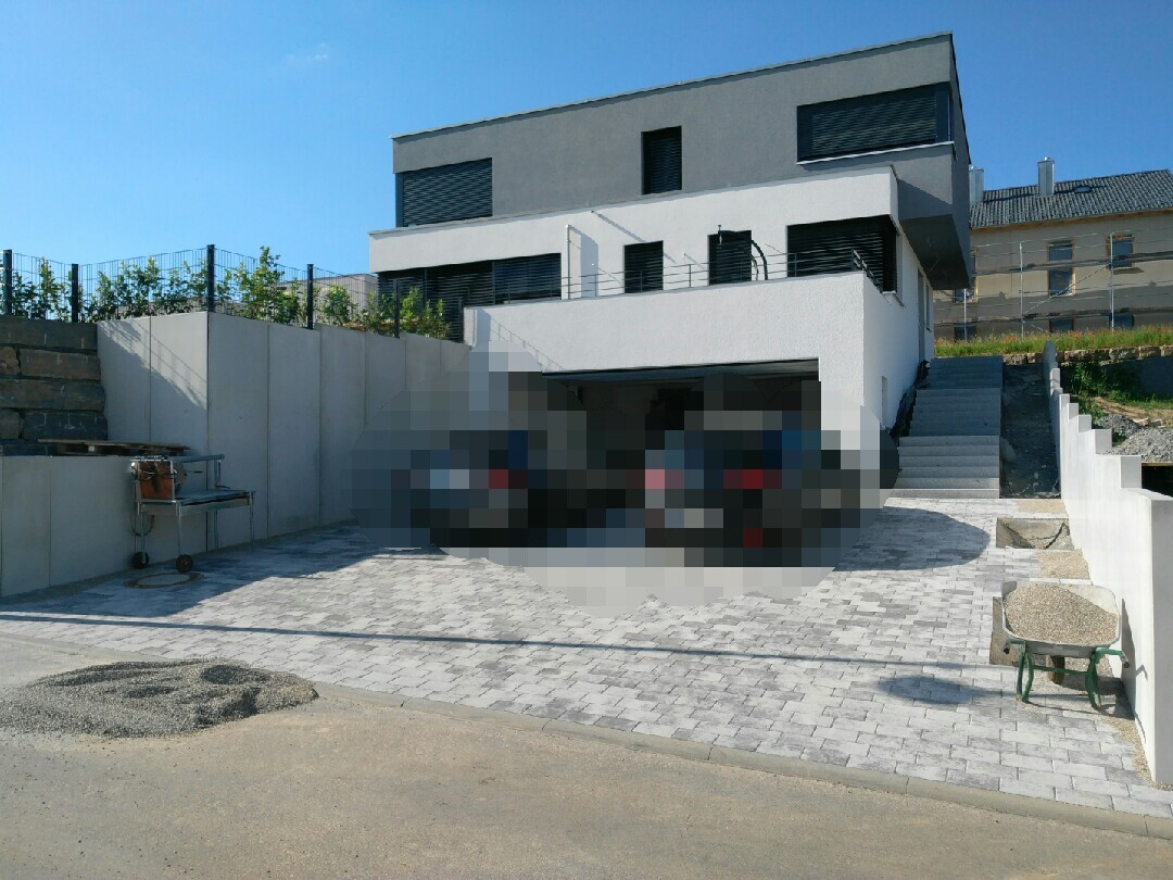

Take a look at our plan. We have the same plot type.
As a previous commenter suggested, we have also slightly integrated the garage into the basement and designed the roof as a terrace.
Costs for retaining walls and backfilling, or partly just sloping, are around 50,000.
The exterior stairs and so on are extra. So for the landscaping, you can expect 80,000 to 100,000, especially because the building envelope is located far back on the plot, resulting in a long driveway if the garage is in the basement.

Looks great! However, the costs mentioned are quite steep.

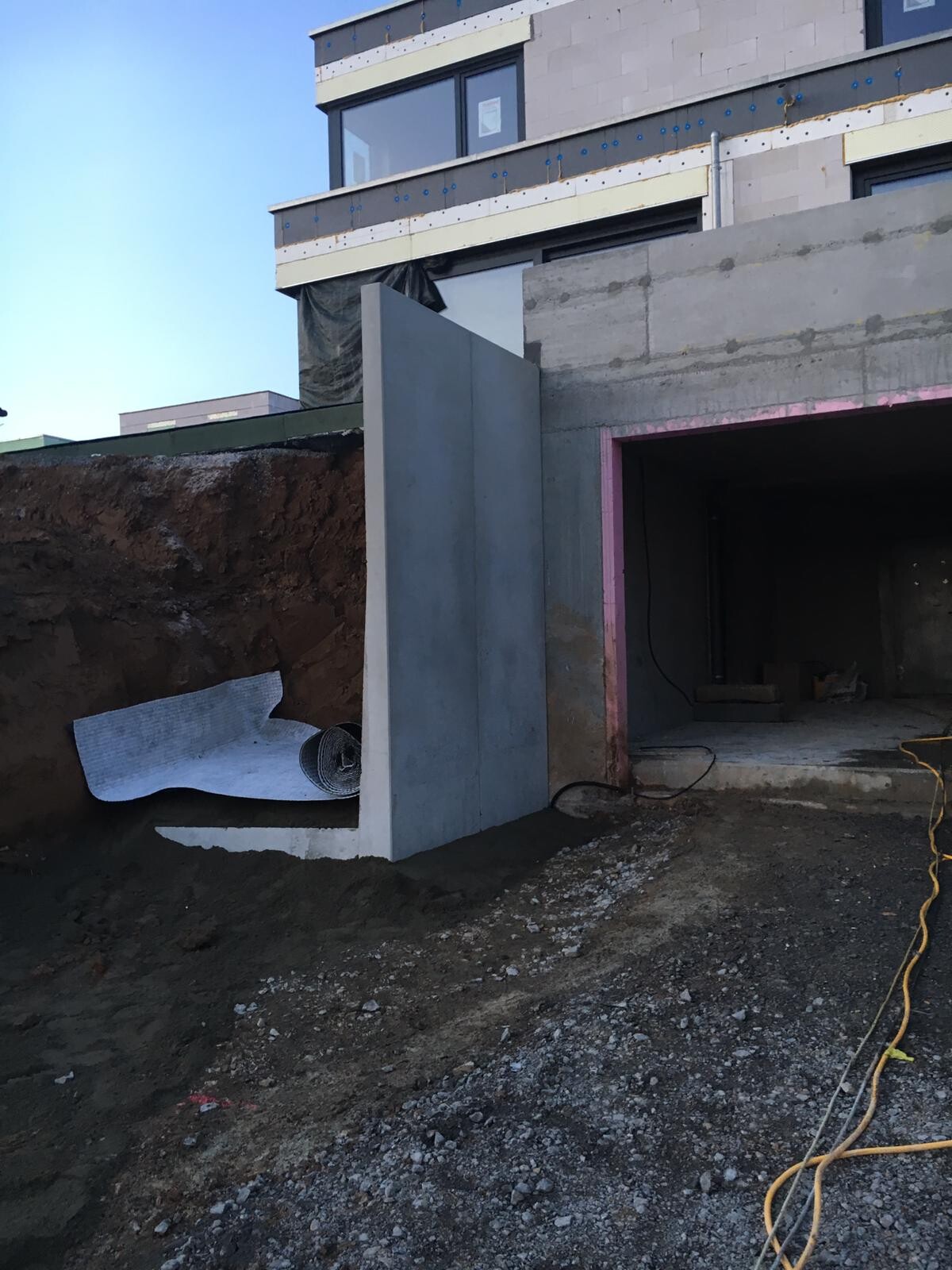

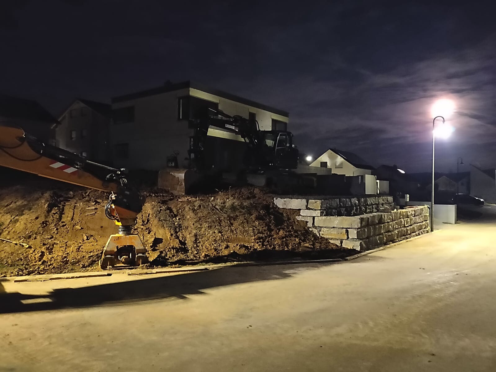

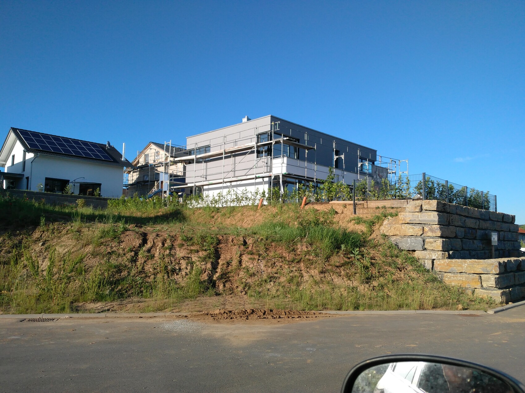

At the garage, Kronimus masonry panel / L-block 305cm (10 feet) long. Larger ones are not manufactured.
On the street side, we had to use natural stone due to planning permission / building regulations. My wife likes it, but I would have preferred to use masonry panels throughout.
Here are a few pictures from the construction process. Unfortunately, I don’t have any recent ones available.
