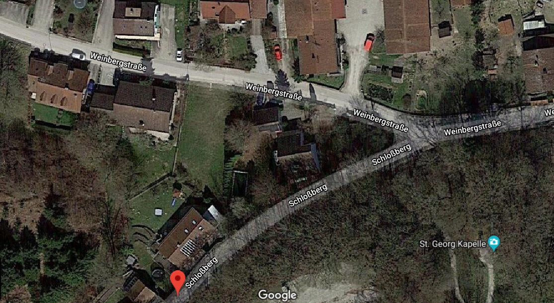

My partner and I have finally purchased a large plot of land measuring 437 sqm (4700 sq ft) in Munich-Eching, and we will soon be building our prefabricated single-family house with Streif Haus. The plan is for approximately 145 sqm (1560 sq ft) of living space with dimensions of 9.96 m x 8.71 m (32.7 ft x 28.6 ft). Increasing this is simply not possible within our budget—for example, adding 1 meter (3.3 ft) on one side would cost roughly an additional €30,000.
So far, I have created all the floor plans using a software tool. Last Friday, we had our first meeting with the architect. Unfortunately, he dismissed several of our wishes:

I have attached my plans for the ground floor and upper floor. Since the plot is not rectangular but rather irregularly shaped, positioning the house alone is a challenge because we naturally want the garden and the largest windows in the living room and kitchen to face south. In the attached site plan, the house is still positioned quite centrally (12 x 9 m / 39.4 x 29.5 ft). We will move it as far as possible to the right, towards the east.

The plot is large but irregular, making it challenging to position the house facing south while maintaining minimum setbacks.

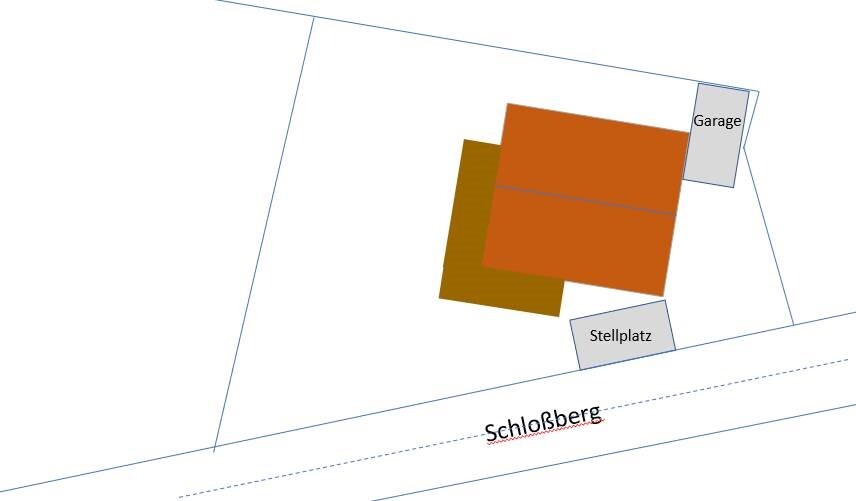

Okay, the positioning is really challenging. Rotating the house by 90 degrees (from 10 x 9 m [33 x 30 ft] to 9 x 10 m [30 x 33 ft]) was just an idea. If we keep the house facing south as shown in the drawing, we wouldn’t rotate it anymore but shift it as far to the right as possible.
The setback distance to the neighbors in Bavaria is always 3 meters (10 ft)? That also depends on the height of the house, right?
Then it really makes sense that on the right side (northeast) there is only a garage/carport next to the house and the second parking space is located elsewhere.
Would this be a practical solution regarding the garage and parking space, or would stacking them directly on top of each other be better if the building authority allows it?
The dimensions are, of course, not to scale as this was quickly sketched.
The architect is trying, after consulting with the potential new property owner (on the right), to eliminate the corner on the east side of the lot to create a straight line. This might help with the positioning.
Baufie schrieb:
The dashed line is the building envelope, right?
If the written zoning plan allows it, the garage or carport may also be built up to the property line.
You could also move the house slightly towards the northeast, closer to the garage. Exactly, the dashed line is the building envelope after complying with the setback requirements. The garage can be built directly on the property line, and the house can then be constructed right next to the garage.
jay2jay schrieb:
The measurements are obviously not to scale since they were sketched quickly.That’s exactly your problem. You’re completely overestimating the area. Well, I’m not going to explain it to you a hundred more times. Hopefully, once the correct measurements are available, you’ll realize the truth.jay2jay schrieb:
Would this be a practical solution regarding the garage and parking space [...]
The dimensions are, of course, not to scale as it was quickly sketched. Between "this looks feasible" and "the dimensions don’t match, there might be a causal connection," otherwise, I would generally agree with it.
In my assessment, this is now a subdivided plot where both neighbors have the same developer arrangement, so coordination through the developer is possible; and from the aerial image, it appears to be a moderately sloped terrain.
The most likely spot for a house seems to be the location marked on the site plan, where a house about 9 m deep and 11 m wide could be built. I recommend the original poster review the link I posted in comment #7 again, as we already covered the whole topic there. At the garage location mentioned in comment #27, I would prefer a carport; otherwise, that area next to the garage would become a neglected corner on the property.
