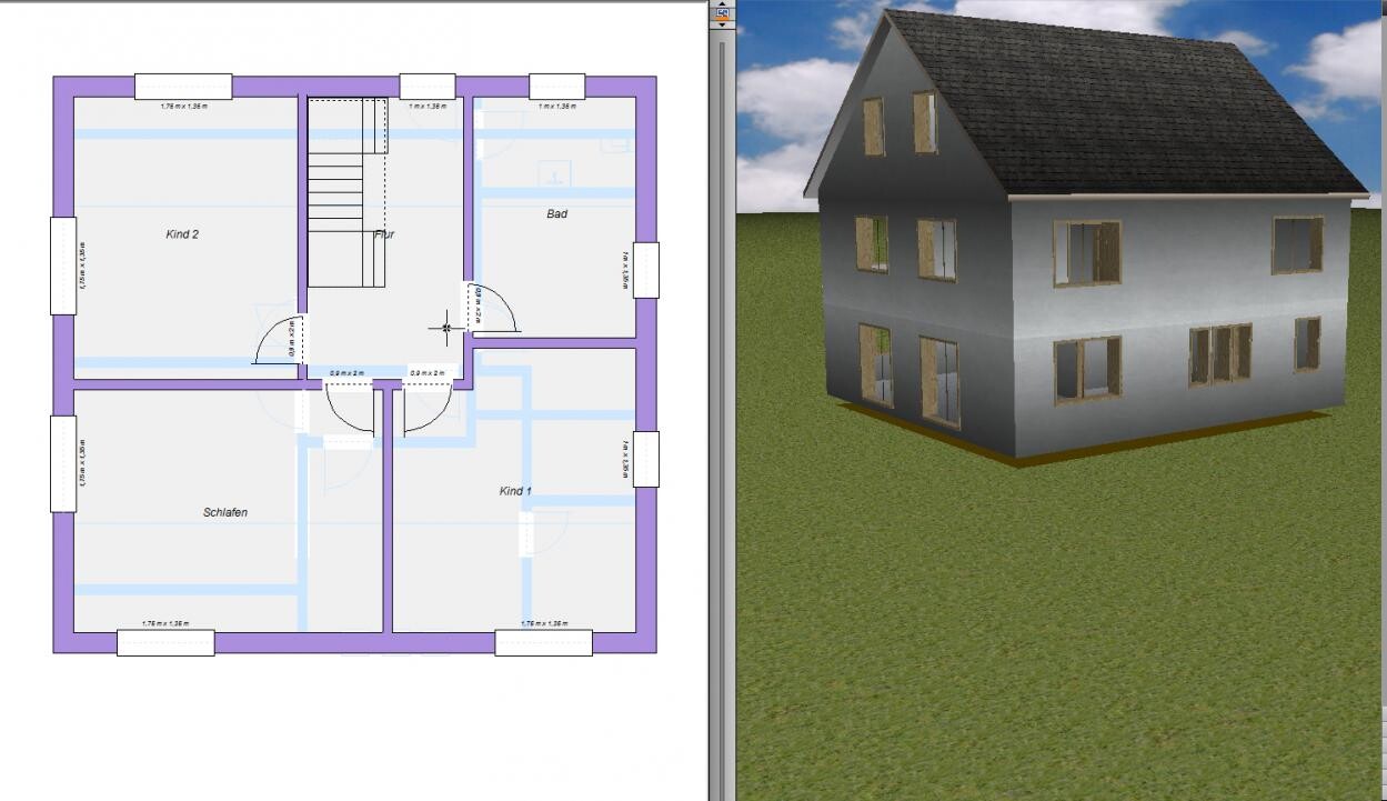

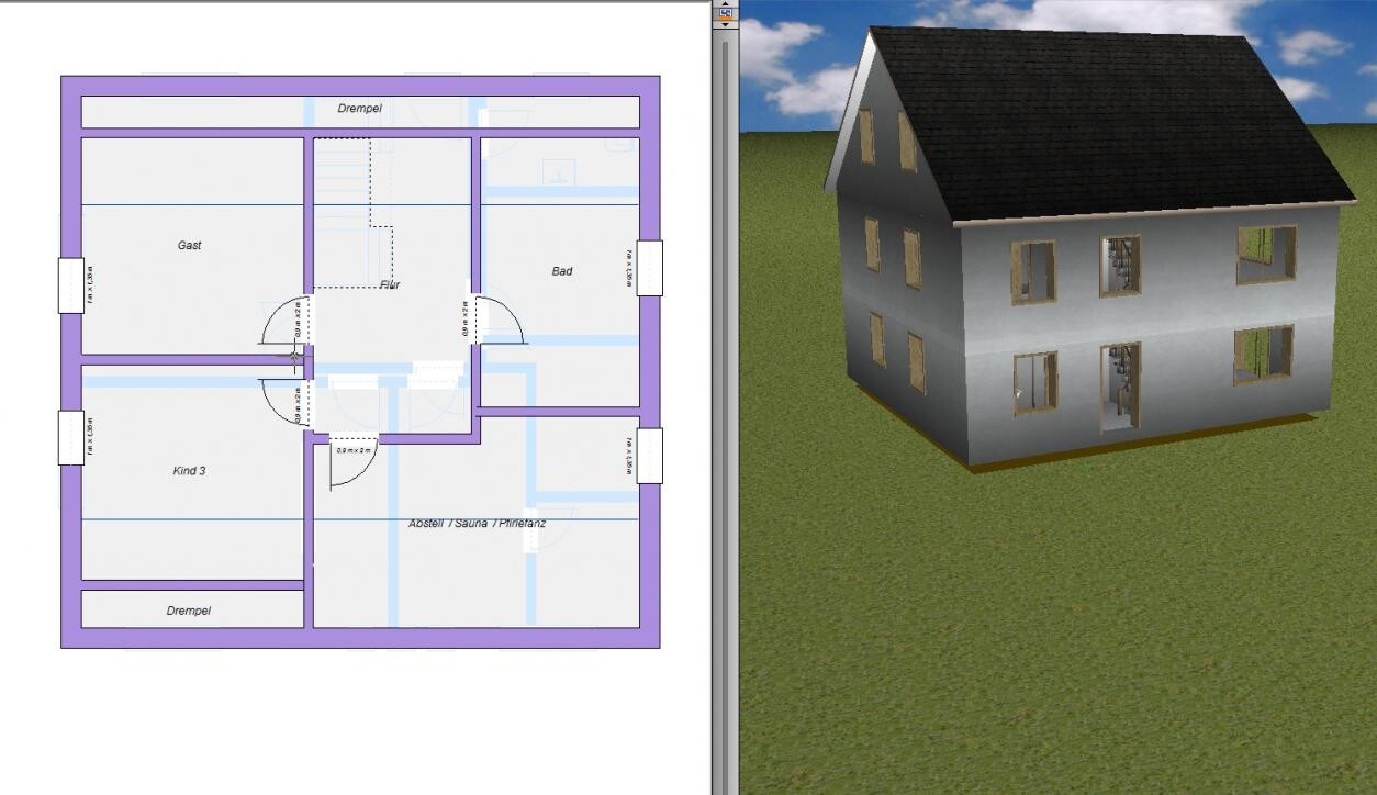

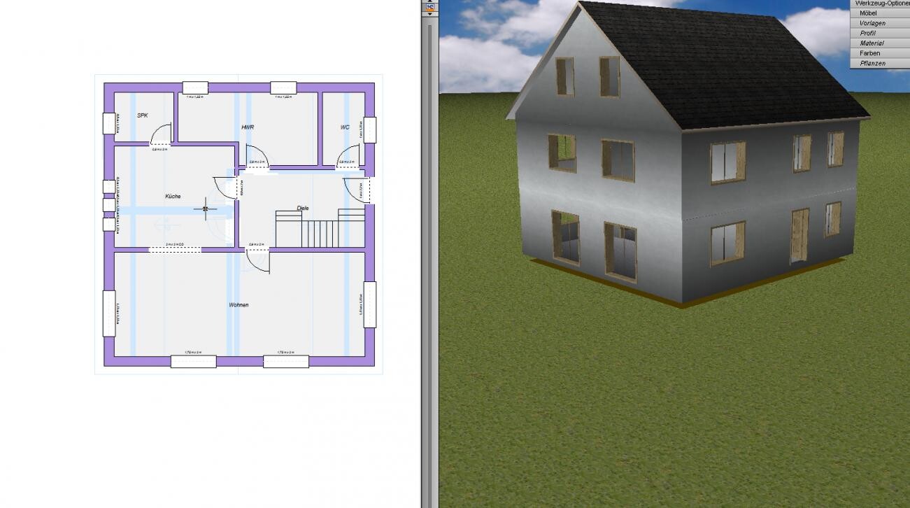

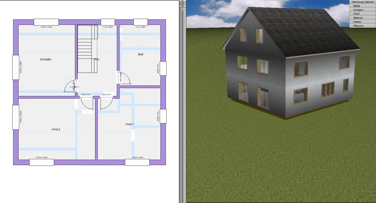

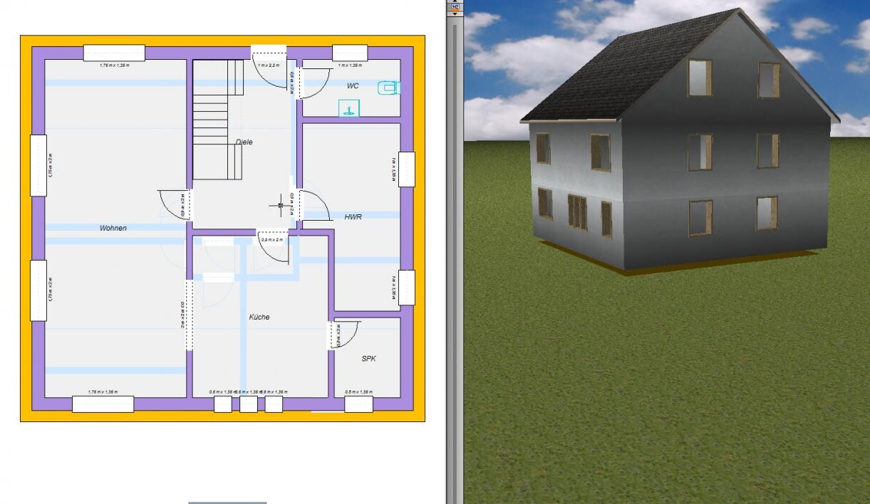

Hi,
here is a quickly drafted alternative for discussion. Directions and garage were ignored, the walk-in closet was removed. My main focus was on the staircase and the upper floor. The kitchen can of course be completely open as well. The indicated knee wall is quite small, but better than none at all.
The problem is the bedroom next to the children's rooms and the space for the wardrobes. The wall between Child 1 and the bathroom can still be moved, so there might even be room for a sauna.
Left floor plan, right 3D house rendering on green property.
Left floor plan with rooms, right 3D house design in garden.

milkie
10 Feb 2014 16:02
Overall, a nice design with potential for saving space. However, for us, an entrance on the north side is not an option.
If you rotate the design so that the entrance is on the east side and swap the dining area and kitchen (as this is also desired), you end up with almost the same ground floor layout again.
We will now try a slight repositioning of the staircase.
We are also considering swapping Child 2's room with the office. Perhaps the dressing room and office could then share some space. This would only be possible if there is enough space in the attic for both children with a bathroom. But this is just a thought for now.
