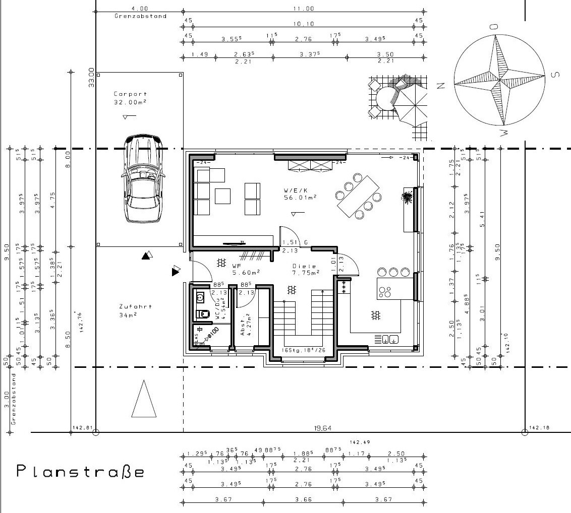

ᐅ Single-family house floor plan, approximately 150 sqm, with east-facing garden
Created on: 9 Jan 2020 21:17
O
OWLer

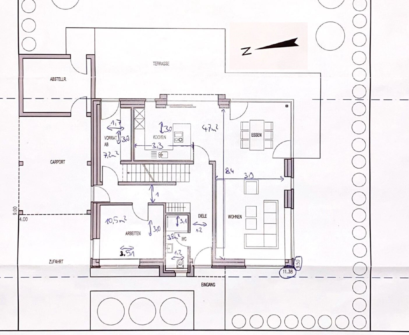

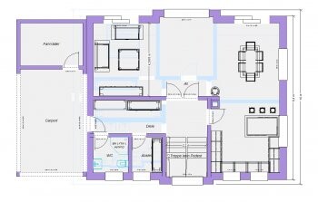

after reading many threads here about how well-intentioned floor plans are expertly dissected, I’m now stepping out from the shadows. We plan to build this year and have already purchased the plot. We are currently in discussions with two providers. Provider 1 never really impressed us with their designs and plans very large houses without offering much living space. I’m bringing Provider 2 into the discussion here because, apart from the points mentioned below, we still like their design.
We hope the collective forum expertise will point out some pitfalls and maybe even help solve our hallway dilemma.
Sorry for the rough sketches of the measurements.
Plot size: 610 sqm (648 with purchased noise barrier)
Slope: approx. 70cm (28 inches) over 19m (62 feet), sloping from north to south
Site coverage ratio: 0.4
Floor area ratio: 0.8
Building envelope, building line and boundary: 3m (10 feet) from the street, 3m (10 feet) to neighbors north/south, building envelope 10m (33 feet) east-west
Edge development
Number of parking spaces
Number of stories: 2
Roof type: gable roof ≤45°
Architectural style
Orientation: ridge running north-south
Maximum heights / limits: max. ridge height 10.5m (34 feet), eaves max. 6.0m (20 feet)
Other requirements: On the east side, a noise barrier is built along half of the plot, with forest behind it. Due to the noise barrier, the garden is practically not visible from outside.

We really like the upper floor. Room sizes fit well. We can’t really assess the master bedroom on the south side yet. The kids’ rooms seem the right size and have a good layout in my opinion.
A guest room was not a requirement – apparently there was space on the upper floor. We are not unhappy about that.
The living-dining area really appeals to me. Kitchen opening to the terrace. My wife likes the pantry options with access to the garden, basement, and carport.
What don’t you like? Why?
What we don’t like is the narrow corridors. I imagine 1.2m (4 feet) and 1m (3 feet) very cramped. Between the carport and along the stairs, this wouldn’t bother me so much, but the entrance definitely should be wider.
The master bedroom on the south side does not convince me much.
Price estimate according to architect/planner: >440k€
Personal price limit for the house, including fittings: approx. 440k€
Preferred heating system: gas heating required by the plot purchase contract.
If you had to give up something, which details / features could you do without:
I could do without the pantry and use that space for the WC instead. My wife, however, sees this differently.
Which features can you not give up:
The study on the ground floor is a must due to my teaching profession. The idea is to be able to drop things off in the study after returning from school, close the door, and have some downtime without needing to go upstairs or downstairs.
The basement is also essential. Many friends and acquaintances who have built in recent years do so mostly without basements. It takes iron discipline to keep utility rooms “tidy.” We manage that in our rental now but want to move away from that. We don’t want to become hoarders but want more space to spread out. Also, I want to be able to store all my tools in the basement and comfortably repair my bicycles.
Why was the design made the way it is?
Large windows on the ground floor facing the garden, as it is not directly visible.
A bay window on the street side is mandatory for the look. The planned flat-roof bay will definitely be changed to a pitched roof. The plaster on the bay will be replaced by brick cladding. We find the bay window to the garden quite nice. Not a must-have, but it was part of the planning basis we provided and, in my opinion, positively impacts the kids’ rooms.
What makes it particularly good or bad in your eyes?
How do you evaluate the usability of the pantry—does it work as well as we imagine it? What other ways, besides widening the house, do you see to widen the corridors? Does the indicated wardrobe area fit?
In principle, I would like to build it this way if only the narrow corridors weren’t an issue. Making the house 25-50cm (10-20 inches) wider is not technically feasible and probably financially difficult.

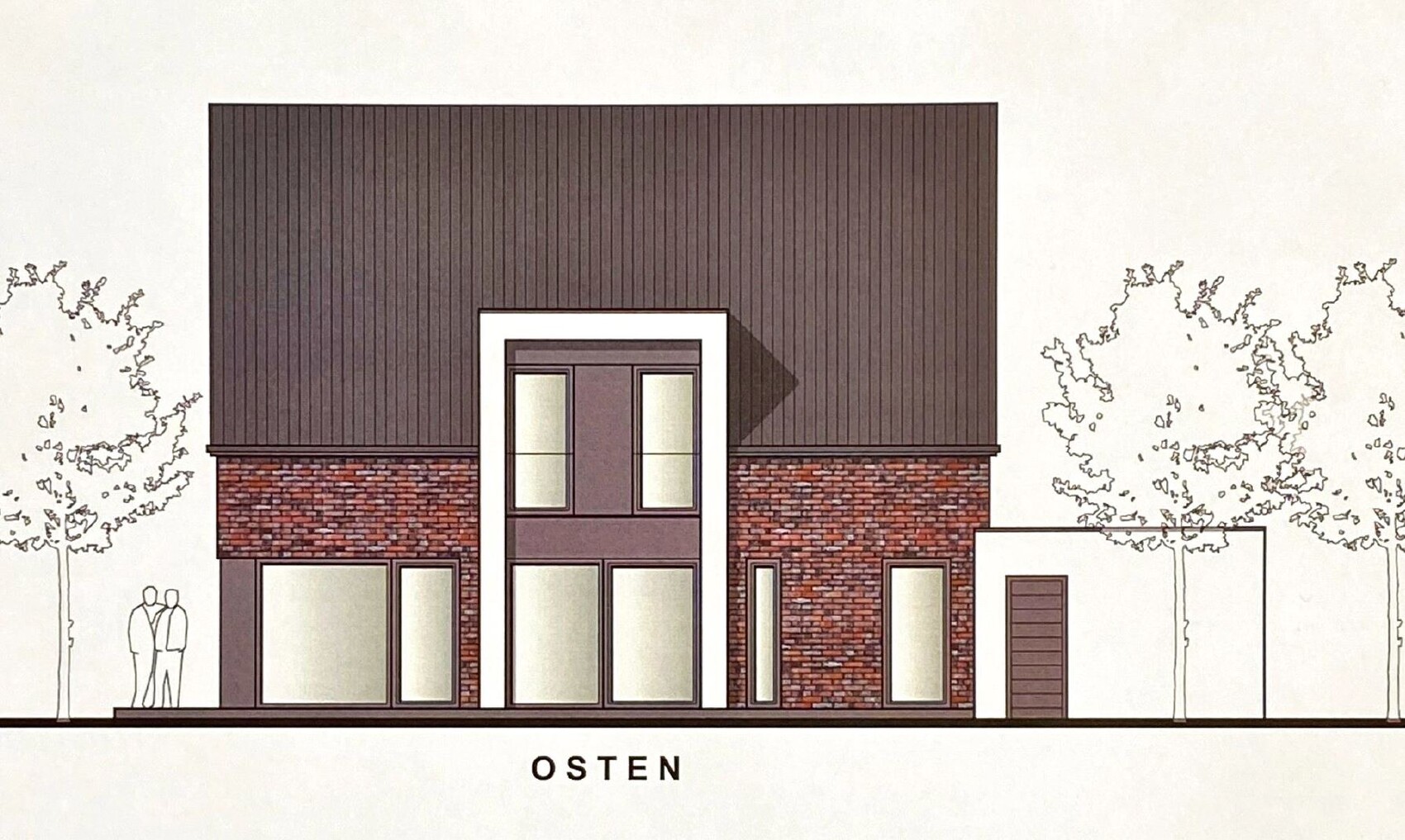

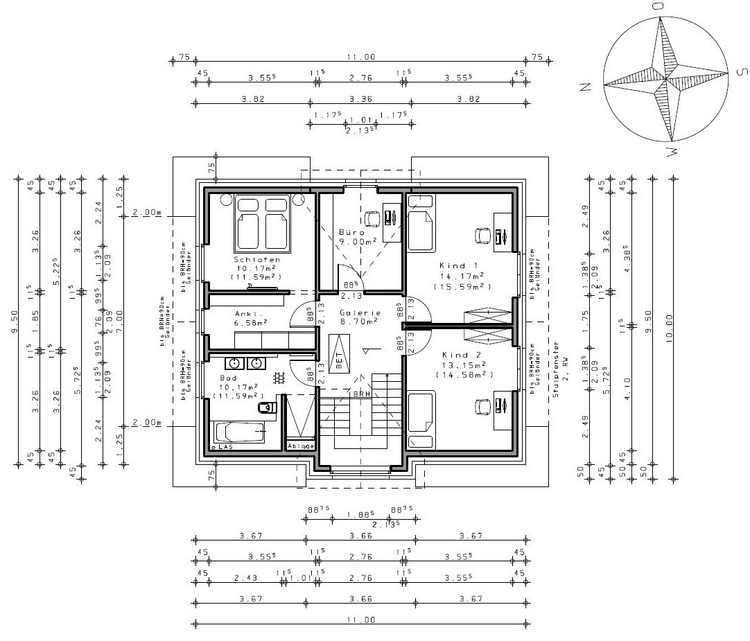

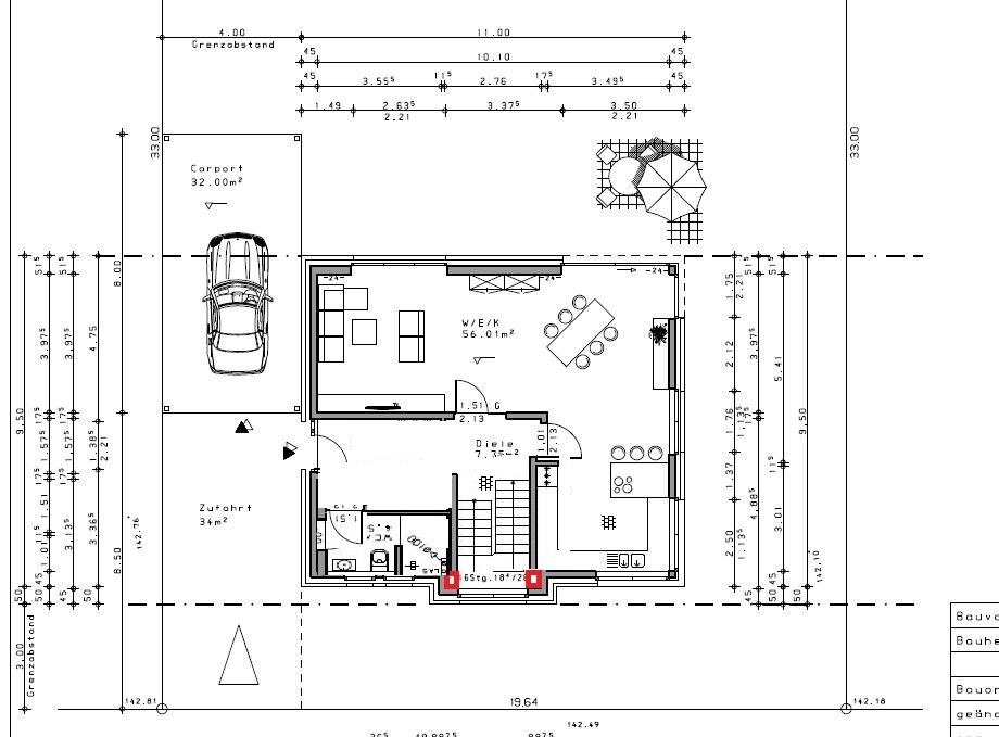

However, for GU1 we sent the sketches developed by @kaho674 as hand drawings. This is what came out:
Ground floor:
Upper floor:

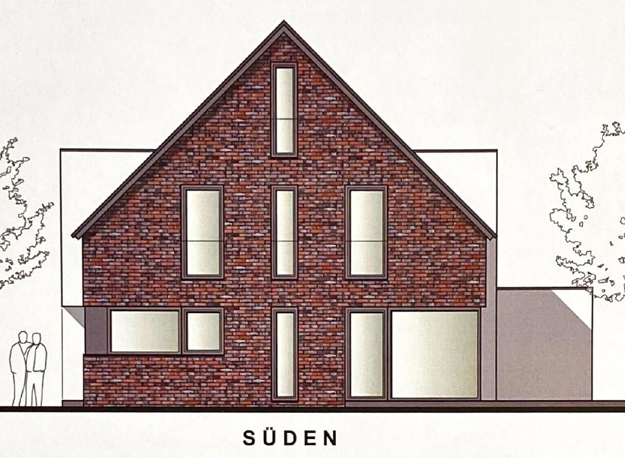

Note: Windows, exterior views, etc. were not the main focus at this stage. The designer from the company had very little time after consulting with the general contractor because he was apparently working on a large project for the building permit/planning permission simultaneously. Therefore, he only quickly drew the floor plans and calculated the dimensions and areas.
We would still like to make adjustments unless fundamental issues are pointed out by forum members.
Problem:
What we are completely unsure about is the office size of 9m² (97 ft²) in the rough construction. In theory, it should be enough, but in practice? I had imagined placing the desk along one wall at a right angle to the window and filling the entire opposite wall with cabinets/shelving.
Ah, I hadn’t replied to that anymore. Sorry! The entrance was never planned in our drafts to be under the carport anyway. The carport is intended to be moved back so that we have a quiet, shielded corner by the living room, protected from view and wind.
Ground floor:
Upper floor:
- We would definitely adjust the window areas facing the garden and try to add three large floor-to-ceiling double windows (living room, dining area, gable with sliding door).
- We would shorten the roof overhangs for a more modern look.
- I haven’t yet been able to discuss the hallway/stairs with the general contractor. I suspect the 70cm (28 inches) clearance between the two flights of stairs is due to symmetry/thirds division. The exterior elevation is also important to us because if the bay window at the front becomes too narrow, it looks odd. I imagine keeping the exterior walls but adding an extra layer of bricks on the inside to gain more space in the adjacent rooms (kitchen, bathroom, children’s room 2).
- For the walk-in closet, move one brick toward the bedroom to gain about 25cm (10 inches). One meter (39 inches) between the bed and the wall should be enough. We currently have that and especially with a separate walk-in closet, the bedroom should feel more spacious.
- Rotate the WC on the ground floor by 90° and then create a larger entrance area, meaning no separate storage room and integrating the wardrobe/seating bench into the now more open area.
Problem:
For the design in #77, I wouldn’t place the entrance under the carport. But moving the entrance or swapping the wardrobe/entrance should be no problem if desired.
Is an open staircase a must-have for you?
Otherwise, you could enclose the staircase and gain an additional 2.5-3m² (27-32 sq ft) of storage space, a cloakroom, or even a pantry (accessible from the hallway or from the kitchen if you forgo a cabinet there).
