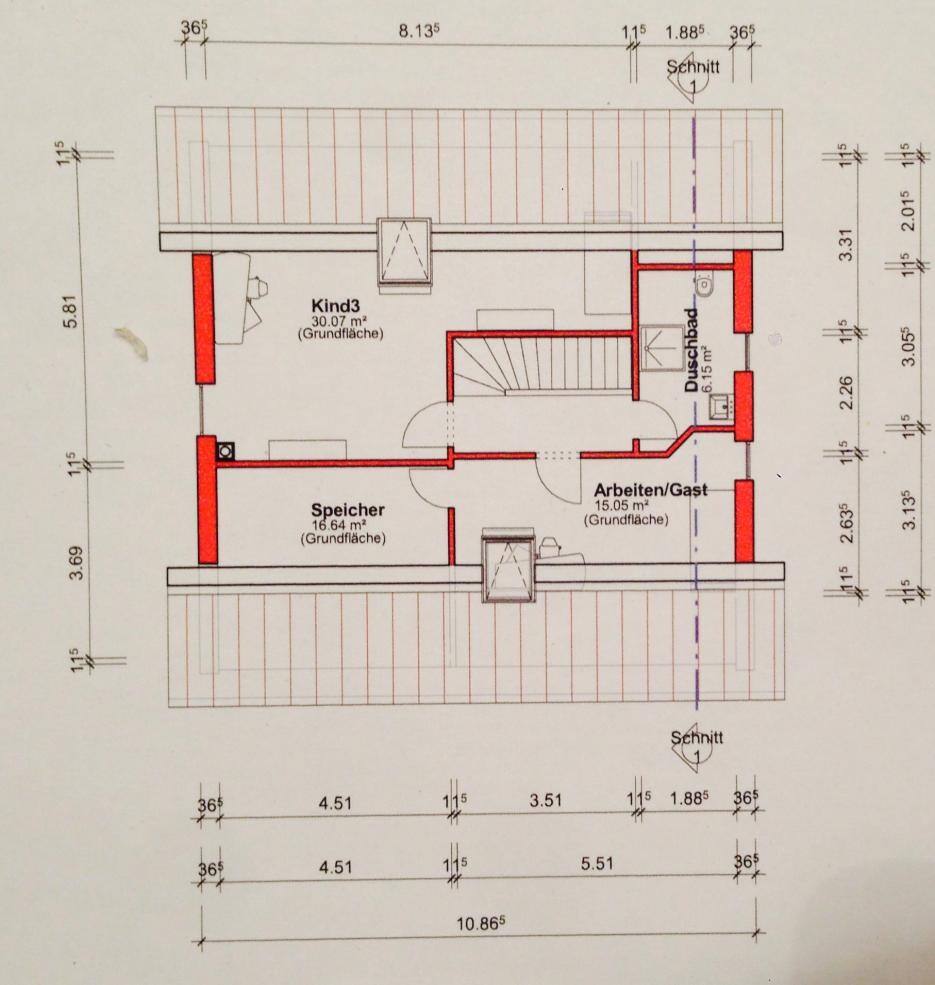

Unfortunately, we don’t like the attic floor at all. The slanted wall looks like a makeshift solution, while the kids’ room is way too large for that.

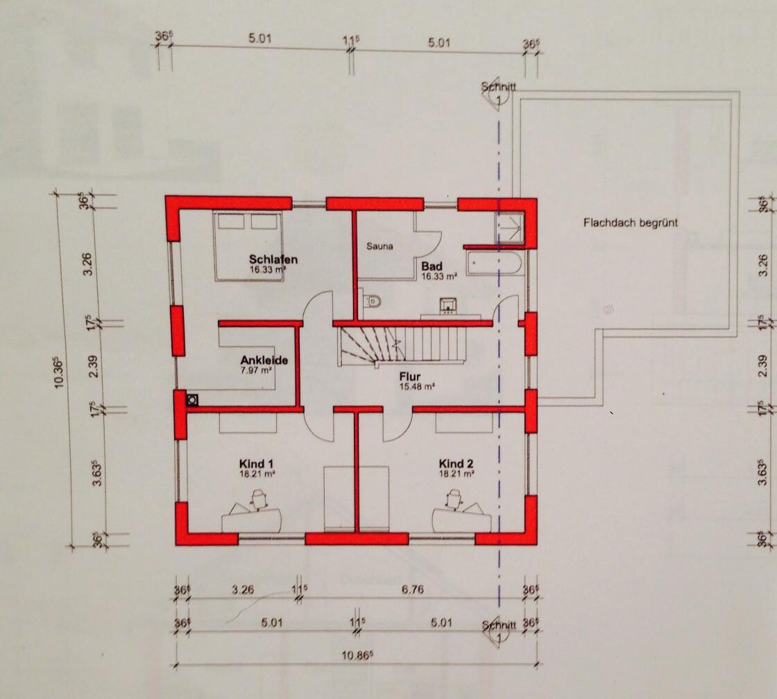

Otherwise, almost everything fits our needs. We would like to add a sliding door between the walk-in closet and the hallway to create two access points.

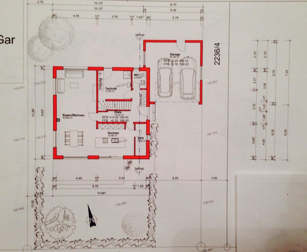

2D floor plan of a house with garage, garden, and entrance area
Upper floor plan with bedroom, walk-in closet, bathroom, sauna, and hallway
Upper floor plan with Child 3 room, storage, office/guest room, and shower bathroom

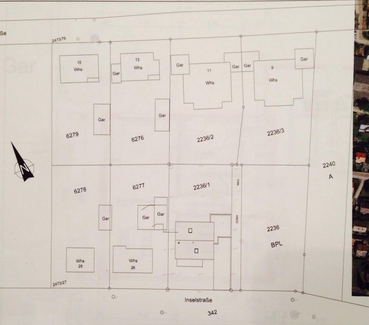

Site plan with property parcels, buildings, and garages along Inselstraße

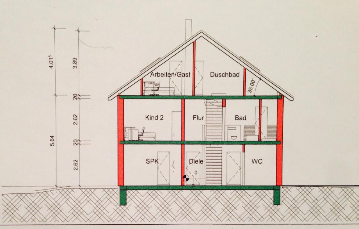

Cross-section of a multi-story house with stairs, walls, and rooms in the floor plan

We do not want the master bedroom in the attic.
And wouldn’t a 3m (10 feet) window be too large for the children’s rooms?

One more thing I’m curious about: how high is the knee wall at the top? Is there one at all, or does the roof rest directly on the ceiling?

Masipulami9 Feb 2014 08:59
According to the cross-section, there is no knee wall.
9 Feb 2014 21:34
According to the cross-section, there is a knee wall, but this height is missing, as well as the 2-meter (6 ft 7 in) line! Important to know! 🙂

The roof sits directly on the first floor ceiling.
However, we are now considering a steeper roof pitch and/or dormer windows, hoping this will allow for a better design.
Tomorrow we will contact the architect.
9 Feb 2014 22:36
milkie schrieb:
The roof sits directly on the first floor.
However, there is an knee wall there without any dimensions...
