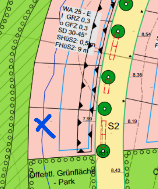

Now, about the building project: Yes, they are definitely serious about the "I" full floor level. The question is simply, what can we realistically get out of the first floor? Please search on Google for: Schönberg-Bebauungsplan-67-vorläufiger-Rechtsplan.pdf
Thanks for your effort!

I’m not supposed to cross-check all thirty sections of the development plan against your input from the usage template. Please provide an extract here where the plot can be identified.
The upper floor will definitely be an attic. Keep in mind that it’s better to optimize the knee wall height rather than maximize it!
It can be smarter—especially since point “I” here is fixed—to get used to having a knee wall rather than possibly stacking knee wall and knee wall base one after the other (except maybe partially, for example, in the bathroom).
I understand that a knee wall isn’t really what we currently imagine; let’s see if we can get used to the idea. But having a knee wall height would be desirable. The floor area ratio is limited, after all. The goal is to ensure that not 50% of the rooms upstairs have ceiling heights below 2.20m (7 feet 3 inches).
Attached is the plan
Map: Park on the left, yellow street on the right, X marks parcel, green circles beside street

No, the floor space index alone does not cause the restriction. Both the site coverage ratio and the floor space index, each at 0.3, are only maximum values. If only those mattered, a "town villa" would be possible with an actual site coverage ratio of 0.15. There is no eaves height restriction here, so at a building height of 9.00 m (29.5 ft), only the single full storey ("I" storey) limits it, since a 30° pitched roof could still start above the upper floor ceiling.
According to your image excerpt, the situation is clear: the reference height is 7.99 m (26.2 ft), so the base height can be a maximum of 8.49 m (27.9 ft), and the ridge height at 16.99 m (55.7 ft). In terms of height, I see the biggest limitation here in the non-full storey. What concerns me more are the trees and the two parking spaces.
