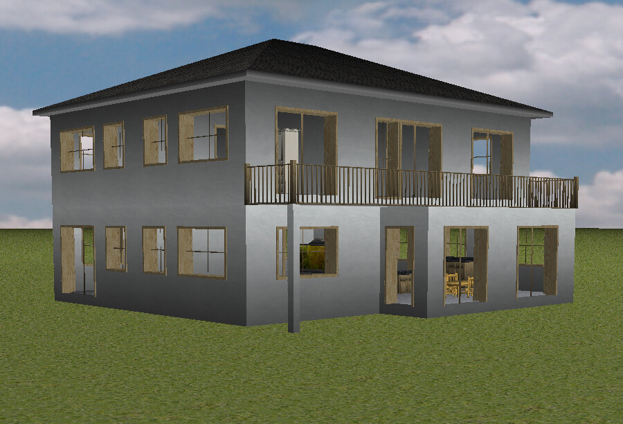

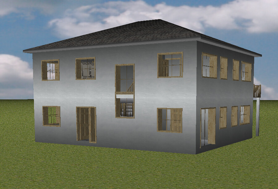

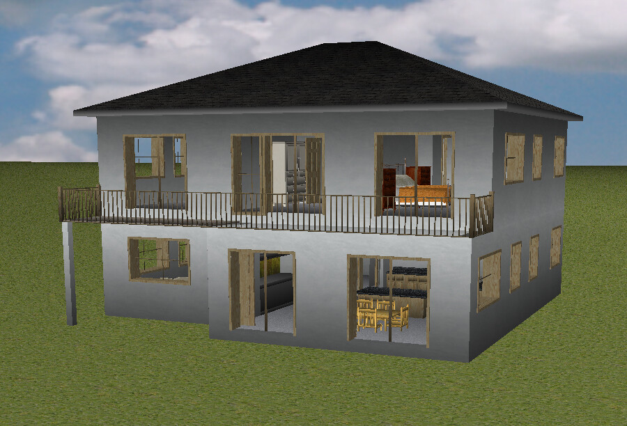

Who designed it: do-it-yourself with SweetHome3D
What do you like most? Why? Everything. I think I spent so long working on the floor plan that I’m in love with it and probably totally “blind” to its flaws.
What do you dislike? Why?
Personal price limit for the house, including equipment: 750,000€
Preferred heating system: gas
If you had to give up, which details/extensions
- could you do without: somehow nothing

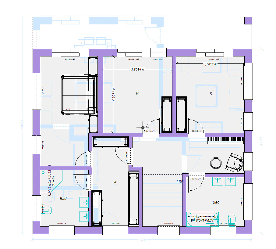

- could you not do without: large entrance/wardrobe; large children’s rooms; master bedroom facing east (I want to watch the sunrise); large aquarium as a highlight in the living area; platform staircase; children’s bathroom; and my wife absolutely wants a gallery.
Why did the design turn out as it is now?

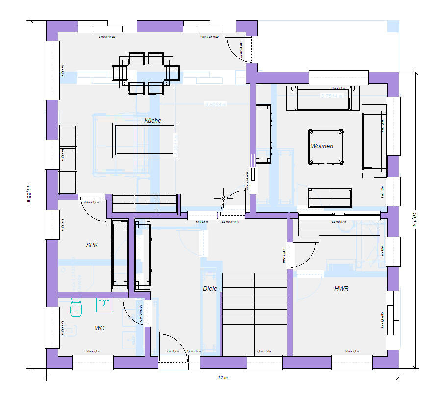

I looked at almost every floor plan from all prefabricated house manufacturers and, annoyed by the “cookie-cutter” designs (keyword: living room/kitchen/dining all in one long corridor and stairs always immediately by the dirty entrance), I started working out my own floor plan. Many thanks to this forum because I have learned a lot from the floor plan discussions here! I even dealt with Feng Shui for the layout.
The rooms are ideally oriented to the sun: living spaces face south, unoccupied rooms face north. In addition, the slight slope (to the east) allows for nice walk-out basement rooms. The layout can also be easily split into two apartments, making it flexible for a barrier-free future. Technical aspects and piping were also considered: the utility room is on the street side and pipes/water lines don’t run erratically but are kept close together.
The only downside I see is that the kitchen is “far” from the entrance. However, I don’t find this very problematic and only mention it because it would probably be a common criticism.
I’m grateful for suggestions or optimizations of any kind! Especially tips for the master bathroom. I’m not 100% satisfied yet.

@Baufie
I think you might have missed that the original poster is just gathering ideas before going to the architect. He knows the architect will probably do everything differently, I believe.

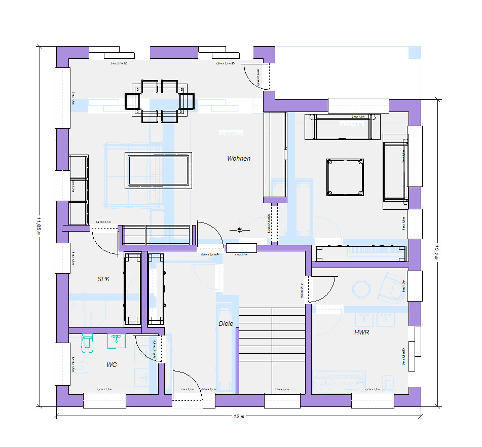

Here’s another idea:
Even though it’s a bit impractical – another version with the water feature as a room divider:
Traumhaus202019 Feb 2019 13:13Baufie schrieb:
It’s always surprising how a layman’s draft sparks a 20-page discussion here in the forum. You find it surprising, I find it EXTREMELY helpful! Over these 20 pages, I’ve learned a lot and I also see some things quite differently now. (Except for those radical ideas like building without a basement )
By now, I can give the architect a much clearer room program.
When I look at my original floor plan now, I mostly think: what a mess...
Baufie schrieb:
If I have a budget of 750k, I wouldn’t plan myself but rather leave it to a professional. That’s the plan as well. I think Kaho674 is the only one who realized that I like to plan and “play around” with ideas and simply want to gather a lot of inspiration. Thanks to her, I now have the perfect master suite on the upper floor. I’m 99% sure no architect will present me a better solution there. Thanks Katja
As soon as the architect’s design is ready, I will post it immediately and then things will get serious...
