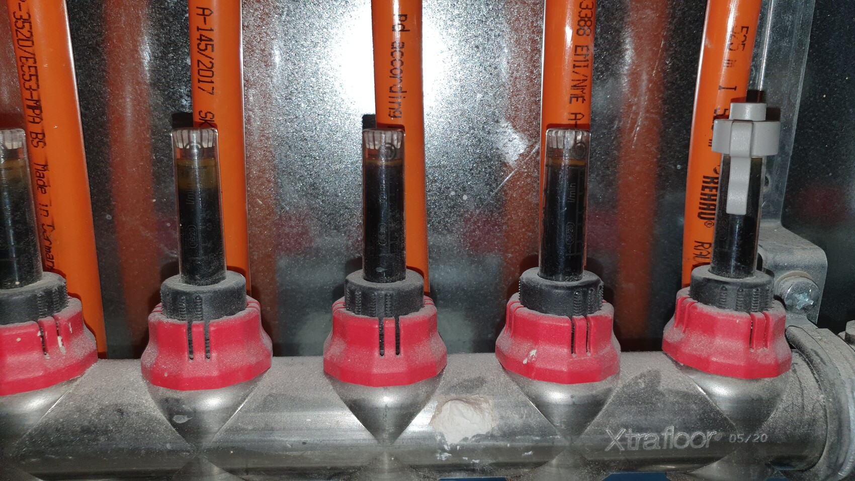

Stefan2.848 Feb 2021 07:35Hello everyone, I have been following this topic closely because I find it very interesting. However, I haven’t dared to start with it myself yet. I would like to ask two quick questions to better understand the system.
1. Question: When it was colder in January, I had about 1-5 compressor starts per day. In the last few days, with milder temperatures, I am seeing 10-20 compressor starts per day. How is this connected?
2. Question: The tubes (top meters?) are almost completely black and barely readable. The system was installed in November 2020. Is this normal?

Point 1 is probably due to an oversized heat pump combined with suboptimal settings. This will only improve once you become more comfortable adjusting the system.
I would raise a complaint about point 2. It’s likely that untreated water was used, causing something (expansion tank, towel radiator, etc.) to corrode continuously.
