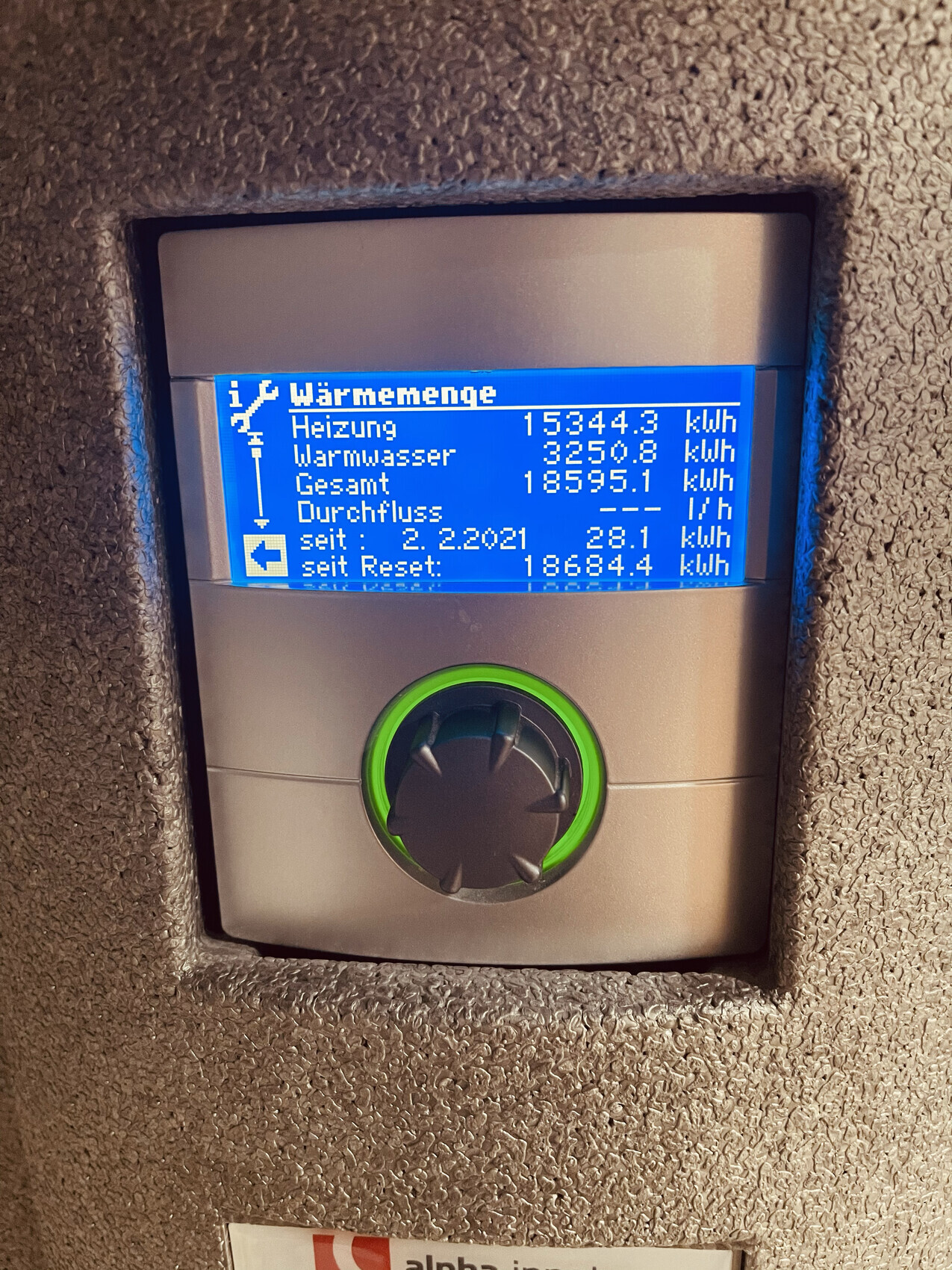

Blue display of a heating system with green rotary knob; values: heating, hot water.

Since you don't know exactly how much your heating system actually consumed, there is always a certain degree of inaccuracy in the figures.

Apart from the lack of accuracy of the internal meters, 28 kWh (kilowatt-hours) of heat is not particularly a large amount.

How else could it be? The heat pump only ran for 146 minutes in 24 hours. Yet, the house is warm enough.
