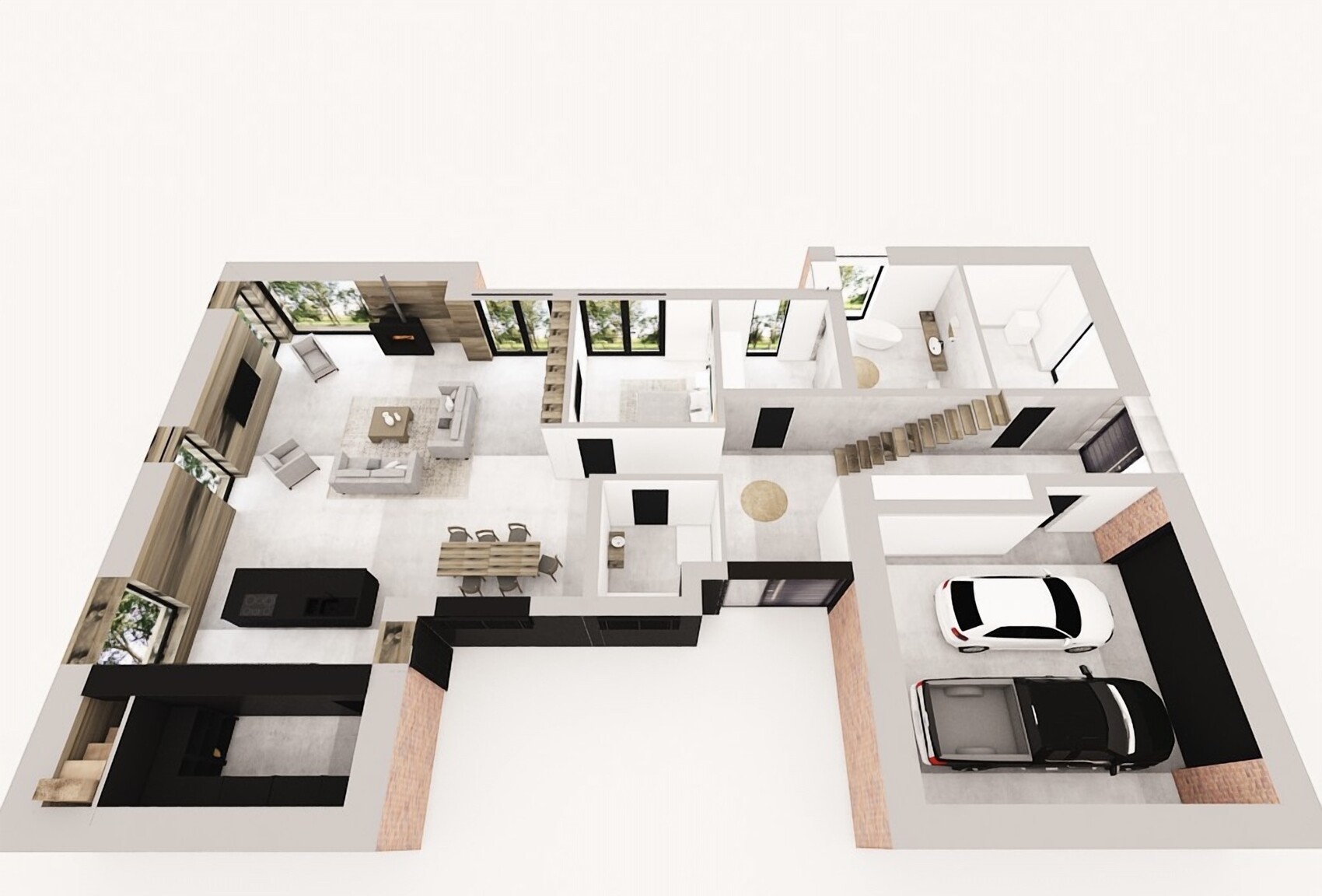

Deliverer23 Jul 2022 11:40ateliersiegel schrieb:
For thousands of years, thick walls have been the way to climate-control a house well ..That is still true today, provided you no longer use the old materials. Back then, walls were thick only for structural reasons – their insulation performance was terrible.Our floor plan of the ground floor. On the upper floor, the left wing has a small gallery, and on the right wing, there is a small hallway with a bridge open on both sides, two children's rooms, and a guest room. I can only visualize this in 3D with great difficulty. The central section is single-story.
