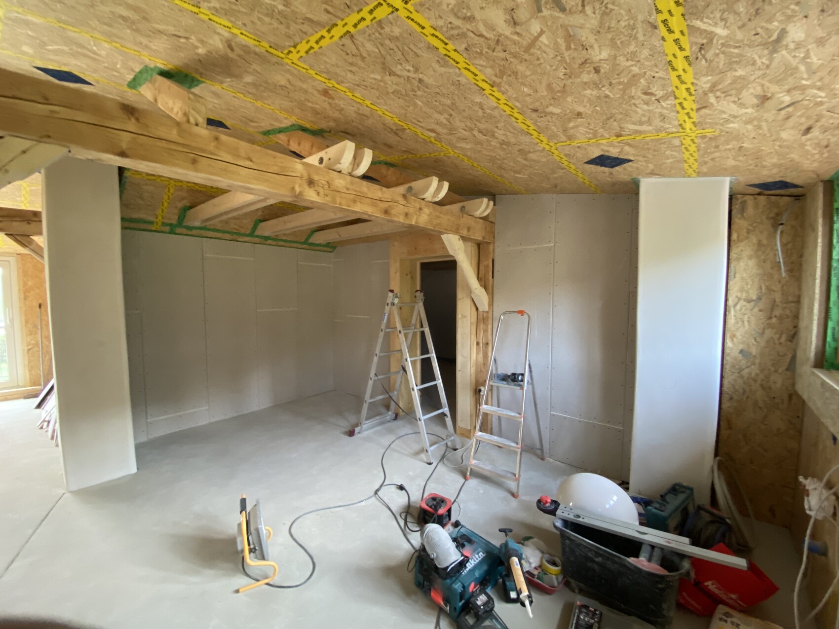

That’s a bit of a shame, but still very nice!Thank you, the renovation would have simply been too complex and might not have worked out that well. The roof had to be perfectly flat for the flat tiles, and I’m not sure if the final construction would have been structurally feasible without any clamps. We kept the old roof beams from the two gable roofs dating back to the 19th century and stored them carefully. Some will be used for decorative purposes, possibly around the chimney, and the rest will be sold.

I don’t know if the final construction would have been this simple structurally without using clamps.What’s the trick to managing without clamps? Is it the ring beam? The flat roof in the middle?
(I’ve been through a clamp situation myself and, while I’m satisfied with the result, I would have been happier—and above all, it would have been cheaper—without all that clamp hassle.)
ateliersiegel schrieb:
What’s the trick for avoiding the use of clamps? The ring beam? The flat roof in the middle?
(I’ve been through a clamp hassle before and, while I’m happy with the result, I would have been happier without the clamp fuss—and especially it would have been cheaper) The ring beam was designed to support this, as are the rafters. Both gable roofs—the other gable roof contains finished living space without exposed beams (a standard structural timber roof).
