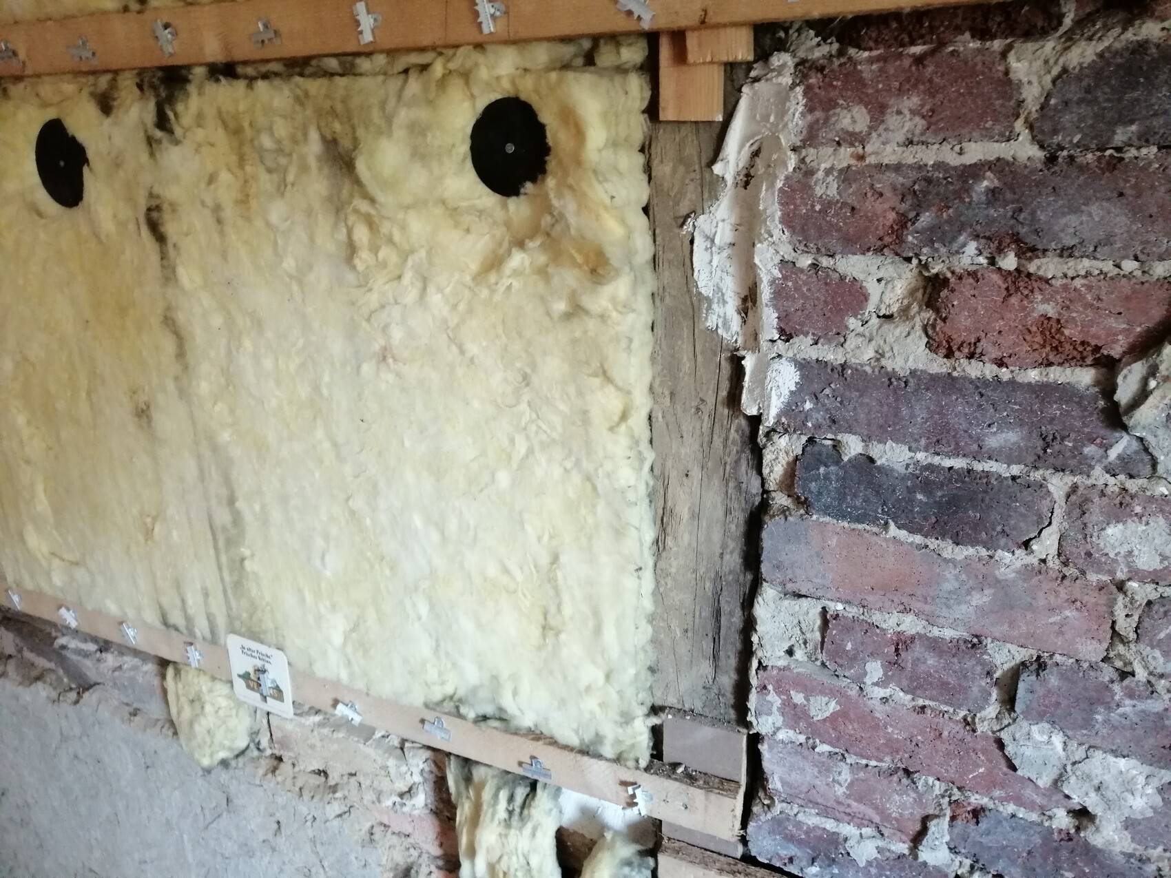

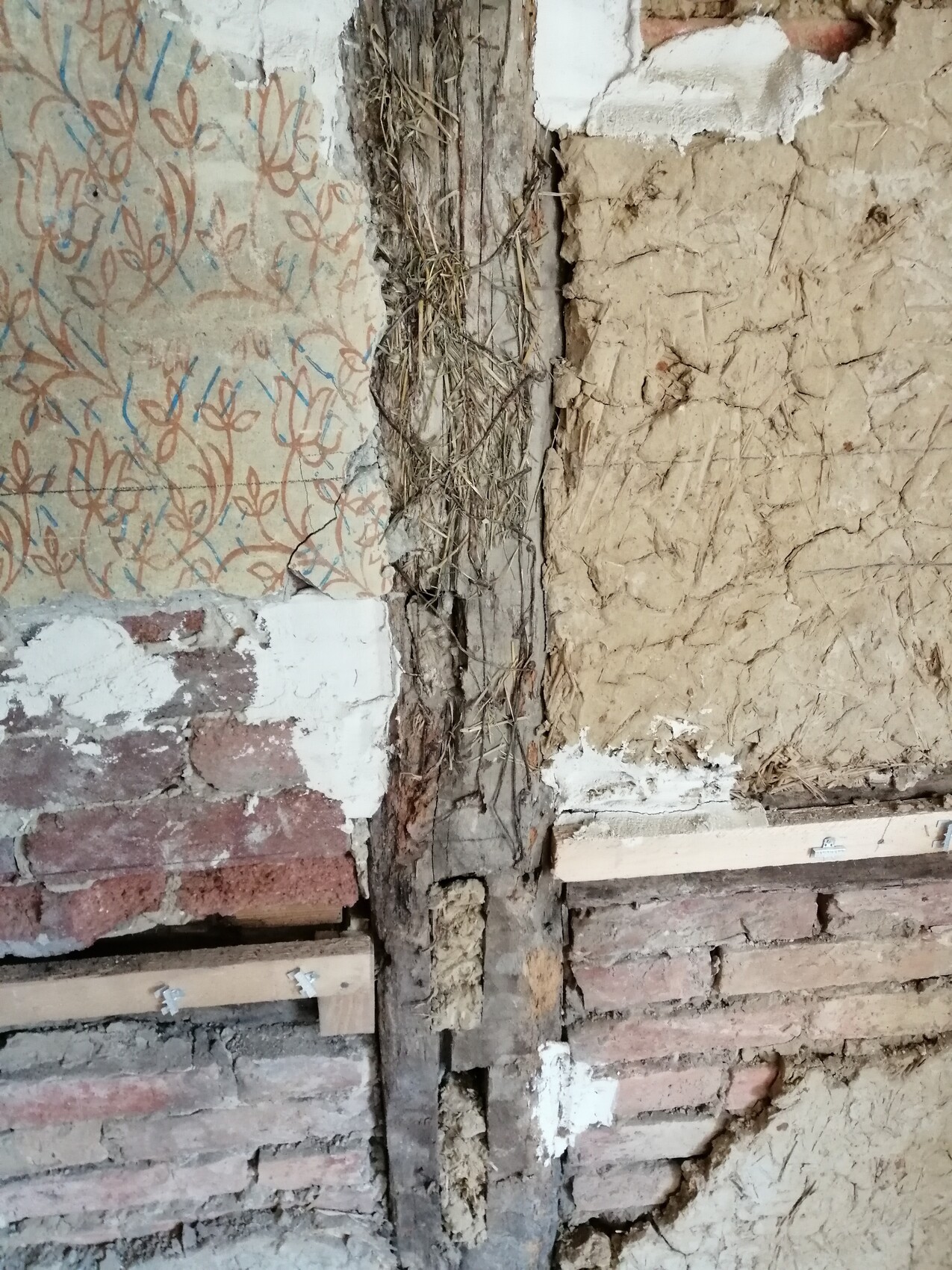

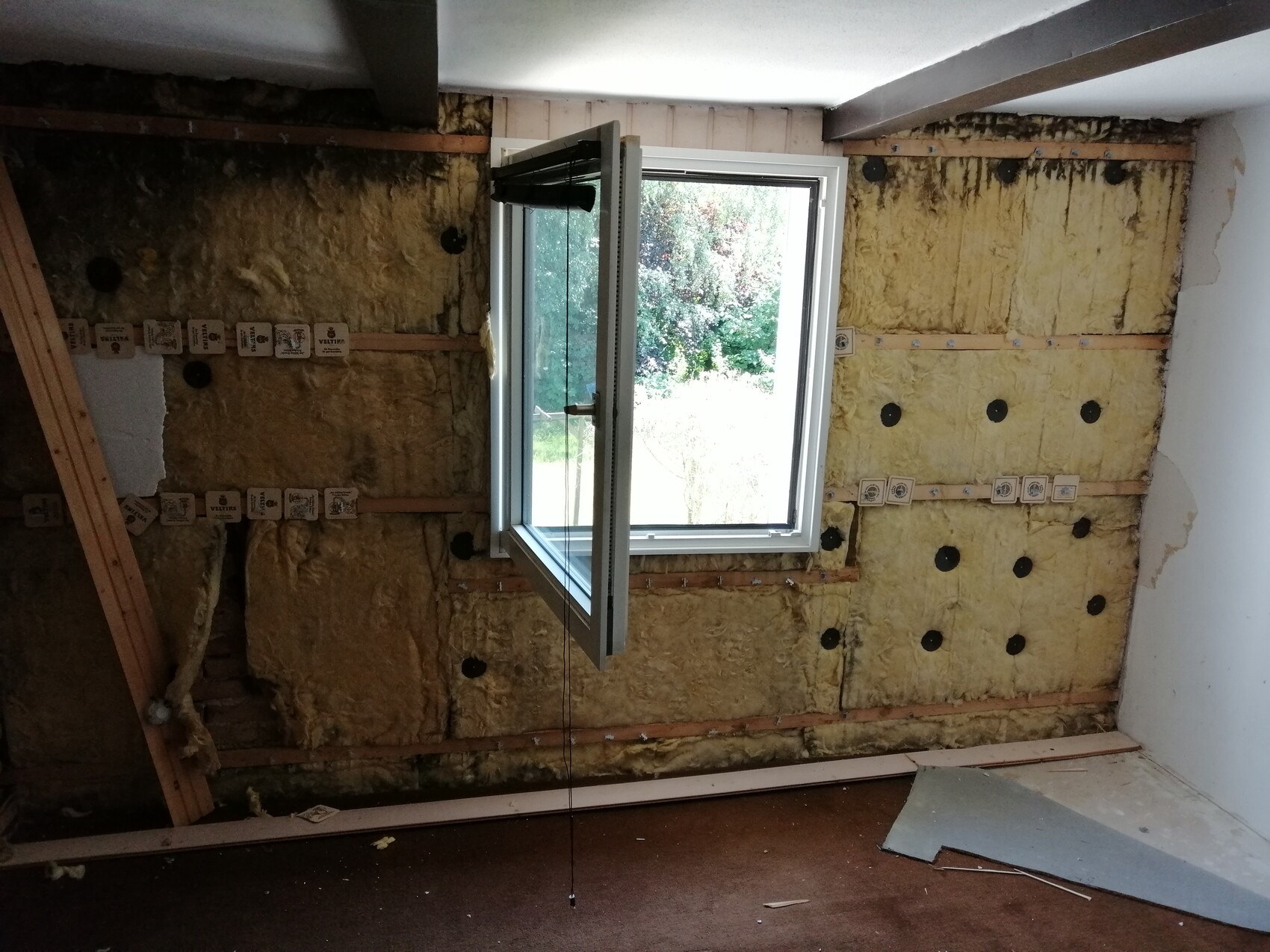

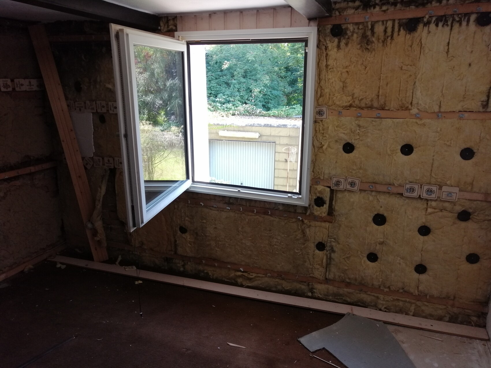

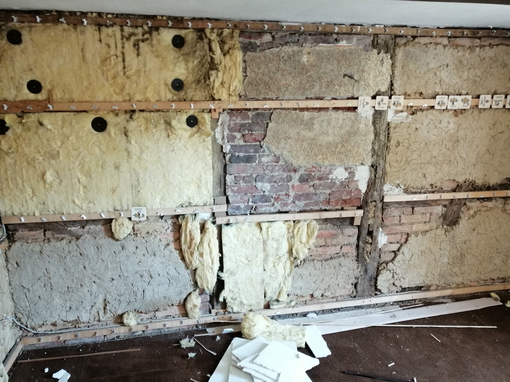

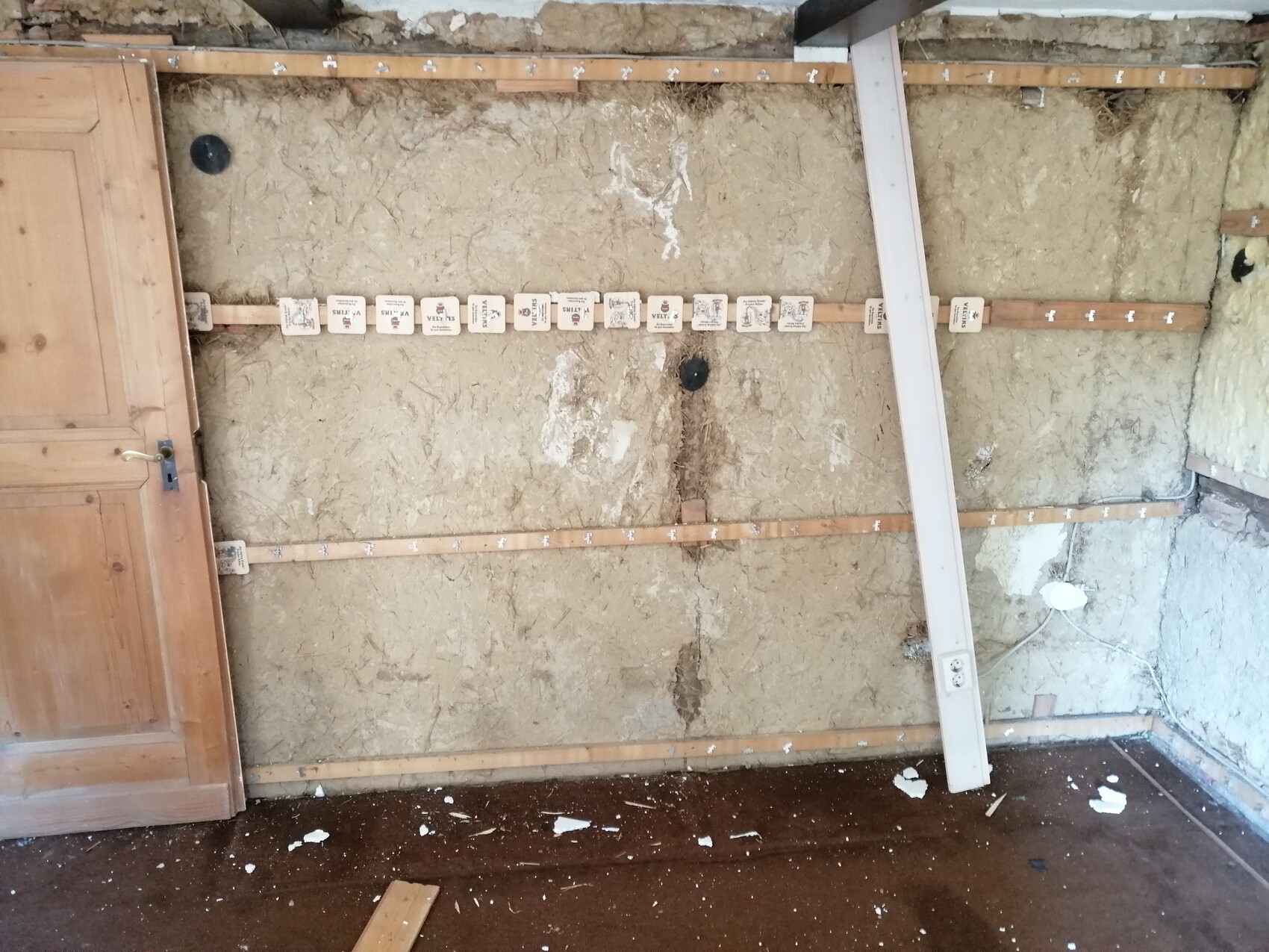

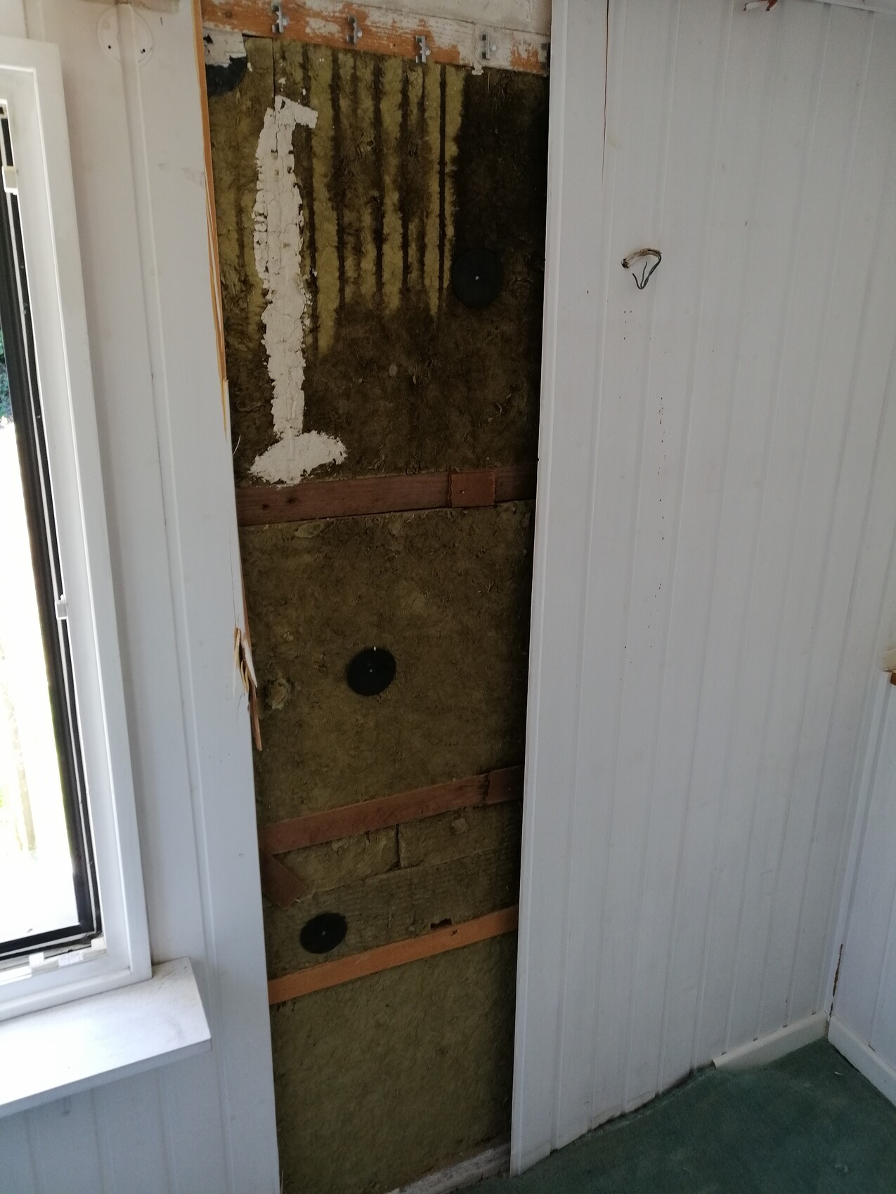

As of today, we were finally able to start work on our half-timbered house from 1890. First, we removed the old wooden slats from the walls and uncovered the following:
Basement room under renovation, open window looking outside at trees; walls with insulation.
Open window; room in need of renovation with yellow mineral wool insulation between wooden beams.
Interior wall under renovation: exposed bricks, yellow insulation, wooden battens, and plaster remnants.
Old, damaged wall with exposed straw construction and plaster remnants.
Wall with spray foam insulation (yellow) in the cavity between wooden framing; brick wall on the right.
Unfinished interior wall with clay plaster, horizontal wooden battens; a white board leaning against the wall.
Open interior wall with insulation, wooden battens, plaster remnants, and black round covers.
Now we are wondering what would be the best (and most cost-effective) way to re-cover the walls? Ideally, we would like to use drywall (gypsum board), but I have heard that this is not recommended for half-timbered houses due to the risk of mold.

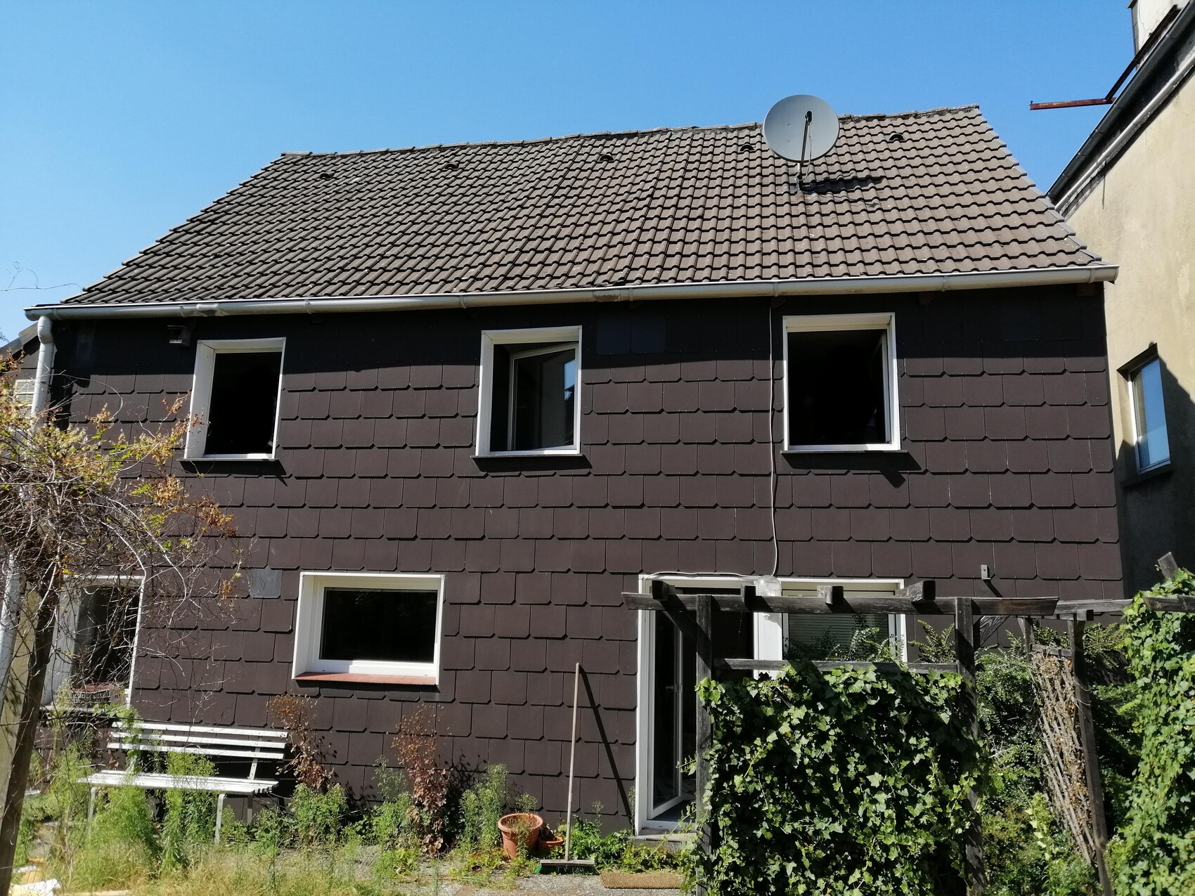

The house is not directly exposed on the outside, as it is covered with fiber cement panels (Eternit), so the timber frame is protected from direct rainwater.
Two-story house with brown shingles, open windows, satellite dish, and lush garden.

Unfortunately, I can't contribute on this topic, but is the roof really as "wavy" as it appears in the photo?

Should the facade remain?
What is the budget? What work needs to be done?
Everything is still possible, from plastering and clay plaster to drywall, wood fiber interior insulation, and wall heating.

If you already have the walls open, I would first have the wood inspected to see if it is still in good condition everywhere.
A huge project both financially and in terms of time commitment.
Doing it right, demolition and rebuilding is probably cheaper. But I think it's great when houses like these are preserved.

Phew, I always admire people who dare to take on something like this. However, your post including the question (+ affordable) leaves me a bit puzzled. Has a professional looked at this?
Before starting, a thorough structural assessment should be carried out urgently; otherwise, you might end up wasting a lot of money.
