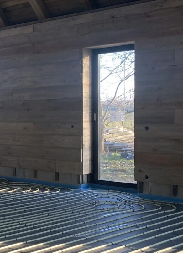

ateliersiegel schrieb:
Does visible screed mean that you can see it? Nothing else is applied on top? I wanted the same for our underfloor heating, but my wife preferred wood. Now we have thin, dark oak, which looks great and feels good.Exactly, a trowel-smoothed and then PU-sealed living concrete floor with very few visible joints throughout probably the entire house. It was very difficult to find a good contractor for this, and I am really looking forward to the result.
Ah ... and how are the corners done? Tongue and groove "is not an option" either?Which corners are you referring to exactly?
What I always appreciate is when the material used in construction is actually visible. There is something “honest” about that, and it helps (at least in my experience) to better understand the world.
In the case of exposed screed, the most important aspect seems to be how the surface actually looks, because painting over it is definitely NOT an option right now. There are quite a few possibilities for that.
(When it comes to cement, I usually refer to Sven Backstein and his "Mörtelshop" (with oe). He knows his stuff well and provides detailed and quick answers.)
oh ... and how are the corners done?
Tongue and groove “isn’t really an option” either? Tongue and groove could have been done for a much higher cost. We’ve seen it with other builders as well. I find our cladding much more authentic—especially because it’s not so perfect. It was supposed to become a farmhouse-style house. For the external corners, I’m using strips made from the same wood. Some are already in place.
Ilef123 schrieb:
Tongue and groove could have been an option for much more money.If it’s not technically necessary, then it’s not needed. Tongue and groove is generally more stable overall (it warps less because the boards support each other), less air passes through the gaps, and if the air is dry and the gaps are therefore wider, you can’t see through the cracks.
But your solution seems stable enough anyway, and there will probably be little wind whistling behind the boards either. 😉
