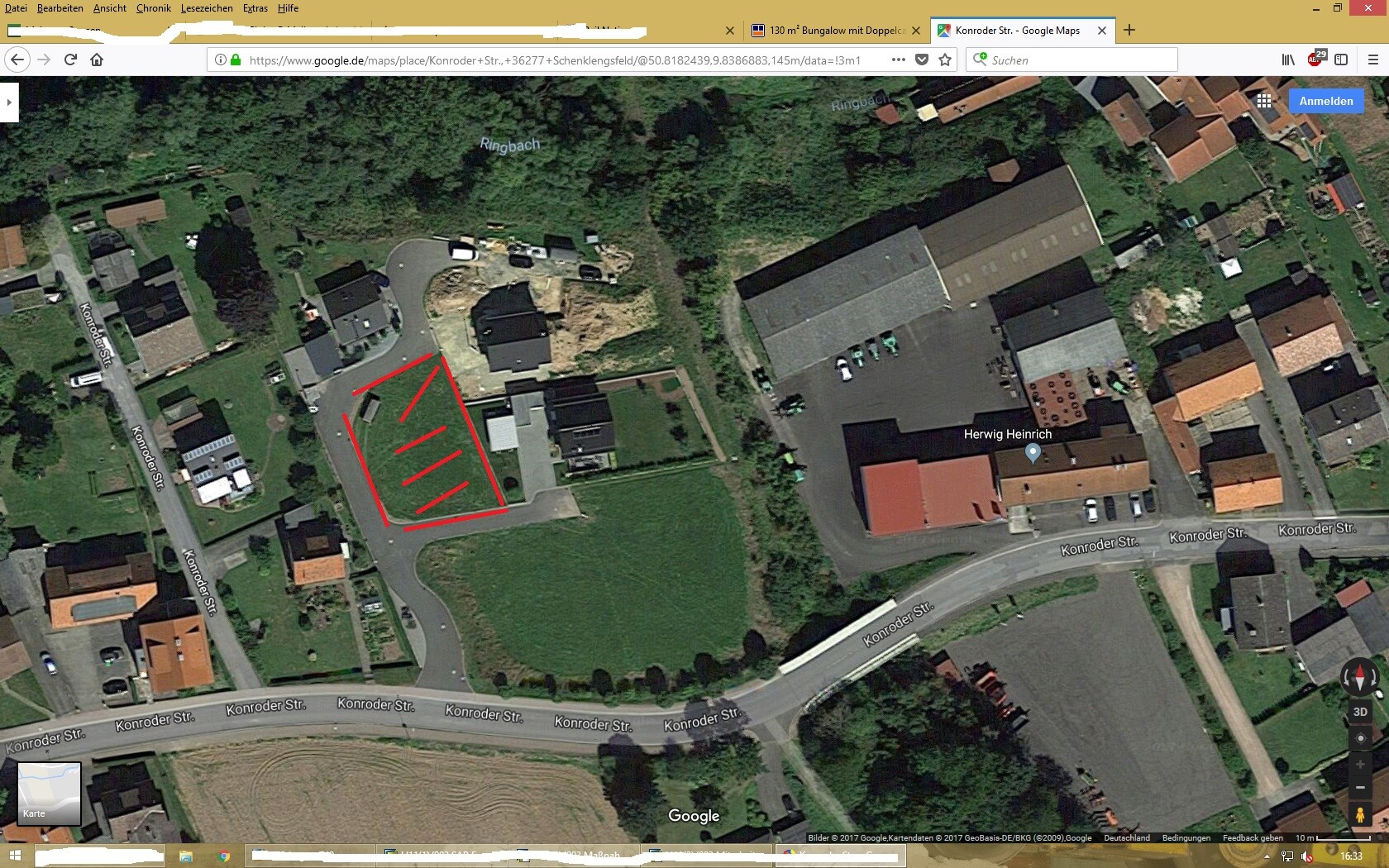

Why are you positioning the house so far back? Every centimeter (0.4 inch) away from the street costs money.
Site development, courtyard paving

Do you see any major design flaws in the floor plan?Not just in the floor plan – although there, too: relative to the garage, all the following rooms feel like small boxes; the peak of this is the study. But in my opinion, the design mistakes start with the overall layout – you basically need a car just to get from the driveway to the garage. Forget the pointless connecting door, move the garage closer to the driveway, and let the house enjoy the property. With this site layout, it’s practically backed up against the wall.Even people who define themselves socially by their vehicles could live much more comfortably with a bit of good will (and on a lot this size, quite easily!).
The problem already starts with the driveway to the garage:
If the driveway is also set back 5 m (16 feet) from the property boundary, I would like to understand how the garage is supposed to be accessed by a vehicle.

What is allowed as boundary construction? A garage? This really seems like it should be positioned to the south after about 10 m (33 feet) of driveway.
