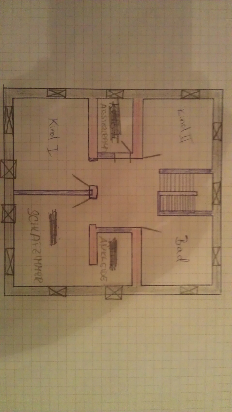

Ground floor: The entrance is hidden and off to the side, so the hallway on the ground floor will be dark. The sequence of rooms in the living area could be nice.
Upper floor: Bedrooms for children are uneven in size, access to the bedroom is likely through the head end, and the walk-in closet is an awkward, enclosed space.
For a proper evaluation, the orientation and the site context are required, among other things.

Upper Floor: Children's rooms are uneven in size; access to the bedroom is probably at the head side; dressing room as an enclosed space is unfavorable. WD
...Correct, the children's rooms are uneven in size, although we believe approximately 16 sqm (172 sq ft) and about 20 sqm (215 sq ft) are perfectly sufficient. We are also considering adding a door from the storage room to the smaller child’s room to possibly use the storage as a dressing room, for example.
...Access to the bedroom is at the head side, correct. Is that not okay?
...Dressing room as an enclosed space is unfavorable... why?

...access to the bedroom is at the head end, right. Is that not okay?
...a walk-in closet as an enclosed space is unfavorable... why?
Having access at the head end causes disturbances, and the walk-in closet should be designed so it can be used without disturbing the person sleeping.
