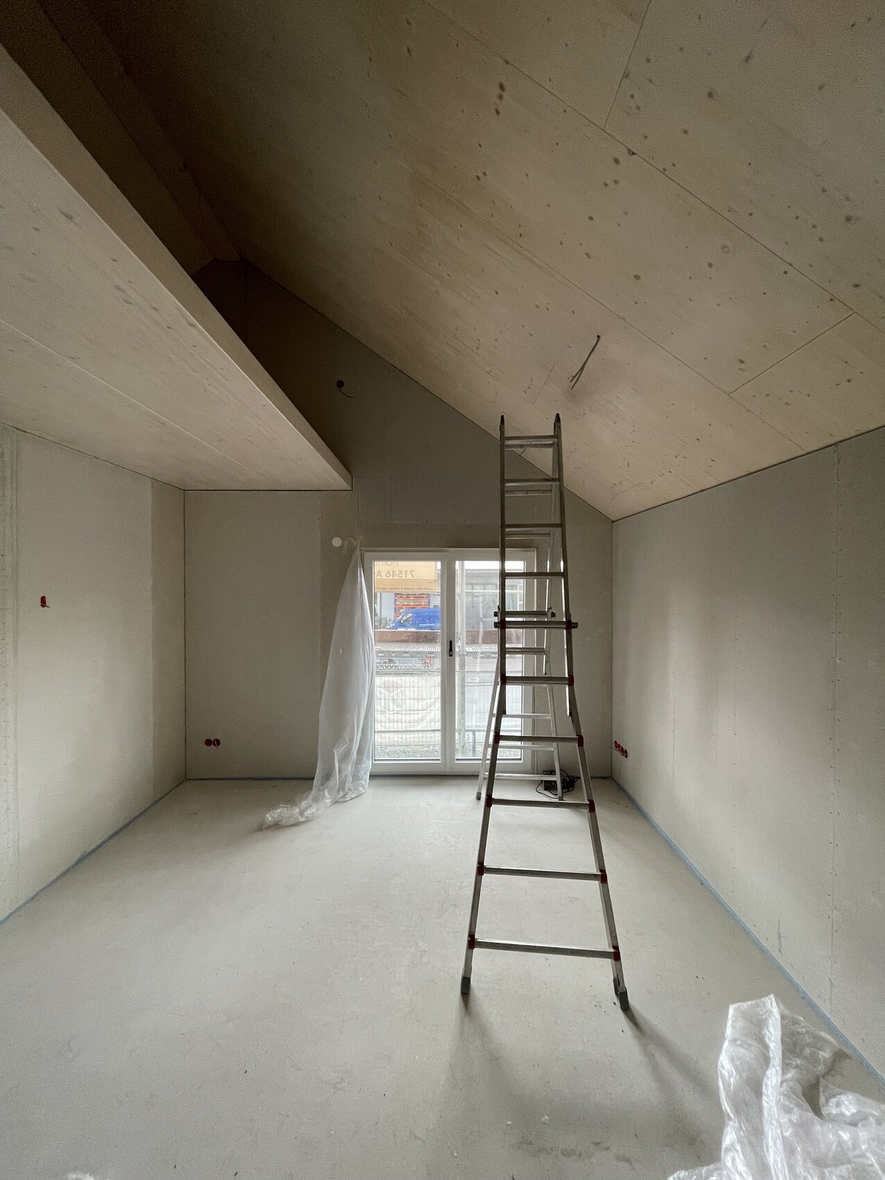

19 Aug 2023 22:04
Not much is happening outside at the moment. However, the façade work will start in two weeks. Then the house will finally get its finished look.
Inside, the tilers, plasterers, and we are all busy. The red lime plaster will soon be finely applied, and the ceilings on the ground floor are getting painter’s fleece. Currently, we are still glazing the raw wooden ceilings (which takes forever with linseed oil!) and, at the same time, I am doing the electrical work.
The kitchen is scheduled to arrive in October, and moving in is planned for November. We are really happy that everything has gone so smoothly so far (apart from the small issues that almost every homeowner experiences).

19 Aug 2023 22:51
I like the stair railing. When I built, they were not really common yet.
i_b_n_a_n21 Aug 2023 10:03
Malunga schrieb:
... Currently, we are still applying a wood glaze to the raw wooden ceilings (takes forever in EL!) and at the same time, I am doing the electrical work.
I feel like I’ve been transported back in time. We also mostly did the electrical work ourselves. However, we had the ceilings glazed by a professional. The painter masked everything off and set up a spray device, then applied the glaze twice.
With about 240m² (2,583 sq ft) of ceiling area across 4 residential units, doing it ourselves was no longer feasible time-wise, and I found the quote acceptable at the time (€3400 including VAT for “masking, sanding, and applying two coats of ADLER Lignovit Interior UV 100”)
