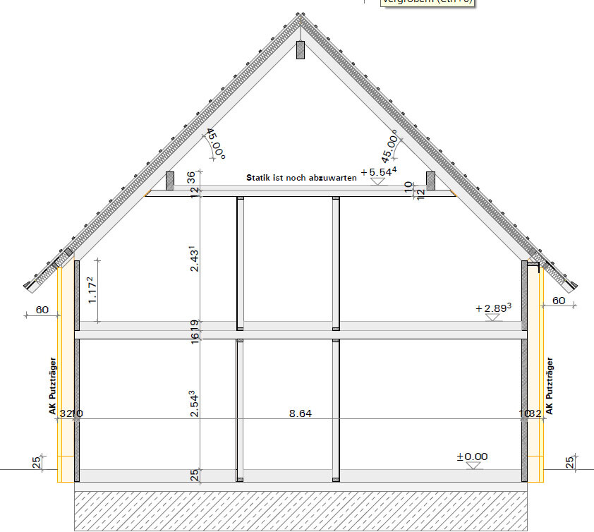

Perhaps our sketch helps: eaves at 4.5 m (15 ft), ridge at 9 m (30 ft). So each is 50 cm (20 inches) higher than your really uncomfortable values.
Subtracting 50 cm (20 inches) from our knee wall height would result in 67 cm (26 inches).
I have actively helped build log homes before; there are two in the family. I would have also mentioned the typically required utmost precision for electrical planning. Not only windows and doors have special installation rules in this case (with sliding strips).

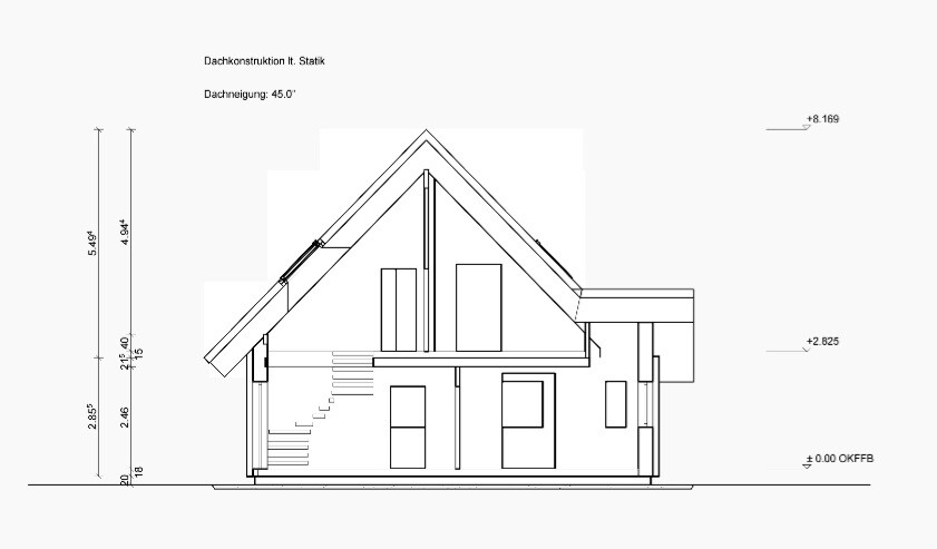

Regarding the knee wall: I’m unsure which parameters we need to change concerning roof pitch and the discrepancy with floor area calculations due to the “one-and-a-half-story” structure – the roof angle is definitely not fixed. Currently, it’s set to 45 degrees, but anything from 35 to 50 degrees is possible.
I do like the idea of the dining bay window here, but I would put a question mark by the “log house” concept and rather aim for a more “classic” timber frame panel house (or a cellular concrete kit house).
Okay, thanks for your feedback here! Initially, we planned a solid masonry house for summer – with completely excessive costs and uncertainty because we have no experience with that construction method at all. Therefore, the timber house (although it must be planned meticulously) really seems like a safe option since our house will be fully weather-tight within four weeks, and we can better estimate the following work… Besides that, the sense of space, in our opinion, is unbeatable. Honestly, we fell in love with this construction method. Especially since our manufacturer works without vapor-impermeable foil technology and the kit meets KfW40 standards.
Maybe the wall structure is relevant here: Inside, 100mm (4 inches) log plank, 200mm (8 inches) cellulose blown insulation, 55mm (2 inches) log plank as exterior cladding. Visually more like a Swedish house, so no full tree trunks.
I attached the current section and an exterior view again below!

Thank you very much for your sketch... 67cm (26 inches) is really also very little. Currently, 40cm (16 inches) is in the plan, which of course is out of the question. Can the roof pitch be adjusted more to improve this, or would that ruin the sense of space? Could 80cm (31 inches) also work? What is your experience with this construction method?
