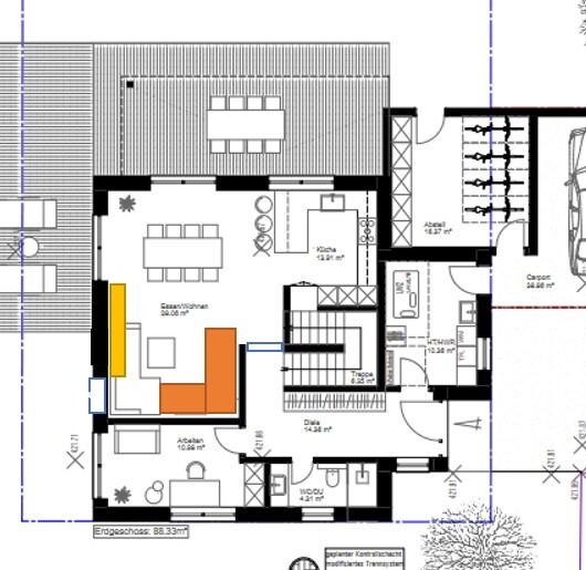

Hello everyone, my wife and I are planning to build a house.
We have now received the first draft from the architect and are already quite satisfied.
There will surely always be room for improvement.
We are not entirely happy with the garage/carport solution and hope for some additional ideas here.
Unfortunately, the plan does not include any dimensions yet ("first plans are always without measurements" with this architect).

Benzeller22 Jun 2022 12:55Thank you very much in advance for the suggestions and improvements.
Regarding the garage, we ourselves are still not exactly sure what we want. For the next plan revision, we have now added a garage next to the storage room, as well as a carport that is supposed to stand on three columns without a rear wall. Under the roof, there will be a stage. I would like the staircase to be a landing staircase (as it was in my parents’ house).
Walk-in closet: We have currently measured our wardrobes and only have about 3.5 m (11.5 ft) of wardrobe space where we store everything we wear, so the door should still work here. The facade is important to my wife; she wants everything to be symmetrical.
The wooden paneling is estimated by the architect to cost about 20,000 € (approximately 22,000 USD).
- A large house, but no possibility or option to place a side-by-side refrigerator, I also don’t find that ideal
- The door between the walk-in closet and the bedroom ruins the walk-in closet layout.
- Too little storage space
- Very challenging facade for me (with the apparent beams, too much uniformity, no variation at all)
I will take a closer look at it this evening… right now I can’t even see the square meters due to lack of resolution.

allstar8322 Jun 2022 14:54I think it’s pretty good. Friends of mine have a similar floor plan. Here are a few points you might want to consider:
Kitchen sink and door:
Currently, you have to go around the corner to reach the cabinets on the terrace side. If you choose a two-part kitchen instead of a U-shaped one, you won’t have corners and will have easy access to everything. Also, you could add a door from the kitchen to the terrace. I think that’s great—we have it ourselves. It’s also very useful for ventilation.
Window / light axis:
If desired, adding a window facing the terrace could create a line of light through the hallway towards the living room.
Terrace door for the shed:
Why doesn’t the door of the shed open out towards the terrace?
Front entrance door:
Why is the door hinged the way it is? Would it make more sense if it opened the other way?
Shed door:
The door might be quite narrow for bike access. We have a sliding door, but that might be difficult to implement in your case.
Kitchen pantry door:
With the hidden door in the kitchen, you lose some storage space. Having access through a door in the hallway might also be an option.
Shed door:
Overall, a nice first draft. The architect clearly put some thought into the plot.
I would address the previously noted comment about the long corridor to the living area as suggested in the sketch to make it less of an issue.
For the living room, perhaps consider adding a (glass) sliding door. It might also be possible to shorten the cloakroom area slightly and design the wall so that the first two steps of the staircase turn around the corner. This would make the space feel more open.
In the living room, I would (!) also change the sofa orientation. In my sketch, you can see both the TV and the garden/terrace from the sofa. Depending on the desired TV size, the small south-facing window might need to be moved or combined with the window in the dining area.
RomeoZwo schrieb:
Overall a nice first draft. The architect has clearly put some thought into the plot.
I would soften the already mentioned issue of the long corridor leading to the living area, as shown in the sketch.
[ATTACH alt="grundriss-155qm-in-baden-wuerttemberg-tippsverbesserungen-581846-1.jpg"]72865[/ATTACH]
For the living room, maybe consider a (glass) sliding door. Perhaps you could also shorten the wardrobe area a bit and design the wall so that the first two steps of the staircase turn around the corner. This would open up that space.
In the living room, I would recommend changing the orientation of the sofa. In my sketch, the sofa faces both the TV and the garden/terrace. Depending on the desired TV size, the small south-facing window might need to be moved or combined with the window in the dining area. Shortening the wall won’t fix the issue. A partial reset is needed (see ypg).
