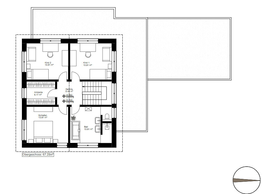

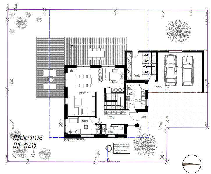

Hello everyone, my wife and I are planning to build a house.
We have now received the first draft from the architect and are already quite satisfied.
There will surely always be room for improvement.
We are not entirely happy with the garage/carport solution and hope for some additional ideas here.
Unfortunately, the plan does not include any dimensions yet ("first plans are always without measurements" with this architect).

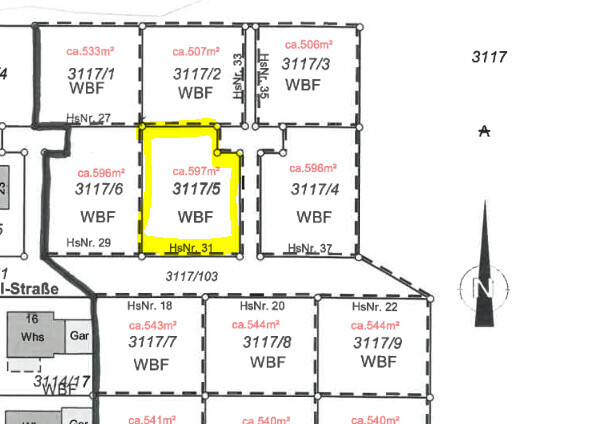

Zoning plan / restrictions
Plot size: 597 sqm (6420 sq ft)
Slope: gently sloping to the north, max. 1.5 m (5 feet) over 25 m (82 feet) length
Site occupancy index: 0.4
Floor area ratio: 0.8
Building envelope, building line and boundary: see plan

Garage, carport: storage room for bicycles etc.

What do you particularly like? Why? The exterior view is very successful. The entrance area on the north side with wooden cladding softens the appearance. Large hallway for arriving / stair landing / if needed 3 children’s rooms (on ground floor)
What do you dislike? Why? Swap the shower and washbasin in the ground floor bathroom / we are still unsure about the carport solution / upstairs, a door will be added from the walk-in closet to the bedroom

driver55 schrieb:
A half reset is needed here (see ypg)Personally, I don’t like having a direct view of the living room from the door. It’s really a matter of personal taste.
Swapping the kitchen and the office would make that possible. However, the route from the terrace to the kitchen would then be very long.
RomeoZwo schrieb:
Personally, I don’t like the idea of looking straight into the living room from the front door. But of course, that’s a matter of personal taste.
If you swap the kitchen and the home office, it would be possible. However, the walking distance from the terrace to the kitchen would then be quite long. Yeah, but nobody wants to sit half in the hallway by the stairs either…
driver55 schrieb:
Yeah, but nobody really wants to have a seating area halfway up the stairs in the hallway either… Some (many) people build the stairs into the living room instead ;-)
RomeoZwo schrieb:
Some (many) people build the staircase directly into the living room ;-) but usually without small children.I find the "discussion" here too one-sided... discouraging. In this respect, I can only hope that the architect will make another effort.
