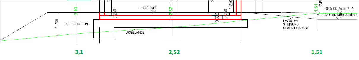

Unfortunately, the green numbers on the right side of the plan are hard to read. If you intend to raise the ground level, won’t the garage driveway become too steep and create a sharp angle towards the street? Some views of that would be helpful.
Northeast means a nice view, but a well usable terrace facing northwest-west wouldn’t be a bad idea to improve evening comfort during summer.
A site plan showing neighboring houses usually provides clarity. The garage driveway rises 48cm (19 inches) over a length of 6 meters (20 feet), which is about an 8% incline on average.

Site plan (our lot marked with a red dot), I still have to find the elevation plan:
Section Northwest, elevation details in green
Behind the house (north / northwest), soil will be added to raise the terrace area. Towards the rest of the garden, this will likely need to be supported or tapered off gently. This is not finalized yet, and we have not worked out those details mentally.
