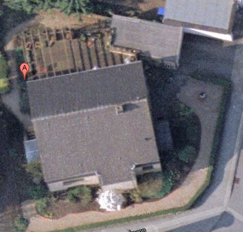

3. 49 m² (530 sq ft) terrace? In my opinion, that’s extremely large. How big is a typical terrace? Around 15 m² (160 sq ft)? Well, it depends on the layout of the plot. My parents also have about 40 m² (430 sq ft) of terrace, and in summer, the whole life happens there (including a paddling pool for our little one).
The plot is very small and simply doesn’t allow for more (gap between buildings – formerly my grandparents’ garden).
Of course, I don’t know if Schwupp also has a large garden in addition...
Where do you think you would spend the summer at your place? Do you usually gather near the kitchen to chat, or do you perhaps prefer to relax in a shaded spot under a tree?
I really like my parents’ large terrace, and I definitely don’t think it’s too big. But then, they don’t really have any other options either.
