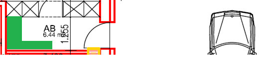

Addendum on the Pantry
We plan to use this as a “hidden” pantry, accessible through the kitchen front. The room is intended primarily as a pantry and not as a utility/mudroom. We want to mainly use the door to the garage to bring groceries inside via a short route from the car/garage directly to the pantry, instead of through the main entrance. If necessary, the passage can also be used occasionally to access the utility room. The main entrance to the house will remain the front door, not the garage door into the pantry. We have sketched a possible furnishing. The room is only partially usable but is mainly intended to shorten the route for heavy groceries.

That is very little storage space in the pantry. Actually, it’s so limited that the pantry ends up being wasted space since you still have to store items in the kitchen.
The distance between the shelf (green) and the corner near the kitchen door seems to be about 70–75cm (28–30 inches) by eye. I consider that too narrow to comfortably pass through when carrying groceries (shopping bag on the left, shopping bag on the right).
I would either make the pantry a proper pantry or leave it out entirely. Half-measures rarely lead to good results.
