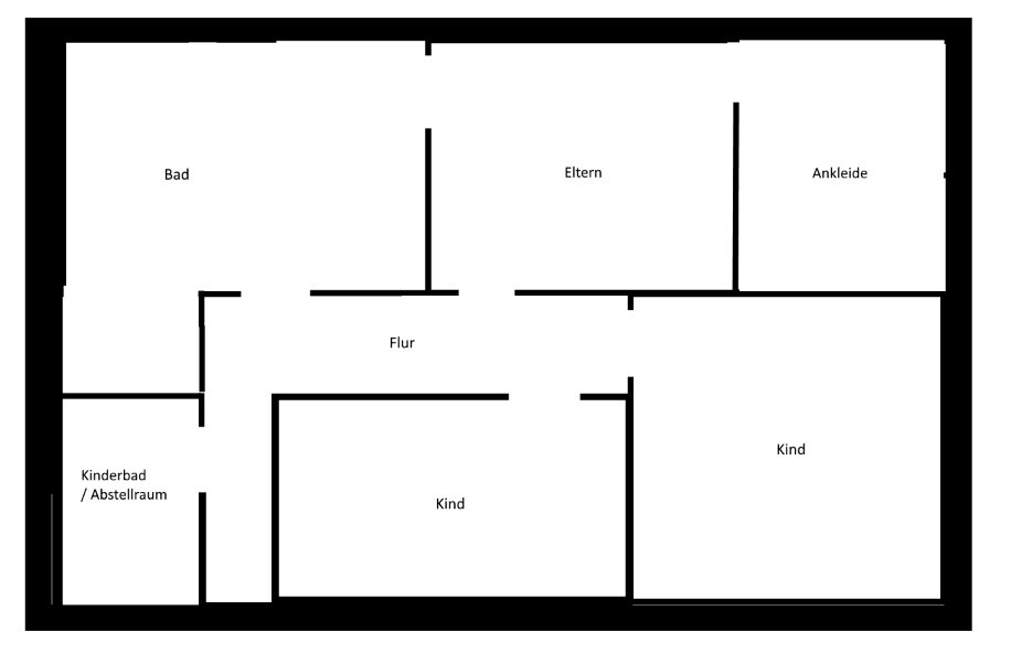

Ysop***
26 Dec 2021 08:57
As I see it, the air space above would be completely sealed off, right? Somehow, I can't imagine that working well. On the other hand, open air spaces have sound issues. I would simply enlarge the dressing room at the top and enjoy the extra space 🙂
Z
zizou89
26 Dec 2021 09:29
You are absolutely right. Air space is now living space. On the upper floor, I have enlarged the bathroom a bit. Previously, it was too elongated. The only issue I still see is that I can't place the walk-in closet next to the bathroom. That would be more practical. If I swap the walk-in closet with the master bedroom, then the only way into the bedroom is through the walk-in closet. That won’t work. Extending the hallway is also not an option because then the right children's room becomes too small. However, having the children's room partially directly adjacent to the master bedroom isn’t ideal either, in my opinion. Does anyone have any ideas?
