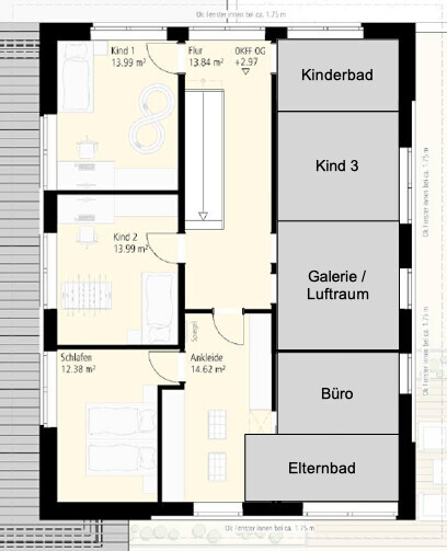

I would now like to have an open space above our kitchen. Not an open gallery, just a void space. For this, I wanted to share our current floor plan and my ideas with you and hope for some helpful feedback.

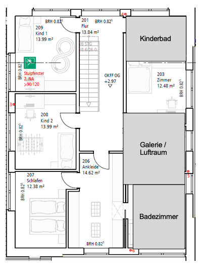

I think this change to the upper floor results in about -10 or so... because you should consider the room sizes more carefully.
In your original version, you have rooms; with the gallery, you get small storage spaces. In the original version, there’s still the possibility of combining Child 3 and the office into one room, but with the gallery, you’re locking in small tiny rooms and two narrow bathrooms.

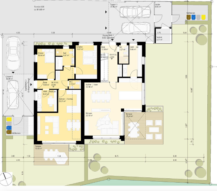

Otherwise, I quite like the floor plan, but I would consider adjusting the sofa position — perhaps putting the L-shaped sofa into the bottom left corner of the living area, and maybe starting the partition (half-height?) separating the dining area along the wall on the left. That way, when sitting on the sofa, you’re not directly in the line of sight from the entrance door. Also, from the sofa, you get a better view towards the window.

d.spinneker2 Jul 2020 07:09I don’t necessarily agree about the clattering of dishes, since it’s not a traditional gallery but rather an enclosed upper floor with only 2–3 windows.
The point about the rooms upstairs is probably true. The bathroom, etc., would definitely be affected. Another idea could be to remove the office entirely and set it up in the third bedroom. If another child arrives (which we don’t currently expect), a desk could then be added to the walk-in closet. The walk-in closet is quite spacious. I’ve attached the idea again.
d.spinneker2 Jul 2020 07:11We have already considered the idea with the couch as well.
We might lower the living area by one step and then separate it from the dining area with a half-height room divider.
