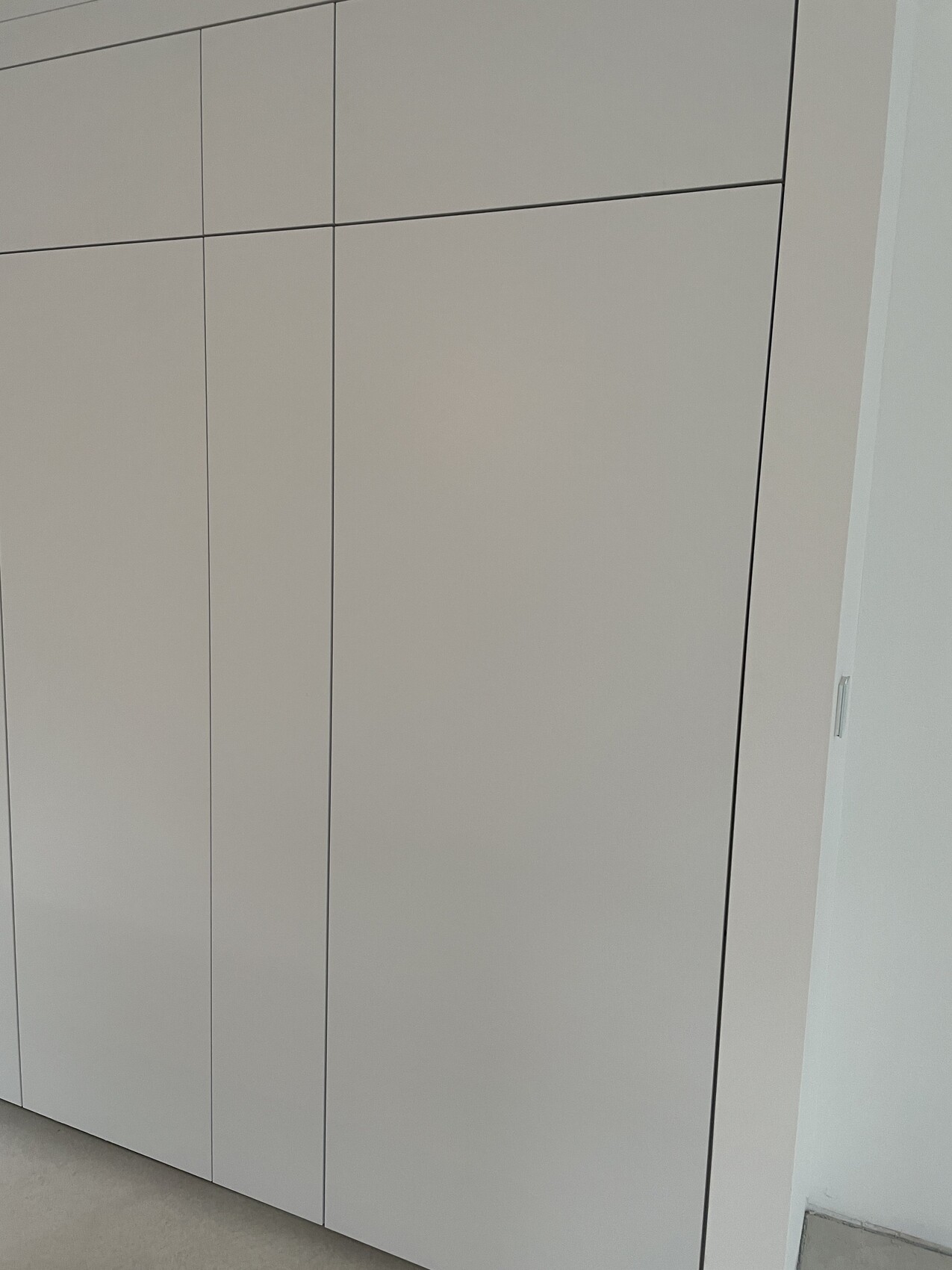

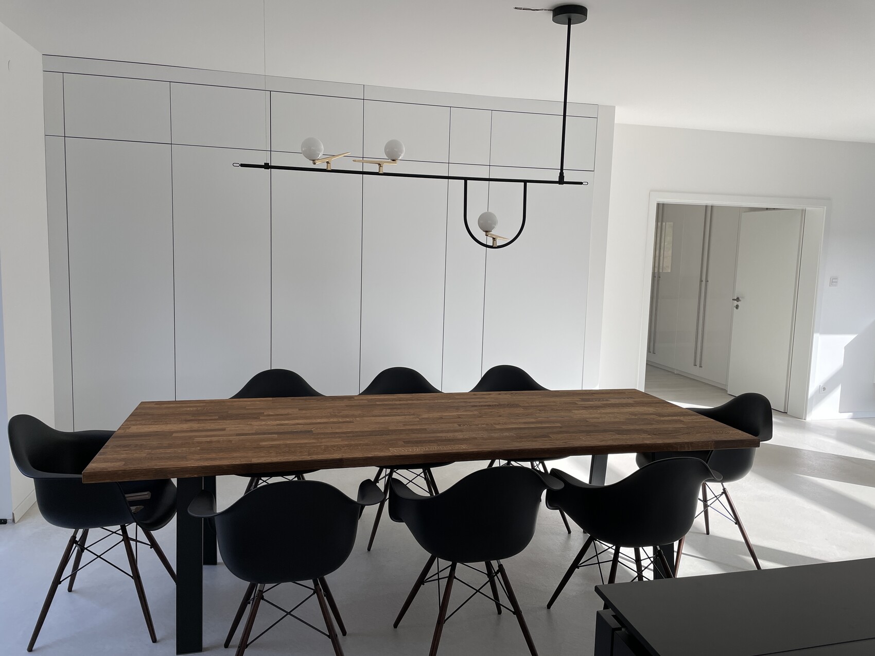

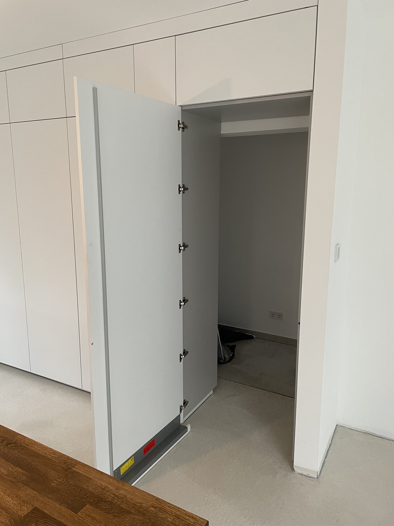

We have been using a door like this (80 cm (31.5 inches) wide, handleless) for our pantry for 5 months now. Overall, I can fully recommend it, although it definitely depends on your needs. You won’t be fitting a baking tray through there 😉
Drink crates and similar items are no problem, and unattractive appliances like the microwave or cordless vacuum can be stored ready to hand but out of sight.
The different door widths (4x 50 cm (20 inches), 1x 20 cm (8 inches), 1x 80 cm (31.5 inches)) don’t bother us.

The different door widths (4x50cm (20 inches), 1x20cm (8 inches), 1x80cm (32 inches)) don’t bother us.
But that is more like a built-in cabinet in the kitchen, not the kitchen itself.

Since we don’t have the kitchen plans, that’s irrelevant for now; the discussion was about the type of door.
If the door were in the way when opened, meaning I would have to close it first to get back into the kitchen, I wouldn’t like that. Our door is also sometimes left open for a while when I know I’ll need to go in repeatedly to get ingredients, etc., or while the microwave is being used.

However, in this case, the door would be located in the kitchen, meaning it would be open. I don’t think @driver55’s comment is wrong: the idea comes to mind that you would have an open door inside the kitchen, which can be quite disturbing. In your case, the cabinet wall is placed separately.

In our case, the door will open inward into the pantry, specifically at a spot where it won’t be in the way or cause any obstruction. This way, the door can also remain open for a longer time.
This is possible with Leicht cabinets, but with Häcker, an inward-opening door was not an option.
