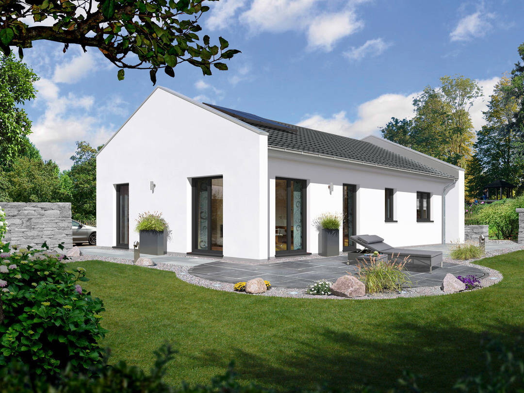

So, in the two photos posted, the shed roof has a pitch of about 8%, and the hip roof about 20%, with roof tiles, which a shed roof does not have.
So your comparison is off. ?.. he’s not really making a comparison. He’s right: it depends on the pitch.
Your photos don’t really matter, since you just pulled them out as examples.
These are two completely different types of houses.

However, my pictures from post #9 are not sample images from a Google image search, but exactly the two house types that I can choose from at a fixed price. These types of houses are not individually customized for me, which is fine with me.
Of course, I could commission an architect to design everything completely differently, but then it would exceed my budget planning.
chris909 schrieb:
Only my pictures from post #9 are not sample images from Google image search, but exactly the two house types I can choose from at a fixed price. These types of houses are not customized for me, which is fine with me.I hope you don’t choose your wife the same way: “Which hairstyle should I pick? Short hair means more frequent trips to the hairdresser... The inner qualities don’t have to match mine...”To address your examples, you mentioned that the shed roof in this case has no tiles. What type of roofing material is used then? Aluminum? Bitumen? The kind of roof covering might have a greater impact on durability than the pitch or roof shape. Personally, I would find a metal roof too noisy in the rain. With bitumen (even at an 8° (14°F) pitch), I would be concerned about durability and wouldn’t find it very attractive. If a hip roof is too traditional, how about a gable roof with a fire wall? In my opinion, it looks modern and not so “conventional”… (I’m writing this while under a very conventional hip roof with a 23° (41°F) pitch).
