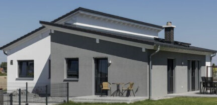

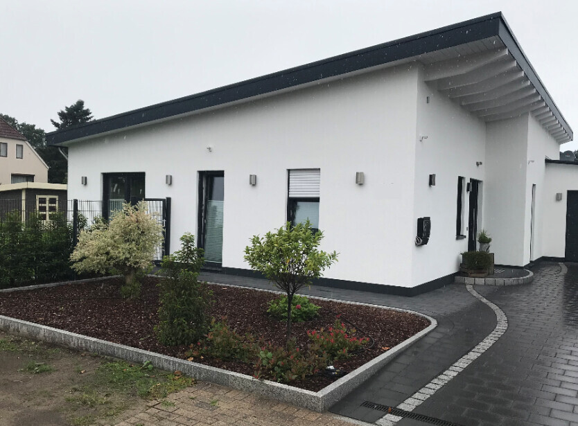

The shed roof house would look something like this (only the roof would be 50 cm (20 inches) lower):

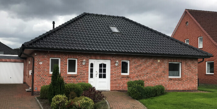

In contrast, a Dutch hip roof:
Single-family house made of red brick with white door, garage on the left, well-maintained front yard
