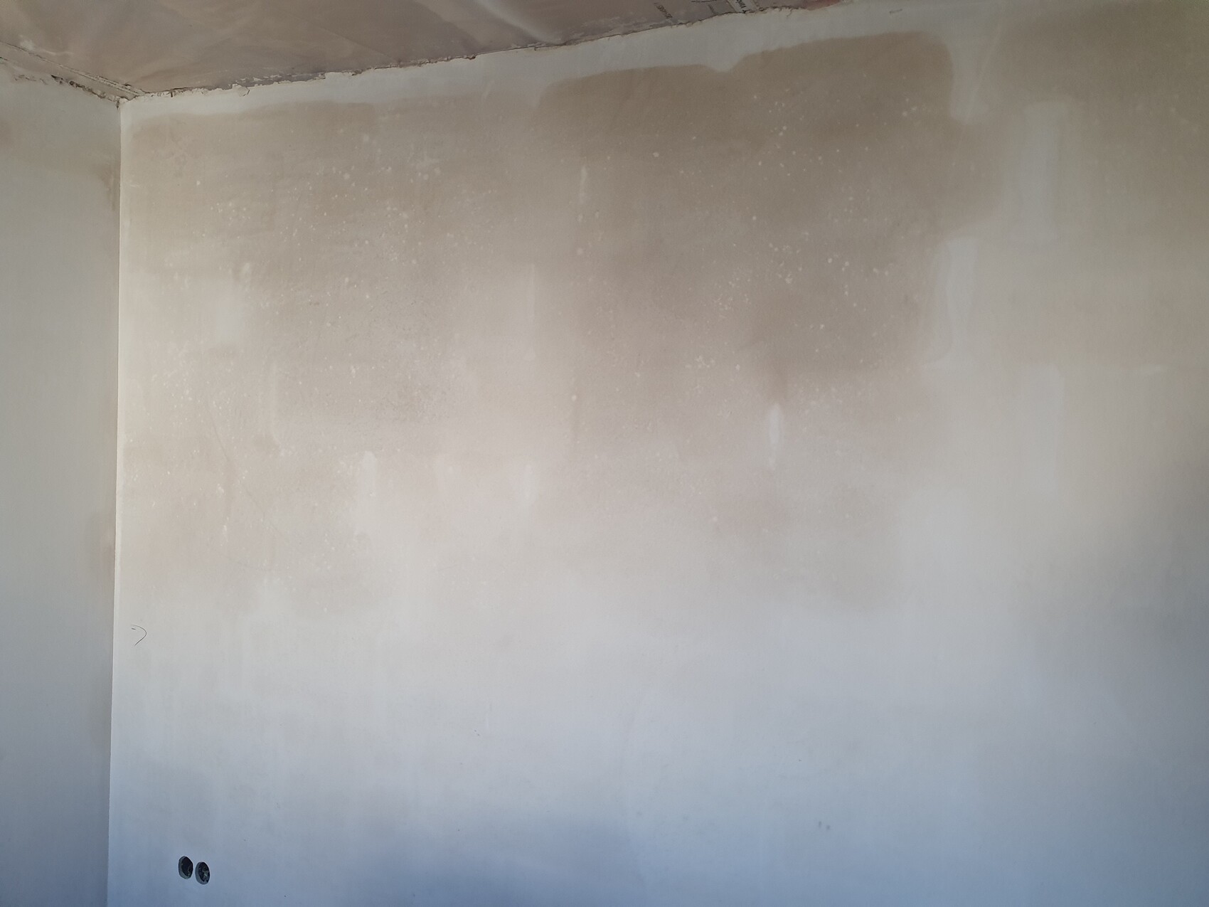

Currently, we have five dehumidifiers running for two weeks. The rental cost is 50€ per day plus electricity.
What is your opinion—does everything really need to be 100 percent dry before painting? There are still some damp spots on the interior walls and around the lintel area.
The electricity costs for the heat pump so far amount to only 350€ according to the internal meter. Currently, it’s about 5€ per day at a room temperature of 35°C (95°F).
What kind of paint should be used? I would only paint in areas that are dry. That way, you can at least get started. Otherwise... it’s better to wait a few more days now than to deal with peeling paint and mold later.
