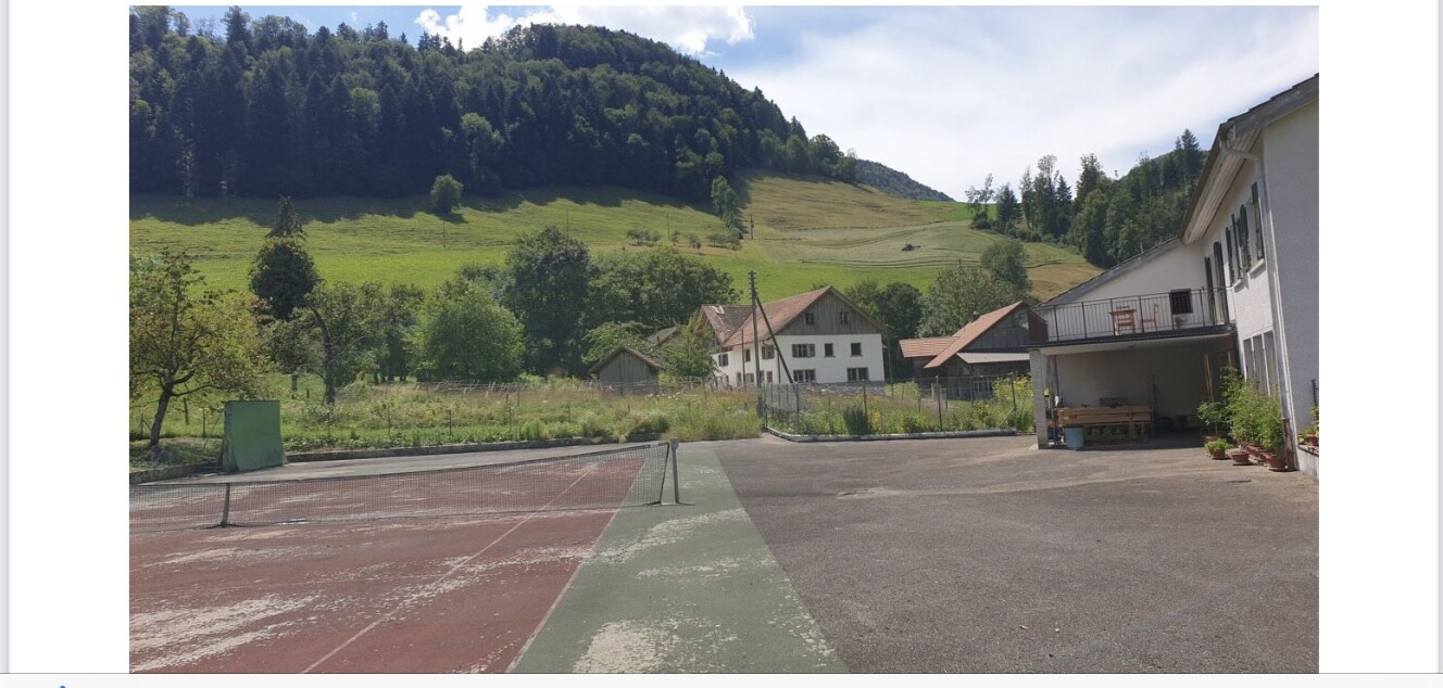

Snowmonkey18 Jan 2021 12:50Thank you for all the suggestions. I also think that building up the ground is a really good idea. We would just need to create a step for the area in front of the house, which I would leave concrete (see image). The idea of having a pool has also crossed my mind. However, it does cost quite a bit. I have also considered maintaining it. Playing some tennis outdoors in the garden during my free time would be nice too.. 🙂
The area just doesn’t look good anymore. I’m not sure how expensive or labor-intensive a new paint job would be. I’m happy to receive any advice.
