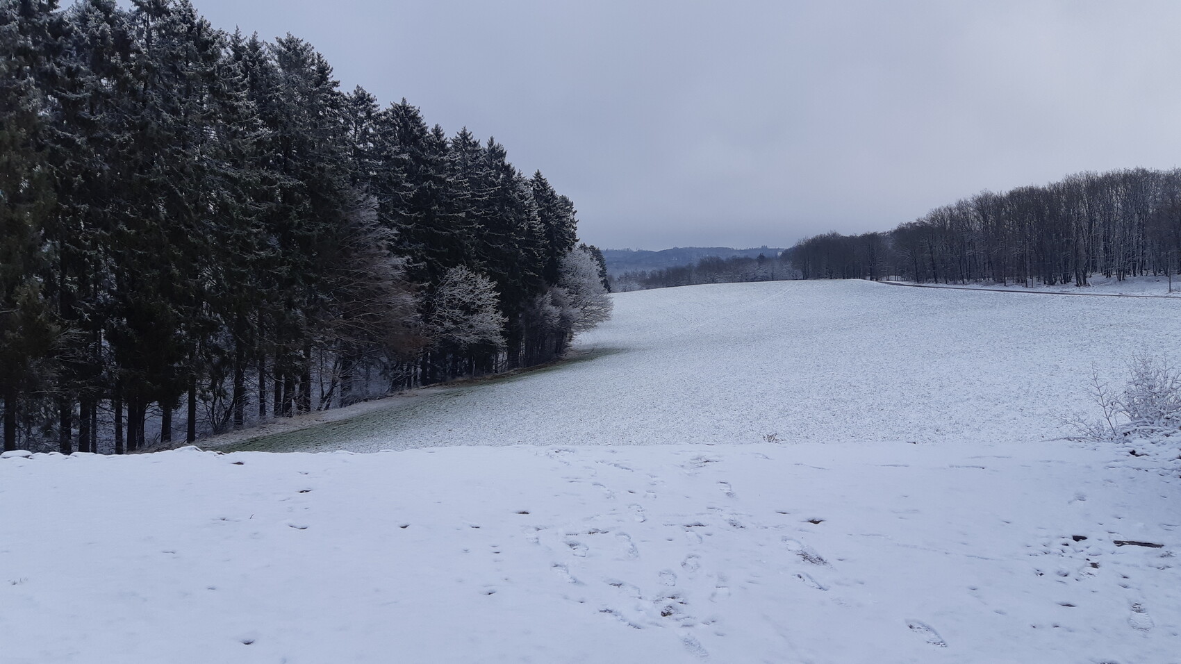

The picture clearly shows what else is coming regarding the usability of your plot. The land also costs per square meter, and every unused part is wasted. Embankments, etc. But obviously, we’re talking past each other. All good.
What else is coming? Mulch for the slope and the wooden terrace above it, as I already mentioned. That certainly won’t cost 90,000. We’re only talking about my plot now: by adding embankments, I even gained 4 m (13 feet) of flat usable space along the back boundary of the property ;-)
sergutsch schrieb:
By raising the ground level, I even gained 4 m (13 feet) of flat, usable space along the rear property line ;-)... and from the raised plateau, a view of "trees without lower trunks," and because there isn’t much space to run out, the sled needs very good brakes ;-(https://www.instagram.com/11antgmxde/
