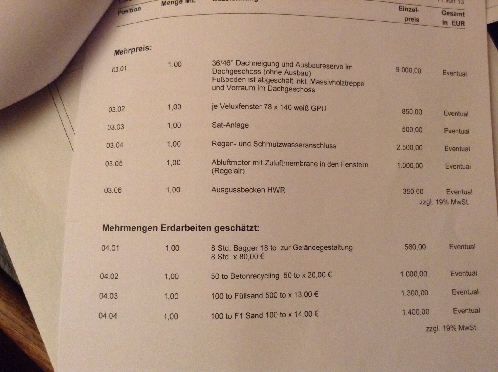

Timo1234525 Mar 2017 10:46But I am gaining some insights and can better adapt to the situation. However, you are right about the 80 cm (31 inches) excavation depth for the foundation slab; looking at the area, it might actually be accurate. It is only 1.5 m (5 feet) in the middle section. I assume that when the old house was demolished, the basement pit settled a bit.
I was just hoping to get a rough idea of whether I should expect around 5,000 euros or 25,000 euros.
