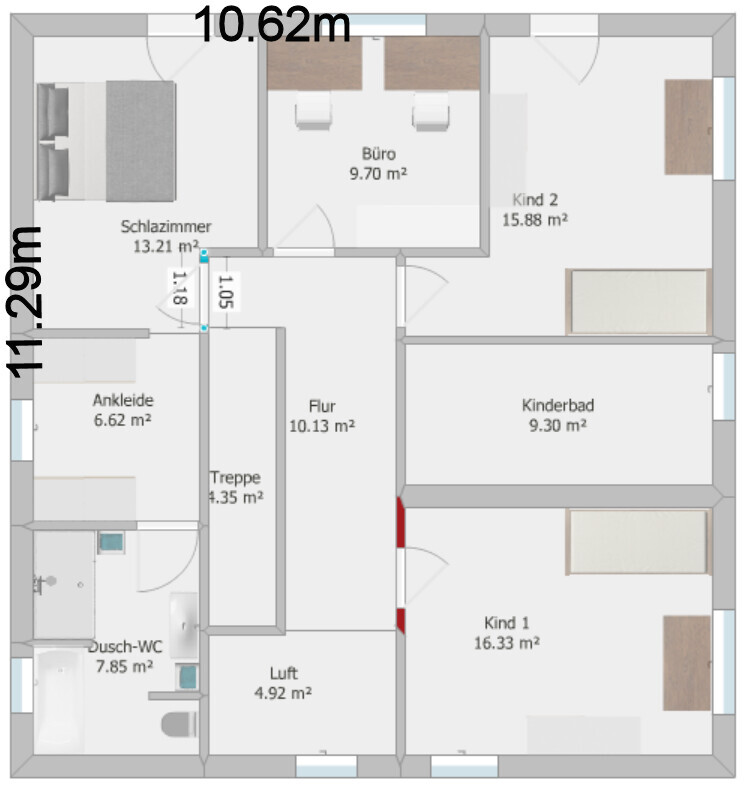

we have purchased a plot of land in a rural area of the Eifel region and plan to build a house there next year. We would like to discuss our floor plan with you and already have some questions:

So much for the plot and the planned position of the house. However, the main focus of this thread is the floor plan itself, and we would like to hear your feedback!

Could the room layout be optimized for use after the children have left home?
How and where can a canopy for sun protection be added on a terrace in front of the house without blocking natural light inside?
Attached are the ground floor and upper floor plans, as well as a photo of the plot and the site plan.
Many thanks in advance for your effort and input!

Nice-Nofret27 Sep 2020 13:07What can you say about a floor plan where the walls are shown without dimension lines?
Are at least the furniture pieces marked with realistic measurements?
For example, the dining area should be no less than 3m (10 feet) wide; if the storage room is also intended to hold a freezer or something similar, then the room must have a clear width of at least 130cm (51 inches), etc.

The furniture dimensions are realistic; I have re-added the external measurements—I’m not sure why they disappeared. The program does not display the dimensions of the individual interior walls. However, I am happy to consider alternative software suggestions.
One more thing: Can I edit the original post? I would like to update the images directly there.

kaladrial27 Sep 2020 17:23Yes, it would be facing southwest.
Alright, I’ll see when I can manage to add dimensions for the interior walls to the plan and then post it here again.
Thanks in advance!
