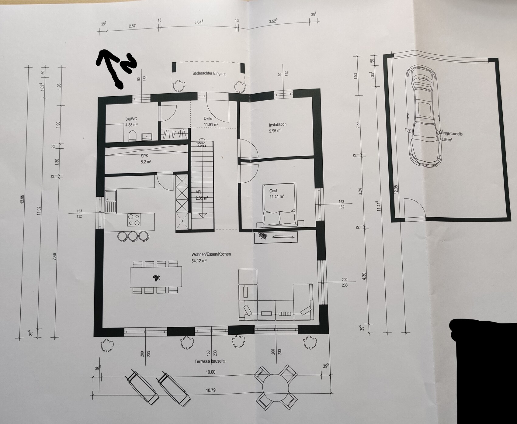

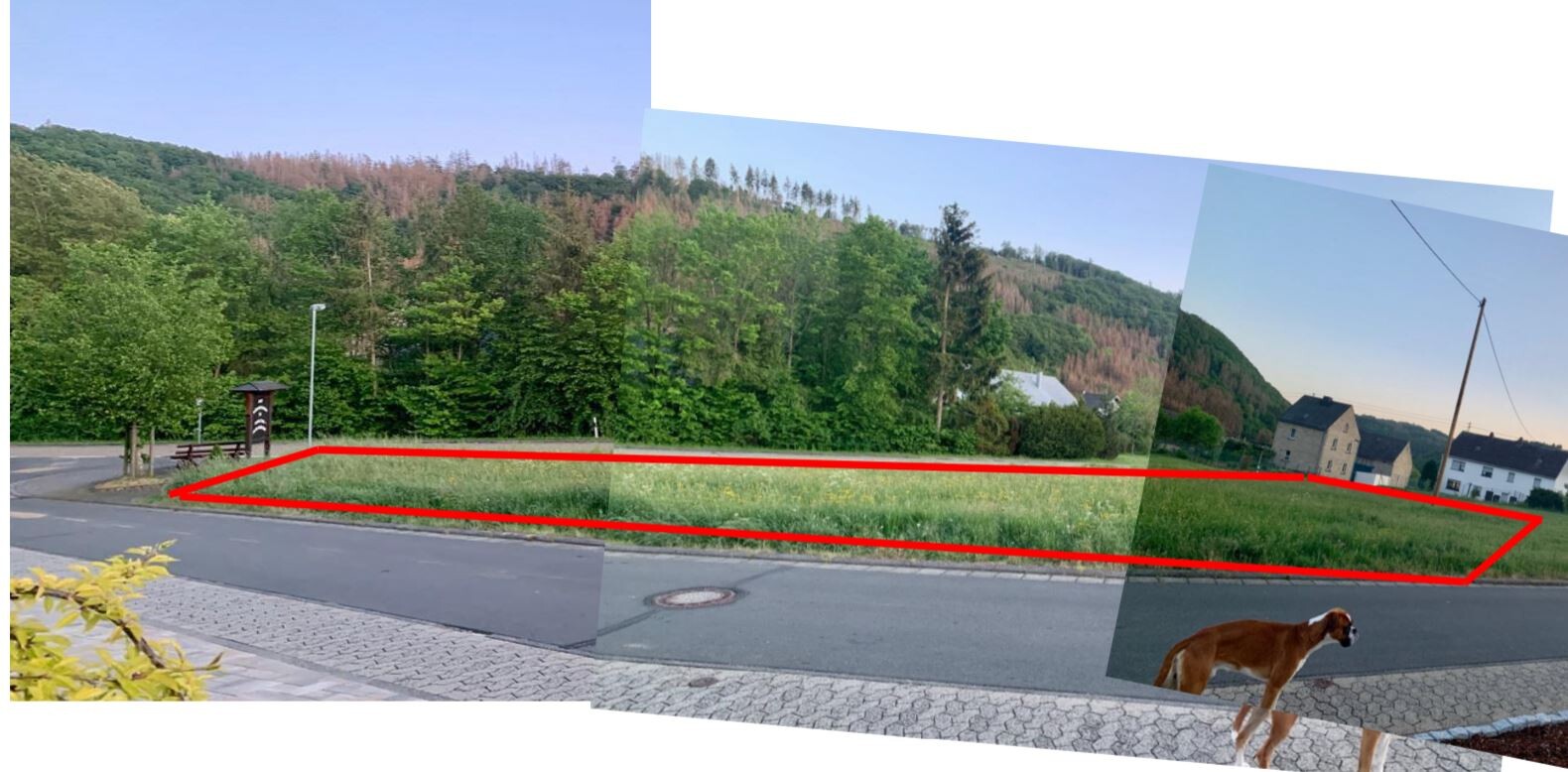

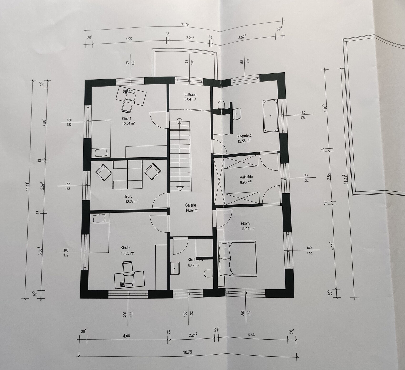

we have purchased a plot of land in a rural area of the Eifel region and plan to build a house there next year. We would like to discuss our floor plan with you and already have some questions:

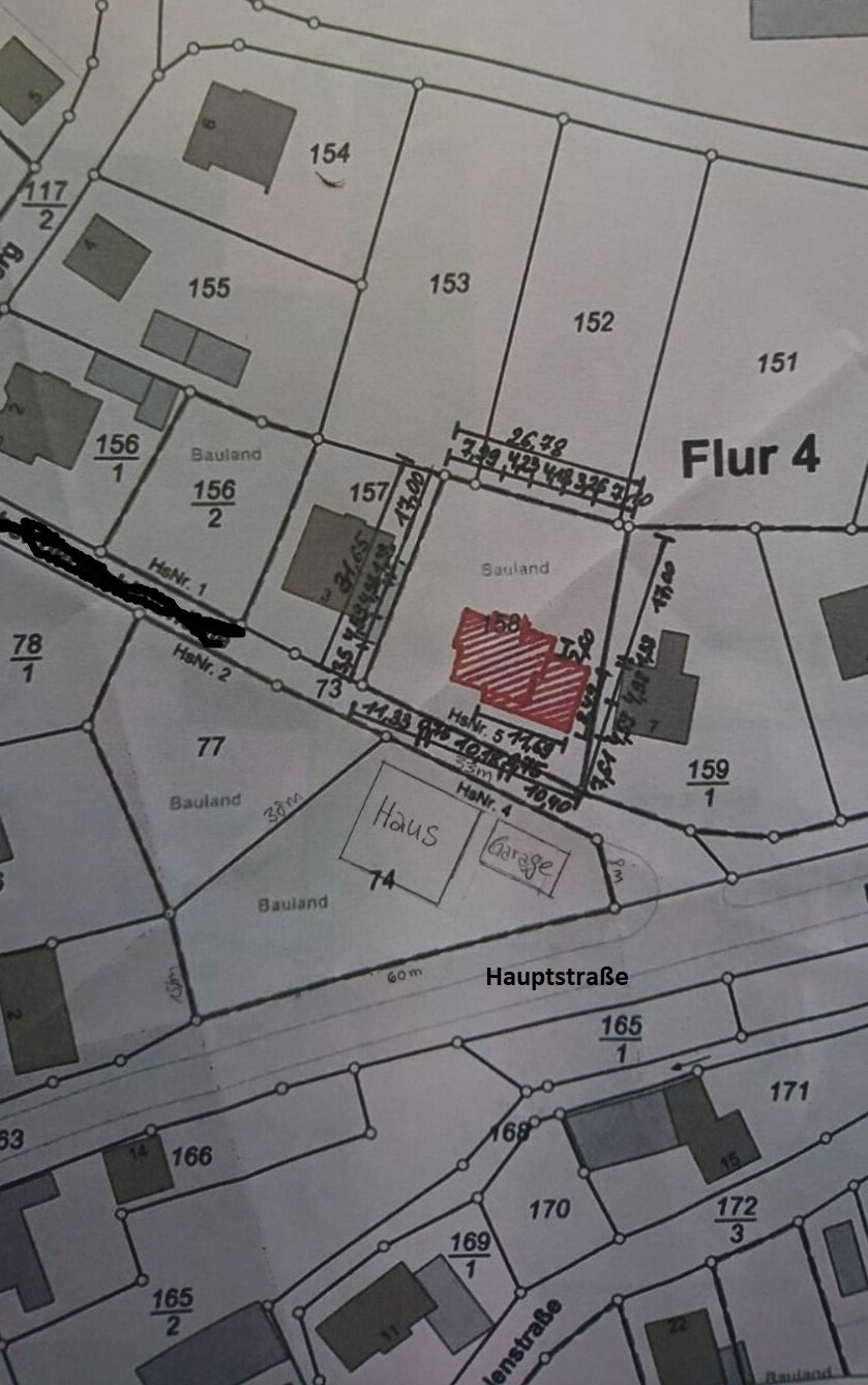

The location of the house on the plot is shown in the site plan: this would be parcel 74. The house marked in red belongs to my brother.
How can the site be leveled (retaining walls etc., approximate costs)? The land has not yet been surveyed by us, so we don’t have exact measurements, especially regarding the elevation difference. Roughly estimated, there is a difference of 3-4 meters (10-13 feet) between the highest and lowest points of the plot. We are quite in the dark about the additional construction costs, particularly earthworks.
So much for the plot and the planned position of the house. However, the main focus of this thread is the floor plan itself, and we would like to hear your feedback!
Here are our initial questions:
Further considerations:
Could the room layout be optimized for use after the children have left home?
How and where can a canopy for sun protection be added on a terrace in front of the house without blocking natural light inside?
Attached are the ground floor and upper floor plans, as well as a photo of the plot and the site plan.

kaladrial schrieb:
The main question would be which house design best accommodates the slight slope. In the current floor plan, we are almost always nearly square.Please show the floor plan. Are you sure that you are allowed to enter your property from the "main road" or from the junction of Sch*******le onto the "main road"?https://www.instagram.com/11antgmxde/
kaladrial10 Nov 2020 12:11Until now, I was not aware that there are restrictions regarding the driveway connection. I assume that a certain distance from the main road must be maintained?
You will not be allowed to drive onto the property directly from the main road itself, as there is a cycle path in front of it.

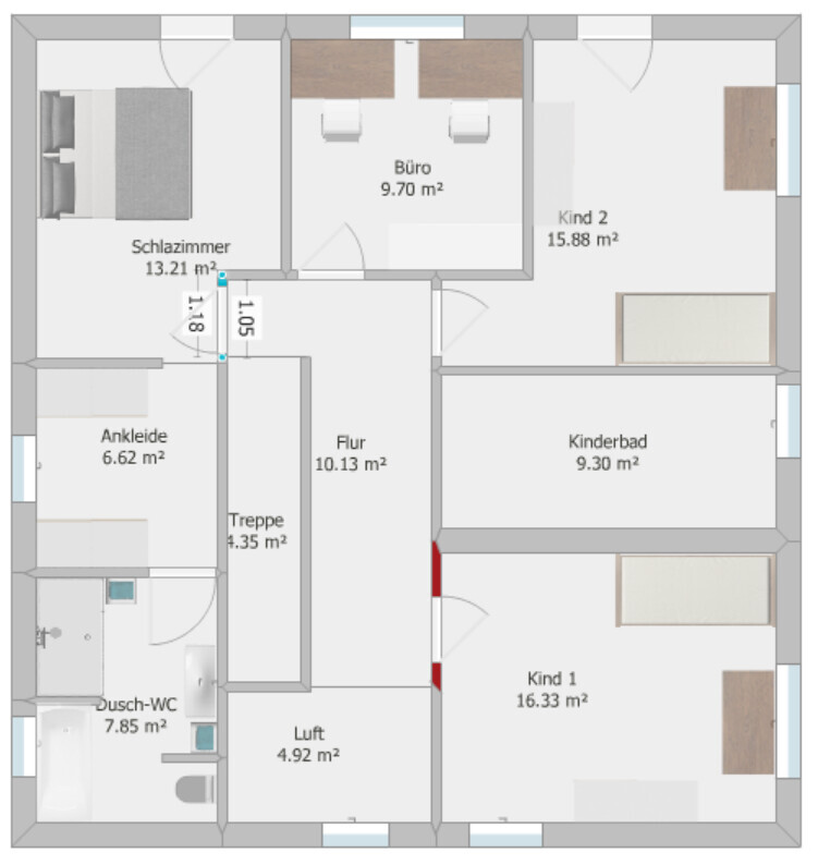

I have attached the current floor plan: however, the master bathroom will be changed. The door to the hallway as well as the guest bathroom will be removed.
In post #18, you confused me with the different drawings of the house and garage in the "site plan" and the "house orientation." After your note about not taking the scale too literally, I still assumed the site layout was accurate. It looked as if the garage was supposed to be accessed from the "tip" at the entrance (but that wouldn’t work anyway, since the strip with the bench and the "Welcome to Dingsda" sign separates your property from direct street access). From the dead-end street (= obviously a private access road) as shown here in the floor plan, I don’t see any problem. At the other location, there could have been a "visibility triangle" restricting access (and I had assumed the "main road" to be a rural road).
kaladrial10 Nov 2020 21:17Ah, I see! That means all your assumptions are correct; the main road is a lightly trafficked country road.
We welcome any suggestions regarding the elevation profile and, accordingly, the house design if anyone is interested! 🙂 In the current floor plan, the house shape is almost square, but we are generally open to considering other shapes—we just lack a bit of imagination in that regard.

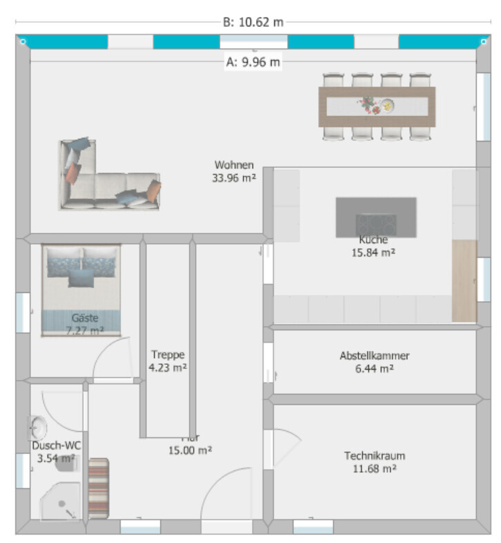

Yes, then build it that way if you want, I don’t see any major mistakes (except that the children’s bathroom will drain close to the sofa). The heights seem unproblematic to me, so integrating the house into the plot should be easy to model. I can’t assess your room dimensions and wall thicknesses. I would omit the open space (void).
This should be buildable; drainage for the children’s bathroom could be an interesting challenge.
Some thoughts, regardless of the specific conditions of the plot:
- You always walk through the rain from the garage → entrance on the side between garage and house?
- The path to the kitchen and pantry is very long.
- Cloakroom is very small.
- Long, narrow hallway on the ground floor next to the stairs, with a wall across at the south side.
- Master bedroom in the south, children’s rooms with irregular orientation.
Suggestion: remove the open space, swap the master bedroom and child’s room 1, and use the north side as the master bedroom area.
