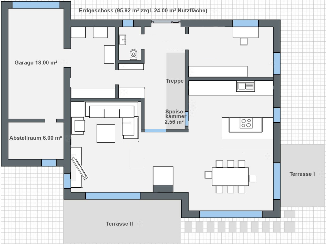

Alessandro31 Jul 2020 07:37I quite like the plan.
You just need to know where most of your daily life takes place. If you tend to spend a lot of time in the living room, it might feel a bit small to me.
But if you often stay in the kitchen/dining area, it’s more than sufficient.
I don’t see any wasted space here either.
However, due to the many windows, I wouldn’t have the option to place dressers or shelves.

Alessandro schrieb:
You just need to know where your life mainly takes place. If you tend to spend a lot of time in the living room, then for me it would be slightly too small.
But if you spend most of your time in the kitchen/dining area, that size is definitely sufficient. That’s exactly the point. We mostly only sit in front of the TV in the evenings. Essentially, our life happens outside (hence the sliding doors to the garden and terraces) or in the kitchen/dining area. By the way, the living room has exactly the dimensions of our current TV and sofa corner. That size is perfectly fine for us. There would also still be space for children...
Alessandro schrieb:
With so many windows, I would miss the possibility to place dressers or shelves. We have planned cupboard space in the utility room and the office as well as a built-in wardrobe on the upper floor. In addition, the kitchen will partly be fitted with tall cabinets. It’s also possible that the small floor-to-ceiling window next to the 3m (10 feet) sliding door will be replaced by a wall. That would give us additional space, although this area probably wouldn’t be used for a bulky cupboard but rather for a lowboard or something similar.
Basically, the main goal was to define the floor plan size so we could proceed with the calculations and planning. It was important for us to see that we can fit all the rooms in the desired sizes into about 180 m² (1,940 sq ft). Otherwise, we would have had to start over.
Thanks to all of you for the discussion. Of course, there will be an update when we move forward!
First of all... it’s your (or your family’s) house. That means you should build it the way you like. So, I can only give you my opinion based on the floor plan.
The opinions you get here are usually quite objective because no one knows you, so in principle, no one really cares how you build. Maybe a little subjective at times, if personal experience or one’s own floor plan influences the feedback. And as you can see, there are different opinions.
Right now, I just think you might be fooling yourself a bit because your furniture layout in the living room is unrealistic.
3.8 meters (12.5 feet) is okay for the depth of a living room. But no more than that. It only works if you put an L-shaped sofa on the left side of the plan.
The way you furnished it won’t work at all. By the way, my living room is currently 3.7 meters (12 feet) deep, so I can estimate that measurement well.
Common mistake 1: Sofas are often placed right against the wall in the plan. Do you do that? Besides the fact that it’s not recommended for ventilation reasons, it also looks strange. So slide the sofa 15-20 cm (6-8 inches) away from the wall.
Common mistake 2: The sofa dimensions are unrealistic. I didn’t measure yours, but it looks very small. Of course, it depends on the sofa, but a sofa is usually about 90 cm (35 inches) deep. Sometimes a few centimeters less, sometimes more if it has adjustable headrests or similar. The same goes for width. Often, two-seaters are drawn as 1.5 m (5 feet) and three-seaters as 2 m (6.5 feet) in the plan. With armrests, I’d budget about 2 m (6.5 feet) width for a two-seater.
So now add it all up:
Distance from wall: 0.2 m (8 inches)
Sofa depth: 0.9 m (35 inches)
Sofa width: 2 m (6.5 feet)
Total: 3.1 m (10 feet 2 inches)
You still have 70 cm (28 inches) left. That’s where your TV stand goes. If it has drawers or doors, depending on its depth, it could be quite tight.
Adding a coffee table will make it even more cramped.
For me, 3.8 meters (12.5 feet) is not deep enough for furniture layout. It might work, but just barely.
Furthermore, there is no window in the living room. Yes, there is a large terrace door at the bottom of the plan, but it’s far away and doesn’t really feel like part of the living room. There are layouts where the dining table would be placed there.
Now, where I agree with @Alessandro is that I don’t know your priorities. If the living room isn’t important to you, that’s fine. But for me, it doesn’t fit proportionally with the rest. You are building about 180 square meters (approx. 1937 square feet, I didn’t check exactly) with 59 square meters (635 square feet) for the open-plan area, and the living room effectively gets about 12 square meters (129 square feet). That’s too little for me.
You have somewhat disguised it with a plant and an armchair in the corner, but I still see empty, unused space — unlike @Alessandro.
I already showed this graphically.
Another point is the panoramic fireplace. I’m out of the loop price-wise, but with installation and safety plates (or whatever it’s called) and everything, that probably costs you around 20k, right? That’s why it gets a seemingly “prominent” position. Sure, it’s a panoramic fireplace, but the main viewing axis is “in front” of the fireplace. And there’s nothing there. Only around four and eight o’clock do you get sight lines to the dining table or corner armchair. Where I would expect to enjoy the fireplace most, on the sofa, is already at about 10 o’clock.
That means the space between four and eight o’clock would be the “best” spot for me. That’s probably about 10-15 square meters (108-162 square feet). But there’s nothing there.
Maybe I just don’t know enough about how you use the space, and you’re leaving it free so your parents can stretch out naked on a big bearskin rug in front of the fireplace when the kids have moved out.
As I said, if you feel comfortable with it, that’s great—go for it. I just don’t like the proportions in the open-plan area, especially the living room.

pagoni202031 Jul 2020 10:19Overall, I like the plan (I haven’t read the entire development), but I would also consider placing the fireplace on the exterior wall between the living room and dining room, and perhaps orient it sideways rather than facing into the room. Depending on the model (which might still change), you could even think about a stylish external chimney, which would allow you to avoid a bulky, masonry-built fireplace inside the house. As far as I know, there are models that allow an outdoor fire pit or firebox to be connected, if that’s something you want.
In my opinion, 3.80 m (12 feet 6 inches) is really narrow, especially since the space is enclosed on three sides by walls. Maybe you could avoid having the wall to the hallway extend all the way to the ceiling to gain some “breathing room.” I feel the same way as @face26—the space between the sofas and the window front feels lost, and it ends up just being filled with a plant. Removing the solid fireplace from that area would reduce the sense of confinement in the living room, which I would like better overall.
Also, I could imagine relocating the planned storage room near the garage somewhere else, or possibly placing a modern garden shed or similar structure there instead. This would open up the option for additional windows along that long wall—even if just clerestory windows or a strip of windows.
