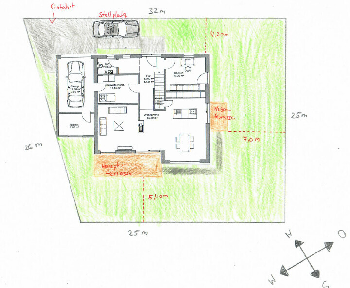

First, here again is the site plan (the arrangement of rooms is very old; this is just about the placement of the house on the plot):

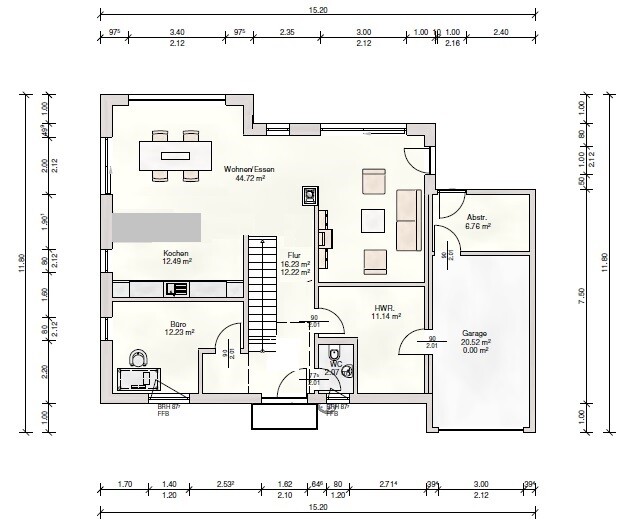

Let's start with the ground floor: the office and multipurpose room should face the garden. The utility room must have an exterior wall due to the air-to-water heat pump. We would like a small, cozy living room corner, and the kitchen should be directly adjacent to the dining area and breakfast terrace. The rest is distributed accordingly.
The staircase position is also fixed to meet the requirements for the upper floor. Changing the stair position would eliminate direct access from the kitchen to the pantry and make access to the master area (in connection with the chimney) difficult to implement.
The basic concept of the upper floor is to separate the children's area from the parents' area. Also, the children's rooms and the master bedroom should be positioned facing the garden. The rest is distributed accordingly. My wife absolutely does not want the dressing room to be a walk-through room to access the bathroom. The requirement here is: to go directly from the bedroom to the bathroom and back.
Your criticism regarding the ratio of the living room (12 m²) to the rest of the multipurpose area (59 m²) is absolutely justified. But as you said, it is a conscious choice based on our priorities: we opted for a small, cozy living corner.
By the way, the living corner in our current apartment measures 3.00m (9.8 feet) wide and 3.70m (12 feet) deep. We based our plan on that. We really like it that way. Our L-shaped sofa measures 2.70m by 2.20m (8.9 feet by 7.2 feet) and is big enough for us plus two guests, so there is still 1.60m (5.2 feet) left to the wall. Only the TV on a lowboard will go in the corner, roughly like this:
By the way, the fireplace is not that expensive. Fireplace, chimney, and final installation cost about 12k (about $12,000).
We initially had the fireplace at that location. Somehow it felt lost and created a lot of unrest in the floor plan. Simply put: we didn’t like it. So the fireplace either stays where it is or gets removed completely—which would be a shame.
The storage room next to the garage is necessary so I can get to my tools with dry feet in winter. We really dislike clerestory and window bands. That’s one reason we opted for two full stories. My wife calls those window types "loopholes" — she’s not wrong.
1.) Beautiful living area topped by your garden. Respect! Really great!
2.) Basically, I like your suggestion. Especially your solution for office, utility room, and guest wc is simply better than the other draft, although at the expense of the living room. In this version, we would probably omit the fireplace completely. We will keep that in mind for detailed planning with the architects.
Exactly. Home cinema is not important to us. Comfort is top priority for the living room. It was already difficult last year to find a sensible TV without 60 inches.

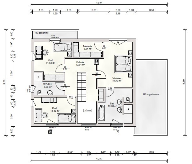

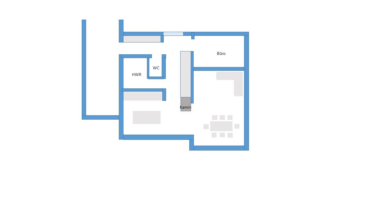

Here’s a suggestion to better utilize the unused space. Fireplace on the exterior wall, slightly less deep living area, kitchen shifted further up on the plan, giving more space for the dining table. Shift the cloakroom where it can also be accessed from the utility room. This results in a better office layout.
[ATTACH alt="Dasch17-EG.jpg"]50060[/ATTACH]

face26 schrieb:
So it’s not said that I just complain; here’s an idea from me. I like @Würfel*’s proposal a lot; mine is similar but I moved the wall to create a small covered terrace.
And you can tell I’m no good with drawing programs.
I find the furnishing by @Würfel* clearly better than the OP’s.11ant schrieb:

Advantages: short walking distance from kitchen to terrace, larger living room
Disadvantages: smaller kitchen, guest WC without window, longer walk from living room to terrace
Not sure if the chimney would fit on the upper floor in this variant as I don’t know the plan well. The chimney pipe must not be directly behind the fireplace but to the right side of the stairs.
The problem is that on the upper floor you would run into the chimney shaft. The stairs go up there.
Also, the utility/technical room must have an exterior wall.
Switching living room and kitchen is unfortunately not an option for us.
Woulda, coulda, shoulda...
You could have resolved that in #115 as well.
You could have done that. Now you have a pantry that is not walk-in... a proper chest freezer doesn’t fit anymore...
You keep forgetting to draw the wall on the staircase side. Then you’d see if you imagine a door to the utility room, the hallway (despite glass)…
You could have had 180 (square meters) if you had compressed the house depth a bit. Then you wouldn’t have had those square rooms.
By the way, I don’t see where you mirrored anything.
I think: a lot of useless space on the ground floor. The chaise lounge will be a decorative piece, and you’ll see what happens…
I appreciate your open and direct style. But that was not objective criticism, right?
No. #115 simply doesn’t work with 180 square meters (about 1937 square feet).
Why shouldn’t the pantry be walk-in? We chose to place it under the stairs consciously. The space is sufficient for us, as we have already verified in several model homes. The chest freezer will go into the utility/technical room.
