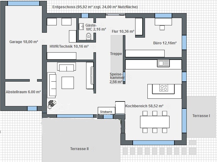

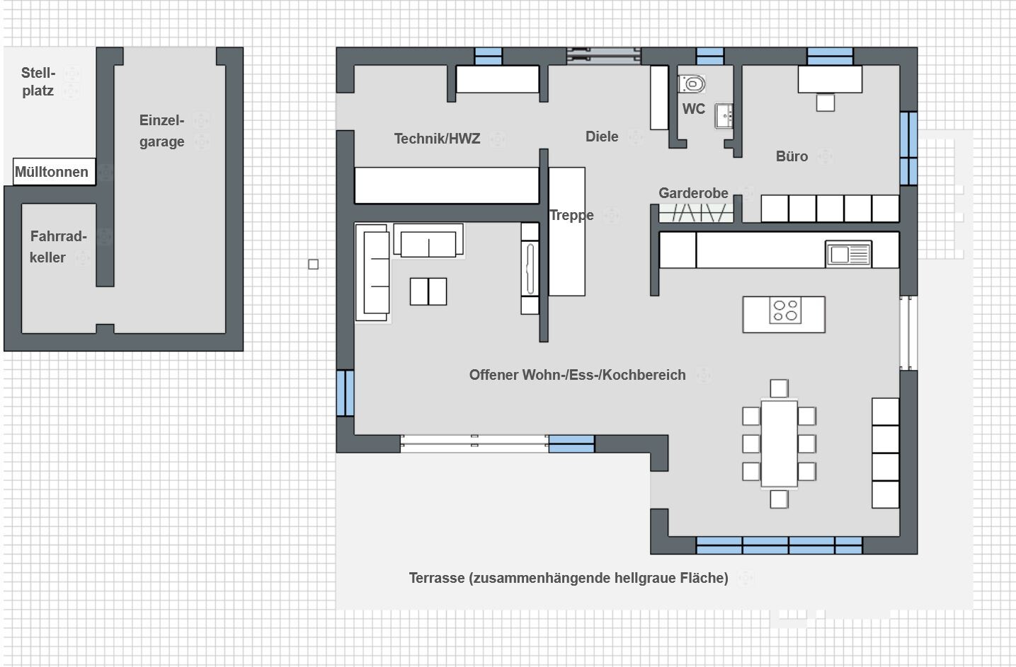

Just to show that I’m not only complaining, here’s an idea from me as well. I really like @Würfel*’s plan; mine is similar, but I have set the wall back, which would create a small covered terrace.
And it’s clear that I’m not good with drawing programs.
I think the furniture arrangement by @Würfel* is much better than the original poster’s.

pagoni202031 Jul 2020 13:55In my opinion, this stylish fireplace looks too bulky with this floor plan; perhaps a slimmer model would be better. There are certainly ways to build it more space-efficiently, or, as I have seen before, an outdoor fireplace on the terrace that can be admired from inside. Moreover, such a fireplace is used rather rarely compared to how much it further restricts the already limited space here.
With the last two ideas, I think you get closer to a good solution.
