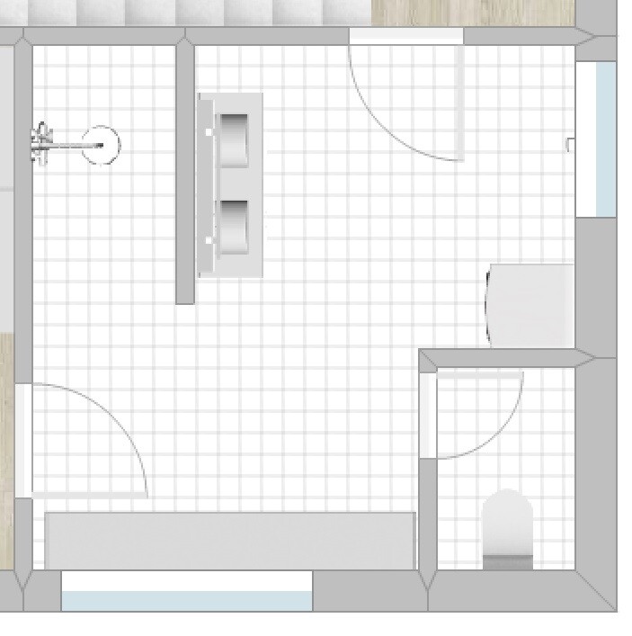

Attention, new attempt
Thoughts on this:
- The washing machine will be enclosed near the upper door, either with a sliding curtain or wooden paneling, something along those lines.
- The door to the restroom would normally stay open and only be closed when "specifically needed." Therefore, in my opinion, additional ventilation is not necessary.
What are your opinions on this?
Bathroom floor plan with double sink, shower, toilet, and doors.
kaho6747 May 2020 20:04
May I quickly ask in between: How wide and long is your staircase, and how thick are the walls? I can’t make the measurements work. ops:
Tolentino7 May 2020 20:04
For a shower-only bathroom without a bathtub, that is already quite large. Have you ever considered removing it entirely? Perhaps a separate toilet instead?
Drasleona
7 May 2020 20:10
@kaho674 So far, all interior walls are planned to be 12.5cm (5 inches) thick. However, one wall will likely be thicker because it is load-bearing. The construction specification states 12.5cm (5 inches) thickness for interior walls in general.
The staircase is currently planned to be 4.10 x 1.00m (13 feet 5 inches x 3 feet 3 inches). Do you think that’s too small? I don’t yet know the exact opening size the staircase actually needs... Right now, the entire footprint of the staircase is allocated as an opening on the upper floor, but it will probably be less than that.
@Tolentino Yes, we have considered that as well... But I think, first, it’s not very practical and, second, you would need ventilation there. Consequently, that would block potential window space for the bathroom...
P.S.: I adjusted the staircase based on haydee’s advice at the time, but I don’t think I ever uploaded the revised plan... So, the staircase in post #1 is still planned too small, sorry.
