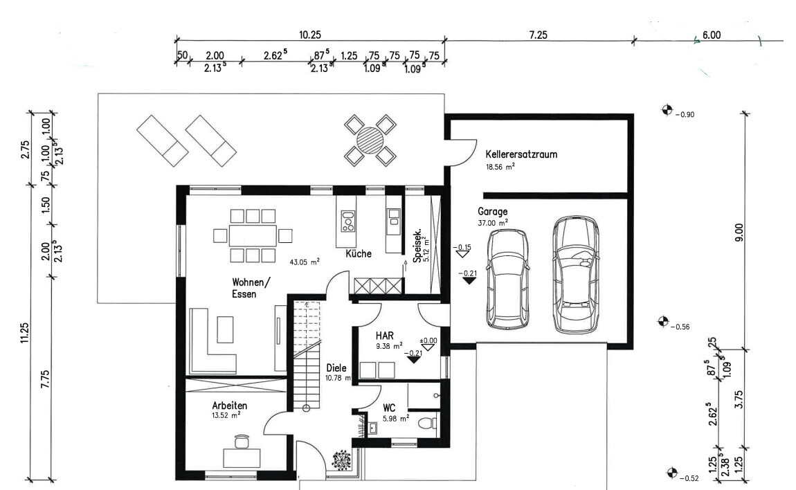

We are planning to make our dream of owning a home come true next year. So far, we have visited five general contractors and received fairly comparable initial offers from them. At this point, only two remain in consideration based on quality, reputation, price, and overall feeling.
The basic floor plan has been set from the very beginning, but we have continuously modified and optimized it and have not yet finalized a version, as we also want to keep an eye on construction costs. The attached floor plans include one initial design from the architect and one optimized version by me regarding the window placements and staircase location.
I would appreciate your feedback. Are there any critical issues we might be missing? What could be solved more intelligently? Perhaps something “unusual” that could be added quickly and without significant expense.
I am looking forward to your input!
Thank you very much!

Thank you very much for the draft. I understand many of the approaches and solutions. Unfortunately, I am quite busy traveling today and will specifically review it this evening. Thanks again!
kaho6743 Dec 2019 20:14
Here is another one with lighting in the kitchen:
Floor plan of a house: living and dining area on the left, kitchen, bathroom, utility room, stairs, garage on the right.
Floor plan of a residential house with kitchen, office, bathroom, hallway, bedroom, and walk-in closet.

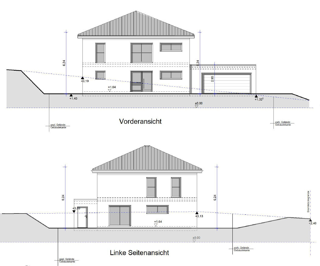

It has been quiet here for a while because I have been working on the design planning and the corresponding building permit / planning permission application. Both are now finished, so I wanted to check in again, especially since input from here was taken into account.
The entire house including the garage has been moved further north to gain about 2m (6.5 feet) more garden space on the "garden side."

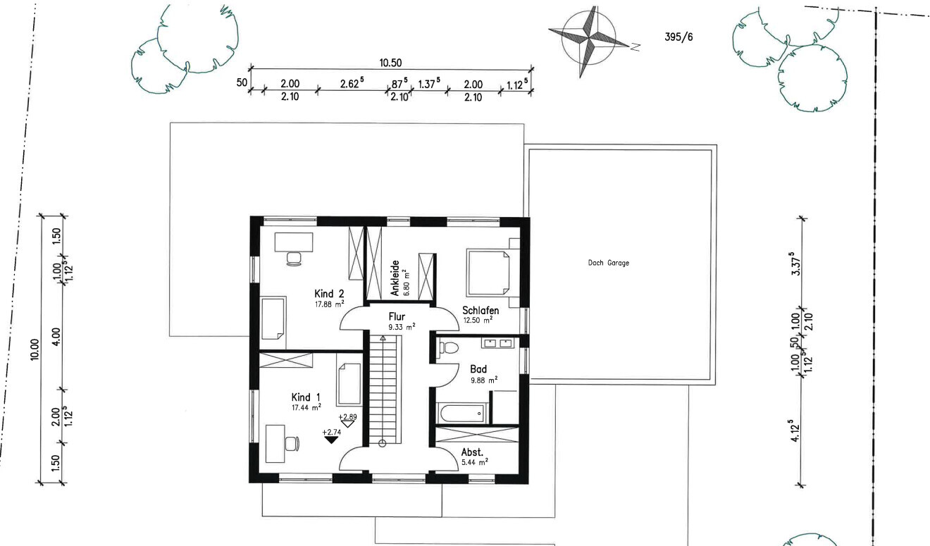

We have also changed the exterior dimensions, widening the house by 25cm (10 inches) towards the west, resulting in a wider kitchen of 4.01m (13 feet). This also allows for a better layout on the upper floor from our perspective. A small utility room was added there for the washer and dryer. The bathroom layout will be somewhat different from the current plan based on today’s bathroom design.
On the ground floor, not much has changed. We considered the connection between the garage, utility room, and kitchen several times and decided to keep it as is. The garage was intended for this side anyway because of the boundary and privacy screening toward the neighbor. The kitchen should face the back terrace, and the utility room is located closest to the supply and waste lines. In the kitchen, there is still a niche for a side-by-side refrigerator, and the kitchen layout roughly corresponds to what is shown here in the plan. The island will be placed against the wall and will be slightly larger.
The driveway is already planned and works with the slope conditions as intended.
In the meantime, we have reconsidered the heating system and switched from an air-to-water heat pump to a ground-source heat pump with a trench collector. I am currently clarifying the details with the heating engineer.
In terms of budgeting, we are still within the range we set for ourselves. (I hope I can repeat that sentence exactly in 12 months)
Now we are hoping that the building permit / planning permission under the simplified procedure will be issued quickly and that I can start earthworks at the end of February / beginning of March.
Ground floor plan: living/dining/kitchen area, hallway, WC/shower, technical room, cloakroom, garage.
Right side view and rear view of a two-story house with a pitched roof
Upper floor plan: bedroom, children’s room, office, dressing room, bathroom, utility room, corridor.
Architectural drawing of a two-story house with a pitched roof; front and left side view

Well, that already looks quite well planned. I don’t think it’s bad, although I wouldn’t do everything exactly that way. However, I have to criticize one thing: the window in Child 1’s room is really small. It is floor-to-ceiling, but to me, it’s too tiny. Don’t you want to let in a bit more light there?

Hmm ... just a few things I noticed. Unfortunately, the drawings are missing a north arrow again.
Ground Floor
  • Sofa and window with a sill height of 125 cm (49 inches)... it always gives me a basement feeling, especially since this seems to be the south side, if I have checked correctly and the drawing in the original post was oriented north.
Upper Floor
  • The hallway will be quite bright compared to Child 1’s room. For Child 1, I would choose a much wider window with a lower sill height instead. The narrow, tall window doesn’t let light spread broadly across the room.
  • You have about 20 sqm (215 sq ft) for the parents’ area but space for only a 3 m (10 ft) wardrobe.
  • The master bed, including nightstands, fits well within 300 cm (10 ft) next to the window. With just 30 cm (12 inches) nightstands and a mattress width of 200 cm (79 inches) (assuming a box spring bed), there are barely 70 cm (28 inches) left between the bed edge and the wall on the plan top side. Actually, it will be closer to 60 cm (24 inches), since the nightstand can’t be placed immediately next to the window opening.
  • The bathroom is 11 sqm (118 sq ft) for a washbasin, toilet, and shower? Still, the walkway between the basin and toilet will be relatively narrow.
15 Jan 2020 22:49
I find it clearly laid out, and if it works for you, that's fine.
However, I think the sides of the house with the windows look visually unbalanced. I would have shifted the ground floor to better align with the upper floor.
