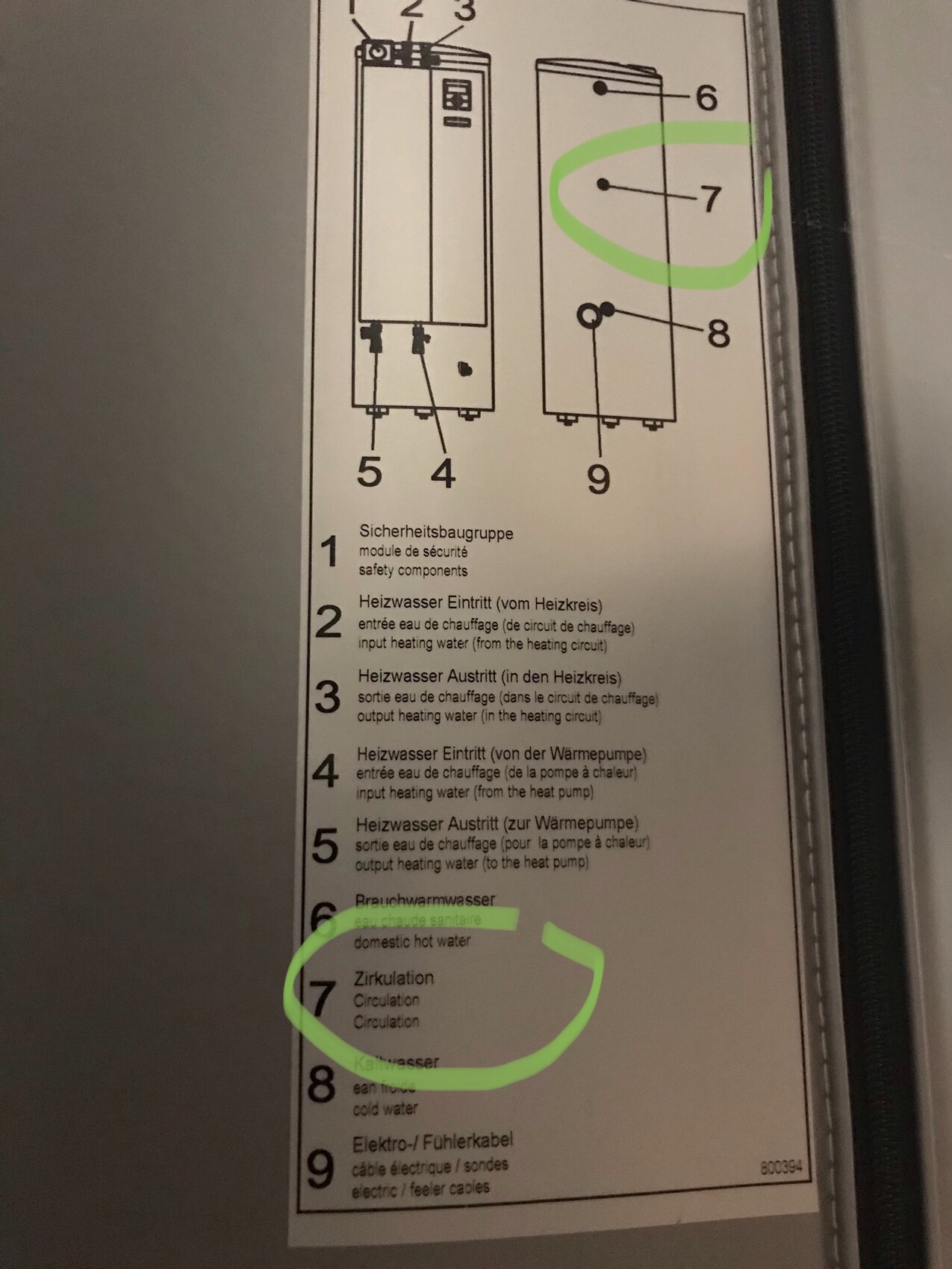

Why do you have so many domestic hot water (DHW) starts then? What temperature do you have set for the hot water? How large is your hot water storage tank? Do you have a circulation system?We have it set to 49°C (120°F). I don’t know the rest, I will find out.
Daniel-Sp22 Dec 2019 22:33If you have a circulation system, it should only operate during the necessary times; otherwise, it will continuously lower the temperature in your hot water tank.
Ic
I think we do have circulation. There’s definitely something about it on the tank, see the picture.

If you have a circulation system, it should only run when needed; otherwise, it continuously lowers the temperature in the hot water tank.
boxandroof23 Dec 2019 08:21Is anything connected there as well?
boxandroof schrieb:
Is something connected there as well?I’m not sure about that. Where can I check?B
boxandroof23 Dec 2019 09:41Where you have drawn the upper green circle, is there a pipe connected to the hot water storage tank there? How many seconds does it take until you have warm water at the faucets or the shower?
