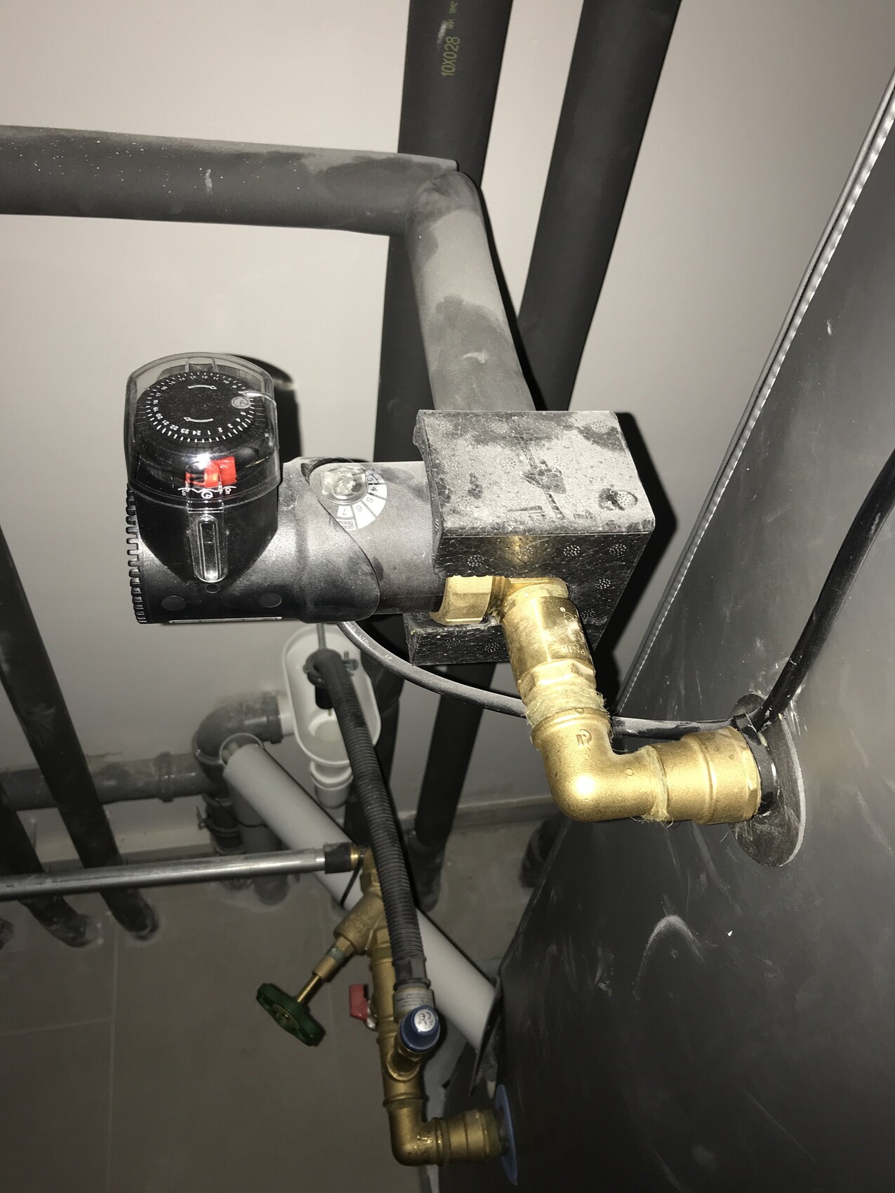

In the morning, it sometimes takes almost 1 minute for warm water to come out of the tap.
I will check the pipe later.

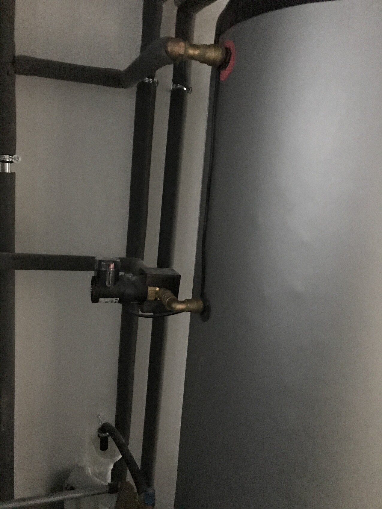

boxandroof schrieb:
Is there a pipe connected to the storage tank where you marked the upper green circle? How many seconds does it take until you have hot water at the faucets or shower? I think there is a pipe for that.
Daniel-Sp23 Dec 2019 19:16That looks like a circulation pump. What are the programmed operating times?
I just checked – it was set to continuous operation. I have now set it to a timer with specific times, will test it out.
That should also reduce the kilowatt-hour consumption per day, hopefully…
Daniel-Sp23 Dec 2019 21:17Good move, the circulation pump should run as little as possible. For example, in the evening when the children are showering or bathing. As briefly as possible, but at least once a day!
