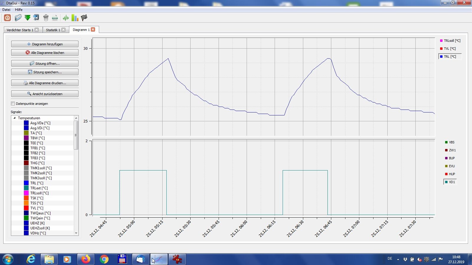

Daniel-Sp27 Dec 2019 10:53The heat pump is not yet operating optimally – it switches on and off too frequently –
due to the bypass valve.
Right after the heating cycle starts, the return temperature rises because warm water bypasses the heating circuit and flows directly into the return line. This causes the shut-off criterion to be reached too early, even though the screed has not yet absorbed the desired amount of heat. Consequently, the return temperature drops quickly after the heating cycle ends, followed by the next heating cycle. For clarity, only the return temperature and compressor are shown.

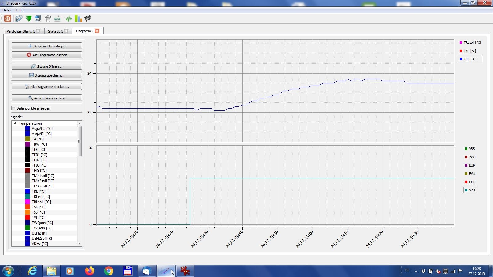

Daniel-Sp27 Dec 2019 10:55Daniel-Sp schrieb:
I have now received data for analysis.
You can clearly see the effect of the ERR here!
[ATTACH alt="ERR2.jpg"]41257[/ATTACH]Fortunately, there is a noticeable improvement. Let’s see what the building inspection will bring.
