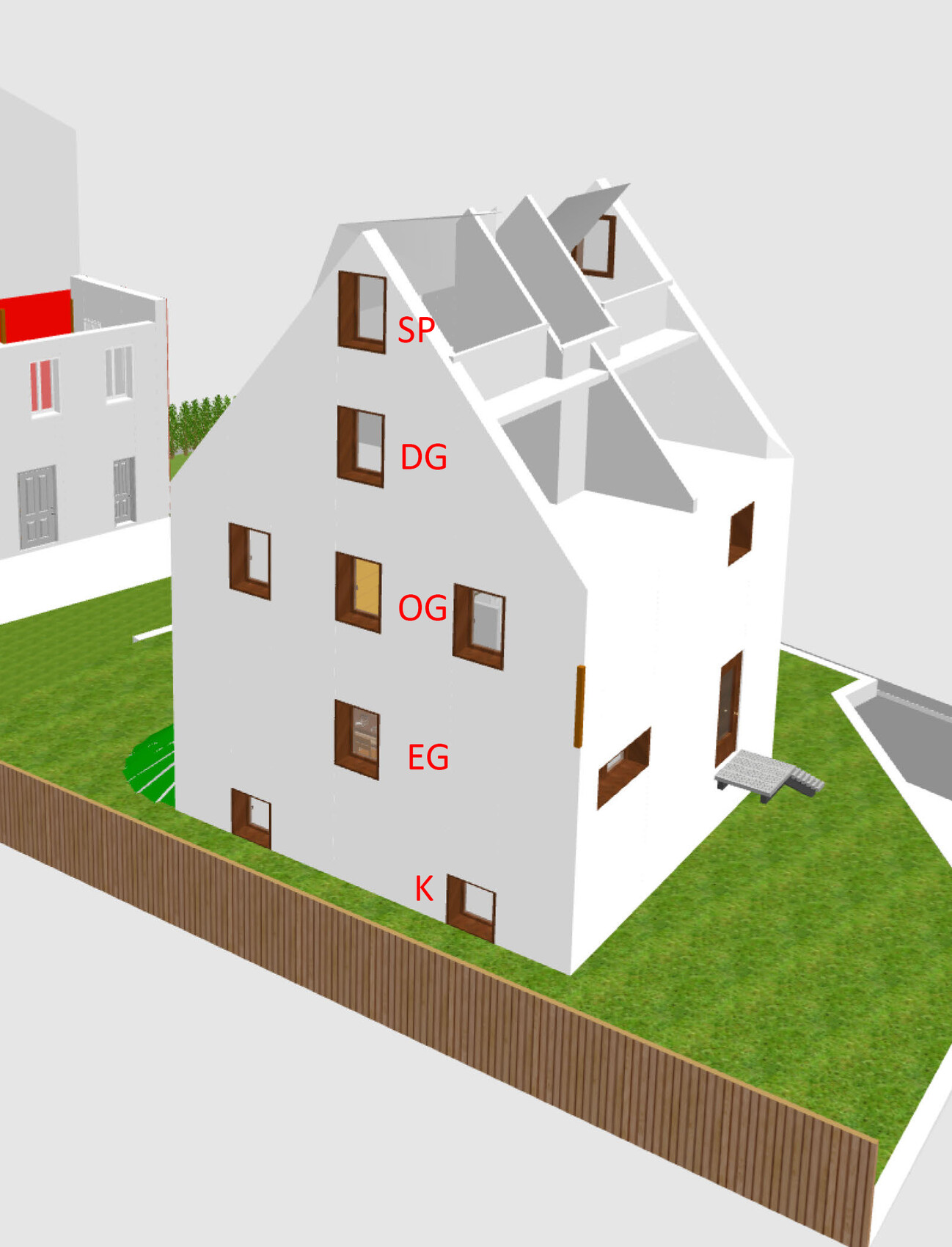

Honestly, I think you don’t really know what you want yourself. Take a look here:
That would be 5 levels. From post #79, I suspect that the attic won’t be finished and will only be accessible by a space-saving staircase (please add this to the drawing). Or does he mean just a fold-down attic ladder in the end? What exactly now? In any case, the attic is missing from the plans.
No, we are just having trouble understanding each other, which is probably due to my amateur language skills.
Thank you for the illustration; hopefully, this will help me describe it:
EDIT: (from bottom to top)
Basement (is underground or at least lower)
Ground floor
First floor I have now started calling attic
(Dormer/peak) loft
The very top part is just for me to calculate how much space would be created if I were to add an intermediate level myself. Please think of it like a kind of loft bed. Underneath, at a height of 2.35m (7 ft 9 in), there is about 6sqm (65 sq ft) with over 2m (6 ft 7 in) ceiling height. The children could really use this space for playing, sleeping, relaxing, possibly for model trains...
Edit: Since this is definitely planned, we also want to consider lighting up there, so I simply added two windows in my design software and modeled it as an extra floor. Of course, it is not really one. I would be very interested in ideas for lighting in the gable.

grericht schrieb:
I have now started calling the upper floor the attic. Your upper floor is not directly under the roof. That’s above it. So it’s not the attic.
grericht schrieb:
The very top area is just for me to calculate how much space would be available if I were to add a mezzanine there myself. Think of it like a loft bed. Have you mentioned that somewhere before? That’s quite important, right? How do you get up there? What’s supposed to happen with that space until you complete the mezzanine yourself (I’ll mentally add that to the list from #31)? If you want to walk on it, there needs to be a walkable floor. Just hanging down the ceiling and adding insulation on top won’t work. Are you a carpenter?
