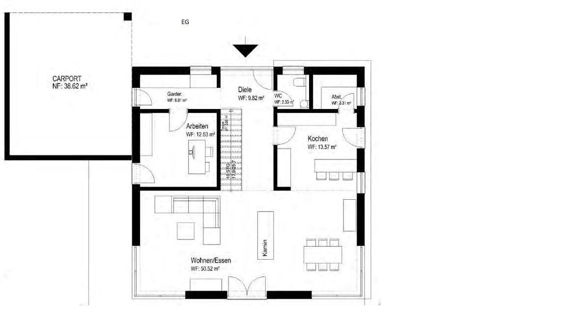

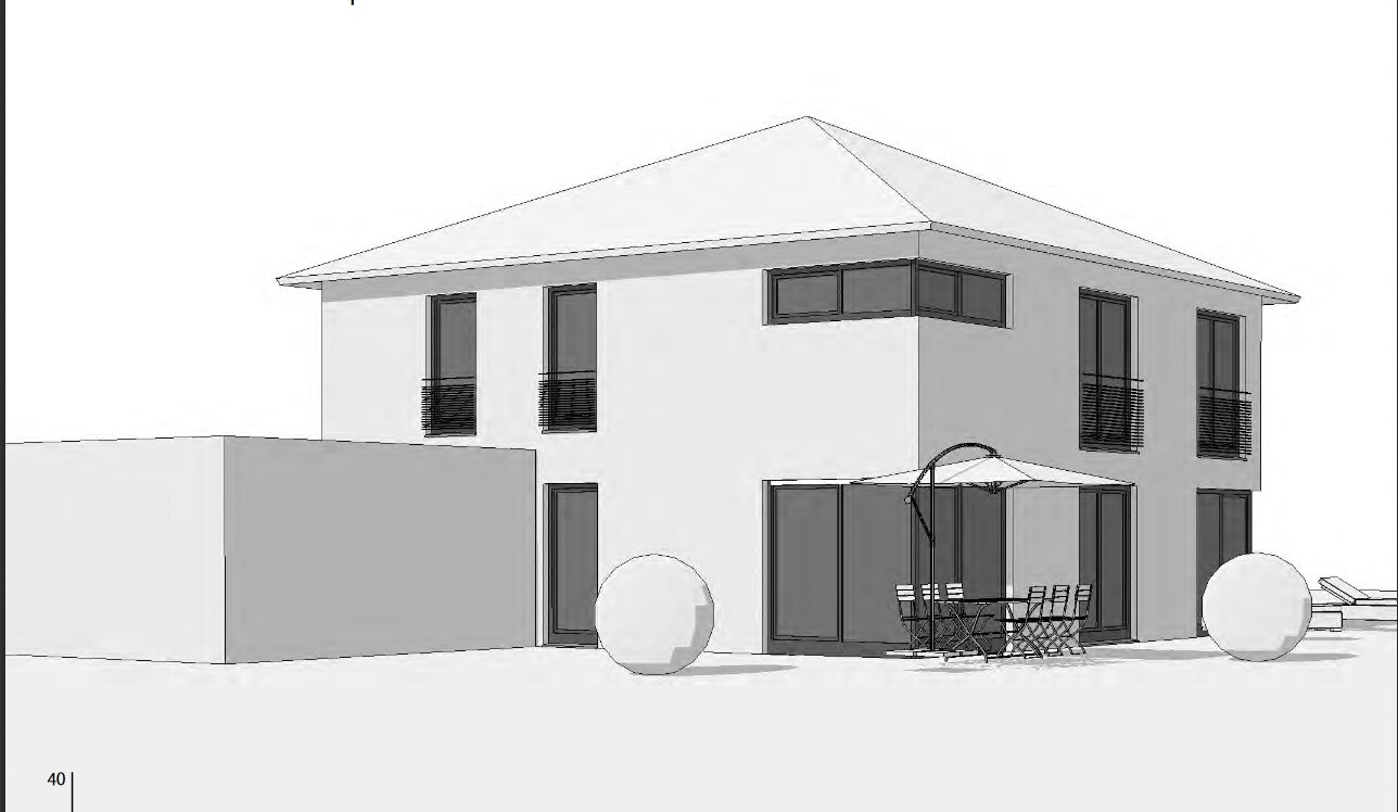

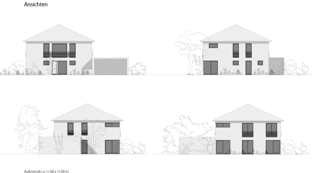

- We like this sample plan (see attachment). What do you think of it? (The attic is not included, the room layout fits well.)
I appreciate any useful comments .... (probably also a matter of taste)

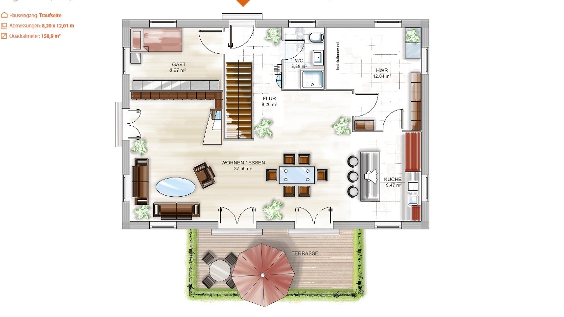

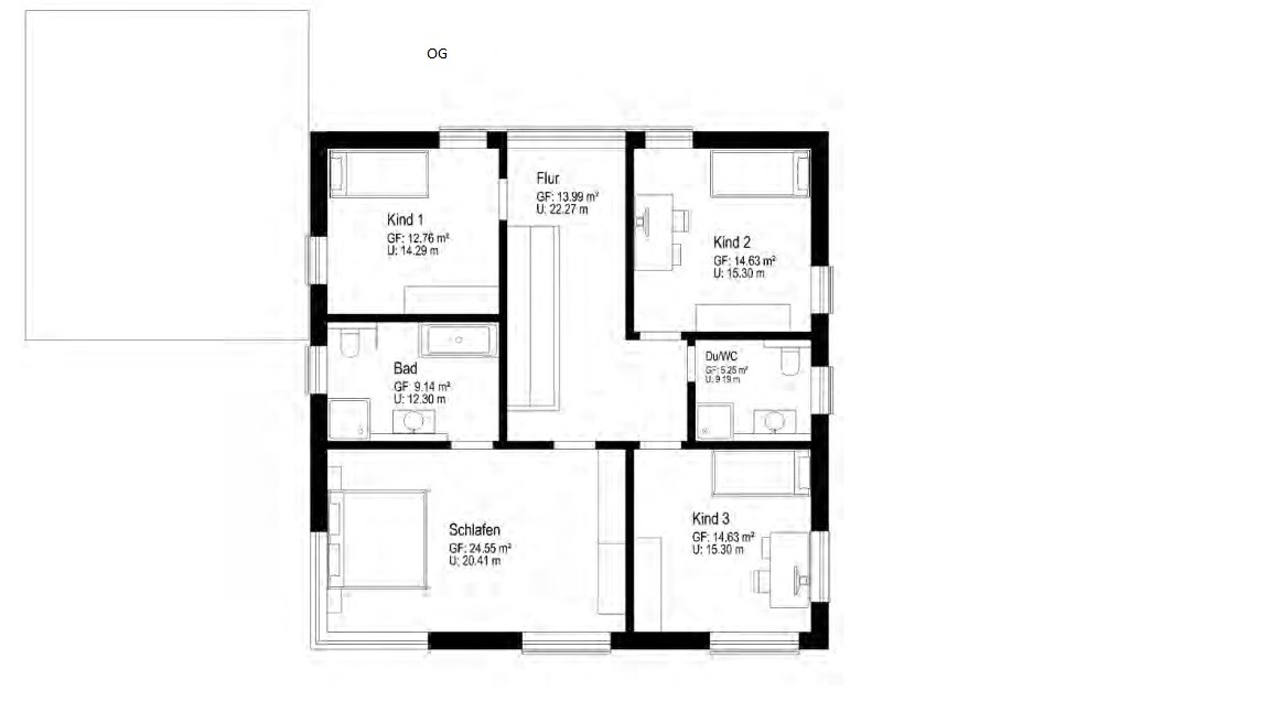

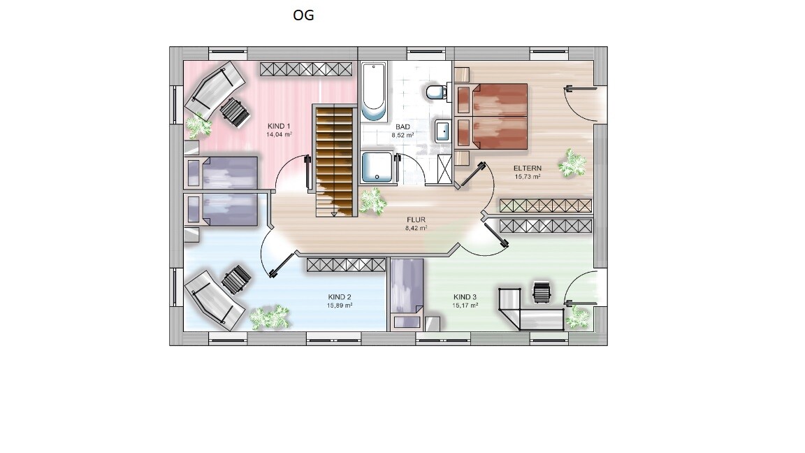

I’ve attached two floor plans that I like....
For the first floor plan, I would keep only one bathroom on the upper floor and remove the other one, but add a guest toilet with a shower downstairs.
The second floor plan looks fine at first glance.....
Does my approach make sense, and what do you think of the floor plans?!
