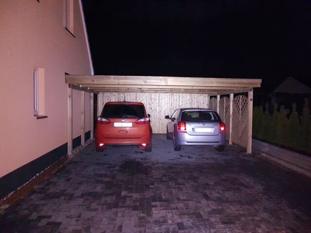

SteffenBank21 Mar 2018 06:59So basically, it’s possible for under 10,000 including installation, at least here in the north.
Last year, we bought a carport from Brüning-Carport and had it installed. It measures 6 x 9 meters (20 x 30 feet), with 6 x 3.5 meters (20 x 12 feet) used as a shed. The roof is made of trapezoidal sheets with anti-condensation fleece.
We paid just under 9,000.
SteffenBank schrieb:
Basically, it’s possible to get it done for under 10,000 including installation, at least here in the north.
We bought a carport from Brüning-Carport last year and had it installed. It’s 6 x 9 meters (20 x 30 feet), with 6 x 3.5 meters (20 x 11.5 feet) used as a storage room. The roof is made of trapezoidal sheets with anti-condensation fleece.
Thanks for the pictures. We’re planning the exact same dimensions with an equally sized storage room and originally intended to separate the storage area, but your approach looks much better. Do you see any downsides?
I could save myself a wall and an extra door, so thanks for the idea.
