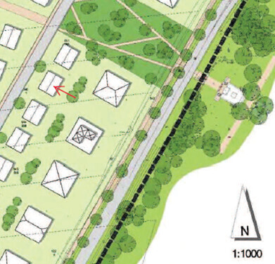

fortuneflake10 Aug 2017 10:04For exterior walls of residential buildings in building classes 1 and 2 with no more than three above-ground floors, a setback depth of 3 m (10 feet) is sufficient.
Only the 3 m (10 feet) applies, right?
The development plan specifies 3 m (10 feet) from the street.
Then we have 15 m (49 feet) available for construction.
The house is planned to be 10 x 13.5 m (33 x 44 feet).
The garage is 6 m (20 feet) wide, leaving 1 m (3 feet) between the house and garage.
There is space in front of the house for parking (4.5 m / 15 feet), then the house with 13.5 m (44 feet). 1.5 m (5 feet) + 13.5 m (44 feet) fits within the building boundary of 15 m (49 feet).
That was roughly our plan.
This concerns the plot marked with the arrow.
