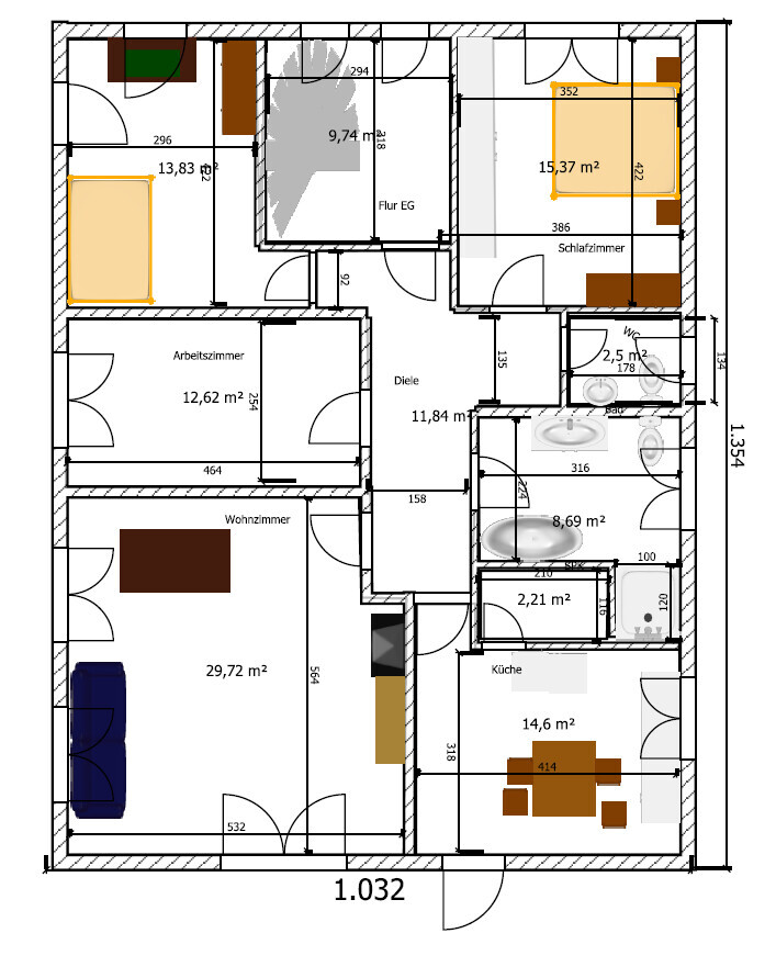

we are currently planning a two-family house with one apartment on the ground floor and one apartment in the attic.
What do you think of our design?
Our thoughts were as follows:
- rectangular house with a pitched roof and two full floors
- plot only 20 meters (66 feet) wide, double garage must fit next to it (approx. 6 x 7 m (20 x 23 feet))
- house dimensions 9.5 m x 13 m (31 x 43 feet)
- utility room planned at the front, facing the street, for shorter piping runs
- entrance at the front or not far from the garage, possibly with a canopy later
- double garage (prefabricated, not solid masonry) on the property line, leaving a 1.5 m (5 feet) walkway between house and garage
- no basement for cost reasons
I still need to upload the ground floor plan.
Does our planning make sense?

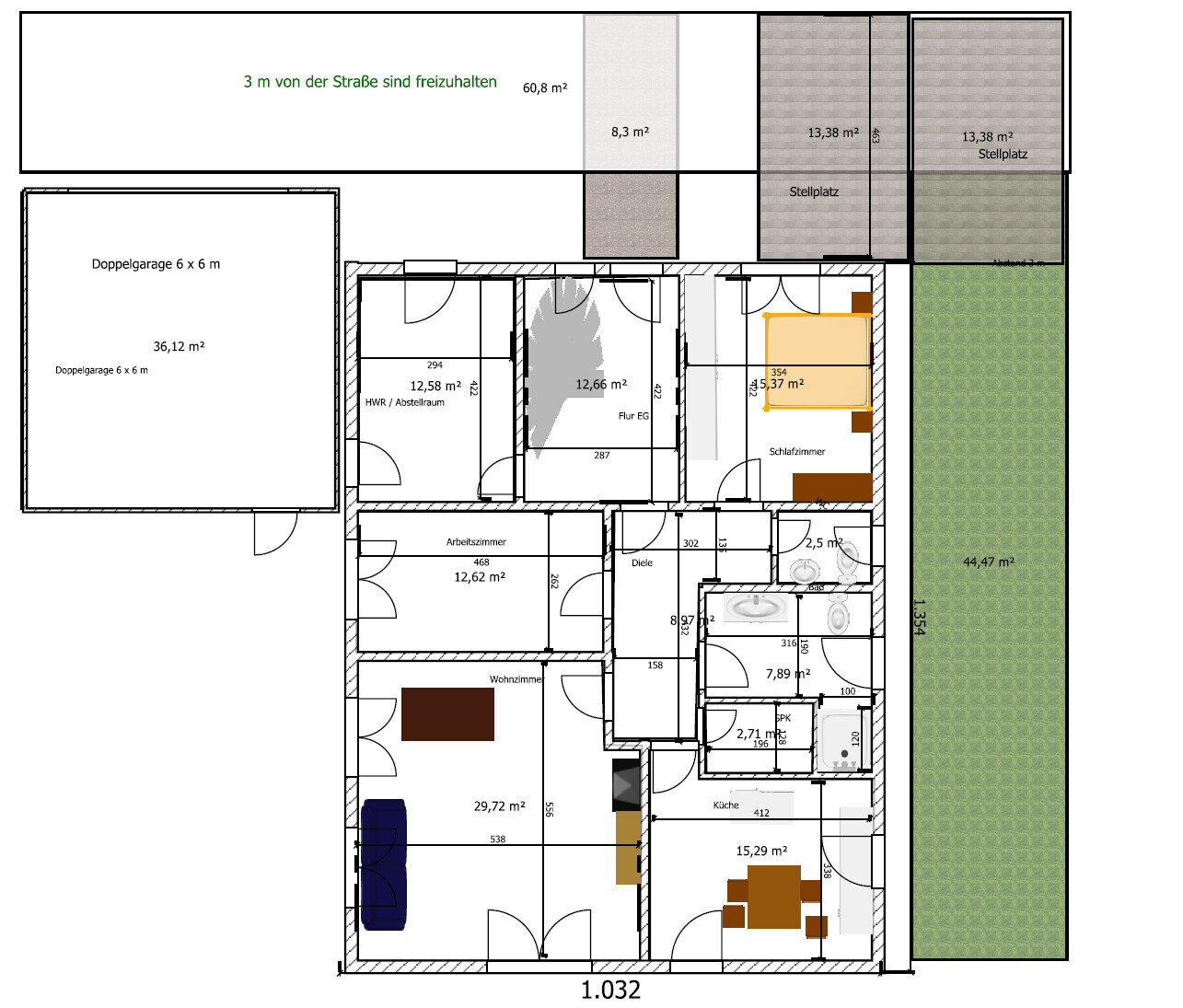

kbt09 schrieb:
Just add a north arrow to the drawing, then you don’t always have to look for the information in the text. 😉North arrows are there – but each time they point in a different direction. 🙂F
