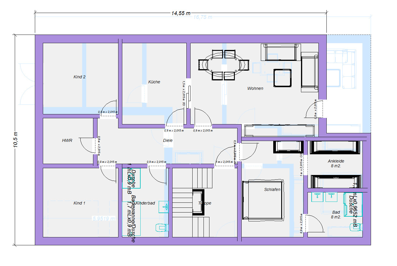

we are currently planning a two-family house with one apartment on the ground floor and one apartment in the attic.
What do you think of our design?
Our thoughts were as follows:
- rectangular house with a pitched roof and two full floors
- plot only 20 meters (66 feet) wide, double garage must fit next to it (approx. 6 x 7 m (20 x 23 feet))
- house dimensions 9.5 m x 13 m (31 x 43 feet)
- utility room planned at the front, facing the street, for shorter piping runs
- entrance at the front or not far from the garage, possibly with a canopy later
- double garage (prefabricated, not solid masonry) on the property line, leaving a 1.5 m (5 feet) walkway between house and garage
- no basement for cost reasons
I still need to upload the ground floor plan.
Does our planning make sense?

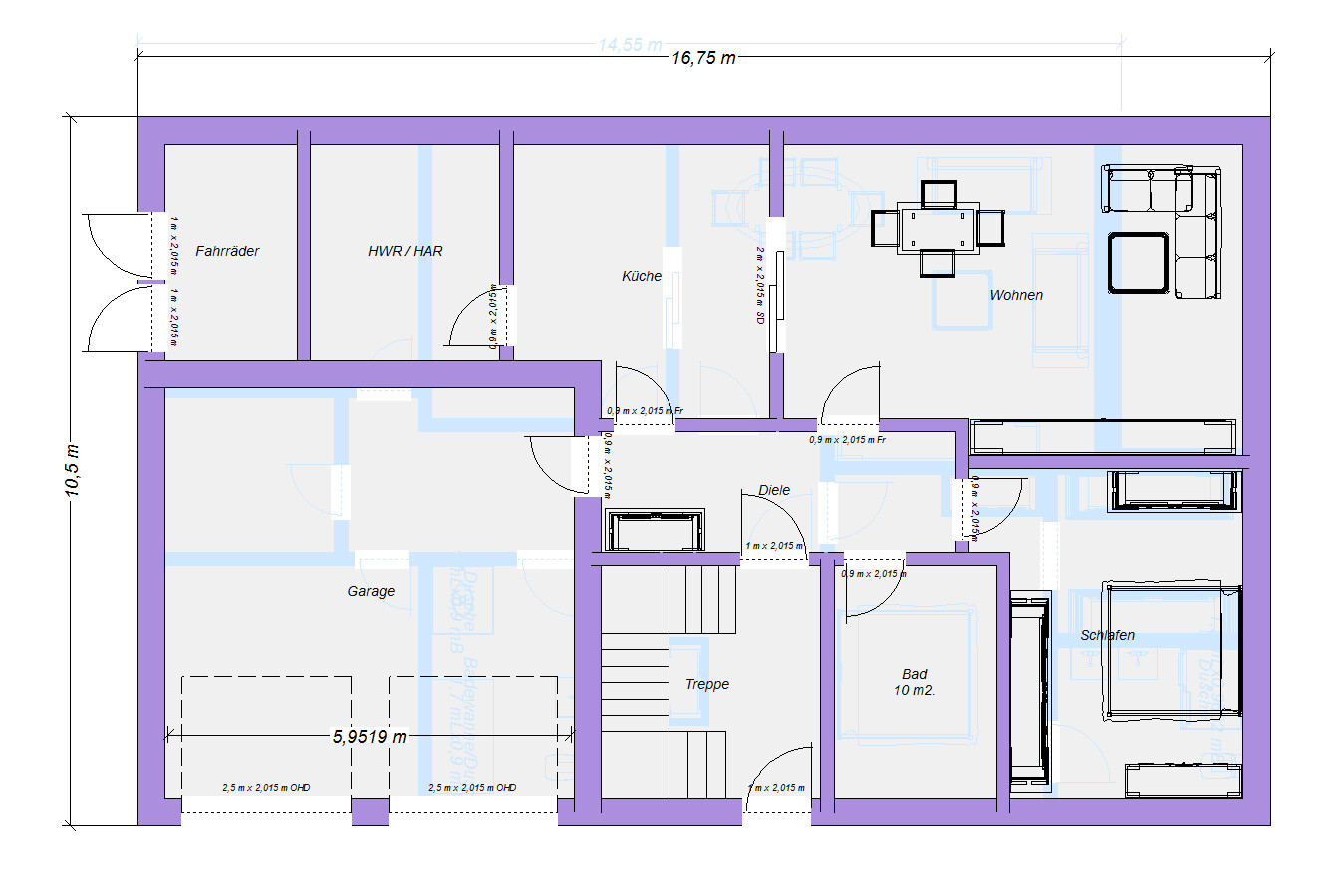

Yes, the ground floor should be as barrier-free as possible, and less space is needed downstairs than upstairs. That’s the dilemma. For me, that would be a reason to consider attaching the garage to the house and building over it upstairs. That could solve the problem. I would recommend a soundproof ceiling anyway because of the kids’ bouncy castles on the upper floor.
Attached is a sketch of what something like that could look like. So far, I haven’t managed to fit a guest WC on the ground floor. Guests have to share the main bathroom. 😀
Okay, upstairs the door clashes with the bedroom door. There are still a few minor issues like that.
The big question is the budget. Who pays for what here? 🙂
kaho674 schrieb:
For me, that would be a reason to consider attaching the garage to the house and building over it. That could solve the problem. I would recommend a soundproof ceiling anyway because of children's bouncy castles upstairs.
Here is a rough sketch of what something like that could look like. So far, I haven’t managed to fit a guest toilet on the ground floor. Guests will have to use the bathroom. 😀
Okay, upstairs the door swings right in front of the bedroom door. There are still a few flaws like that.
