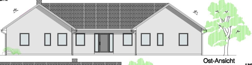

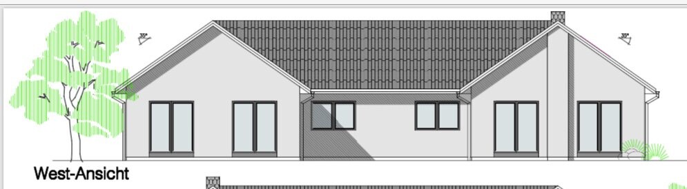

our bungalow is about 95% fully planned. I would like to ask for your opinions on the shapes and sizes of the windows (east elevation).
I want a modern look but I’m a bit unsure.
My architect suggests choosing tall rather than wide windows, as that looks better.
Behind the small windows
hides a small WC.
By the way: perfect symmetry is very important to us.
We don’t want any windows in the gable at the top because we like solid masonry gables.
The patio doors are 201 x 235 cm (79 x 93 inches) in height. This is the maximum height available in colored versions. The manufacturer does not guarantee anything higher.
The front windows are now 1.55 m (5 feet) in height.
Oh, and our bedroom is located on the south side.
Overall, we like everything, but we are unsure about the front (east side).

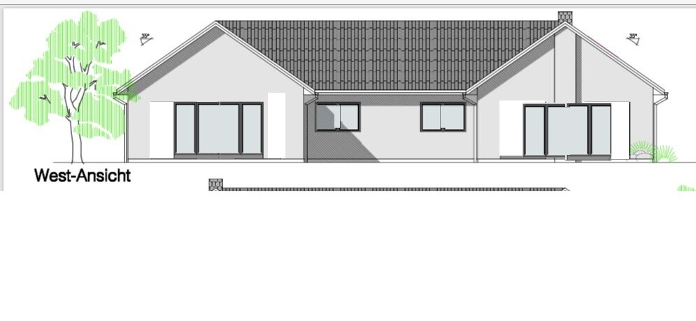

Mastermind17 May 2018 14:00Regardless of the chimney, I would suggest an inviting window element. How it is divided into fixed glazing and door is a matter of taste.
Simply enlarging (widening) it immediately creates a more modern look for the otherwise bland east/west façade. I would avoid splitting the small middle windows down the center.
Personally, I don’t like the look on the side with the large front door at all. It’s a very outdated design. Since I don’t know the rooms behind, it’s difficult to propose alternatives. And since the façade will apparently be brickwork, it’s hard to say—maybe just add a nice rhombus cladding on top. That would enhance the whole appearance (if you don’t want windows there). But with brick?
Here’s an idea for the west elevation.
P.S. I would give up perfect symmetry to achieve a more modern look. Otherwise, it will end up looking like the mentioned military officers’ mess.

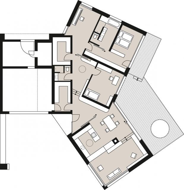

I would arrange the ensemble in a star shape, mainly to break up this— in my opinion— yawn-inducing and terrible 26 m (85 feet) house facade. Conceptually something like this, but probably too innovative:
Source + suggested search:
Schöner Wohnen – Family bungalow with airy floor plan
As mentioned, this tip is not new...
The original is not a multi-family house either, but the garage as wing 3 could be adapted according to individual preference.
