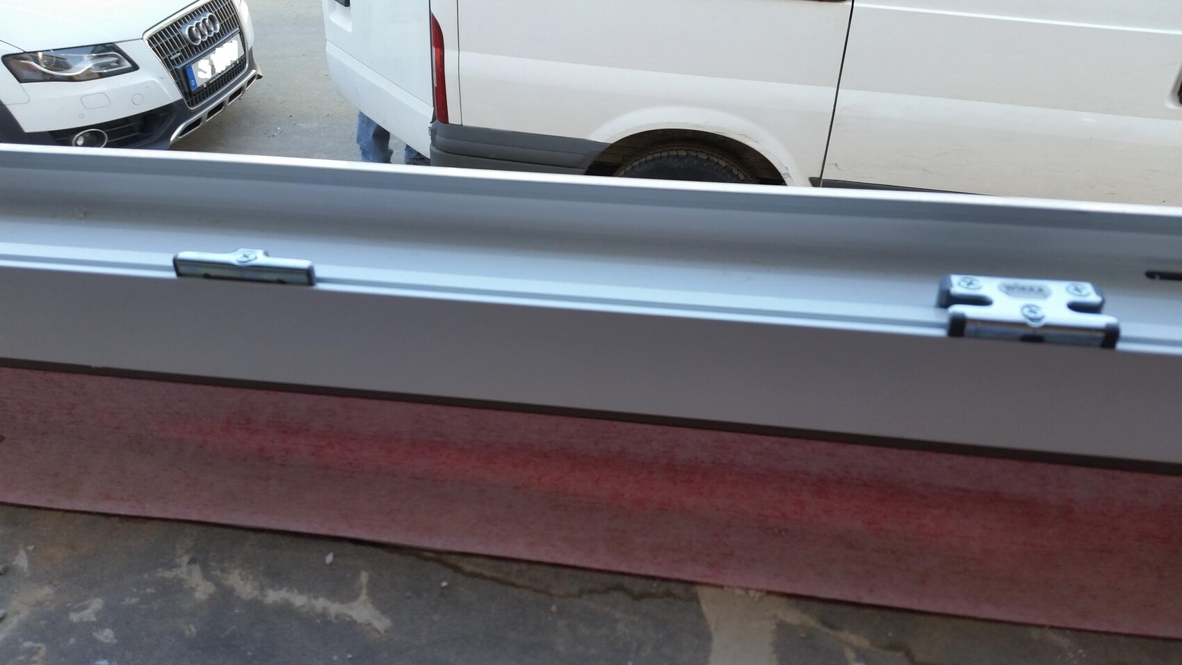

It depends on what was ordered. The hardware on the right is designed for the mushroom cams. The one on the left is just a guide to pull the window closed.
In the standard version, there are usually 4 mushroom cams, while the rest are “regular” locking pins and rollers.
Mushroom cams have manufacturing-related rebate clearance tolerances. If only mushroom cams were used, the hardware would wear out quickly and the window would be very difficult to open.
I originally only ordered 2 mushroom head locks per window. That’s why I’m surprised that so many mushroom heads were installed on almost all the windows.
I. Does having many mushroom head locks as a result make the window harder to close?
II. Can you improve burglary resistance simply by replacing the left hardware with one like the one shown on the right in the picture?
Thank you in advance.

Mushroom head locking bolts are generally installed in the sash. In the past, standard sliding bolts were used for regular windows, while mushroom head locks were used for windows with security requirements. This is no longer done today for the sake of standardization.
Standard strike plates and security strike plates are installed in the frame (see photo). The front two mushroom heads shift to the left or right depending on whether the sash is tilted or closed. This means that one of the bolts engages the security strike plate from the side. The rotational position is in the middle—no mushroom head is engaged in the security strike plate. Due to the shape of the mushroom head, it cannot or can only hardly be pried out of the security strike plate. However, it can be pried out relatively easily from the locked standard strike plate.
You probably have another security strike plate further up or at the top front on the handle side. Everything on your windows is in order and as it should be.
Yes, the more security strike plates instead of standard strike plates, the greater the protection against burglary. However, the required force to operate the window increases slightly due to the friction. The mushroom bolts installed in your window are movable to compensate for any sash clearance tolerances.
